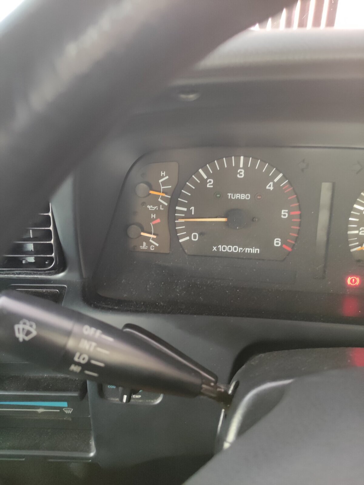

What I noticed is the temperature gauge sits very low, barely 1/4 and quickly drops to cold when driving at higher speeds such as highway. (See attached photo) I have check the ground at the sender and it pegs all the way to hot when grounded. Battery terminals are also brand new. I also tighten and check for corrosion for the ground screw nuts behind the gauge and they are tight.

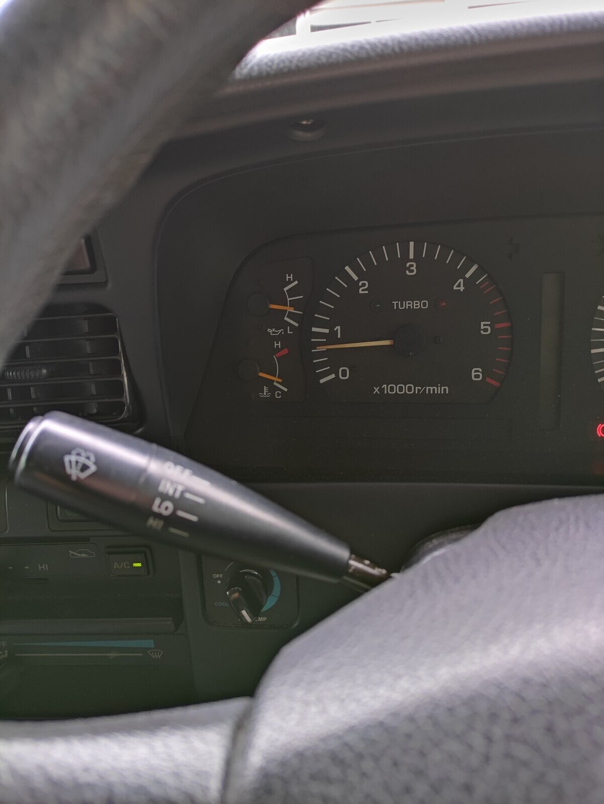

So I went to an automotive electrical shop expert and they said it is the the thermostat opening too early which explains the drop the temperature at higher speeds. So I put in a oem toyota thermostat with the same size and diameter which is rated at 82c. (90916-03100) which starts opening at 82c and fully open at 95c. After I change the thermostat to the 82c the temperature sits at 1/3 and does not drop at higher speeds anymore. (See attached photo)
I know the oem temperature is by no means the most accurate gauge but I could use some insights and opinions on this. I would really appreciate it if any of you with a 1hz show me where your gauge sit when fully warmup and what thermostat are u using. This vehicle is operated in a tropical climate with 32-35c ambient temp during the day and 24-29c during the night. Thanks! PS. The rpm gauge is sourced from a 1hdt because my old one is broken.
