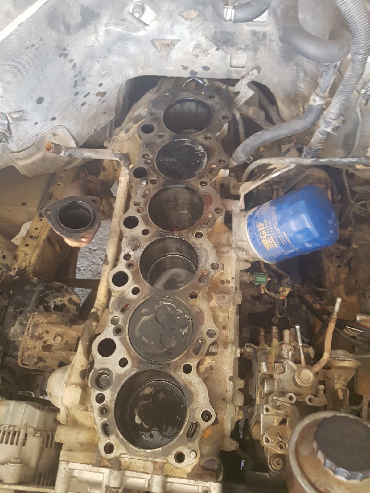

7 months ago I changed all the cylinder head components (valves, seals, shims, etc...) due to multiple unsuccessful valves adjustment (found out that the valves were soldered on top by the previous owner to add height).
long story short, I replaced a new original Toyota radiator recently and installed a new thermostat and voila, the engine started to buildup high pressure on the coolant hoses and overheated twice (didn't reach the red mark on the dash).
After that, I removed the thermostat, changed the water pump, replaced the radiator cap, no luck, still overheating and building pressure, so it was time to check the cylinder head.

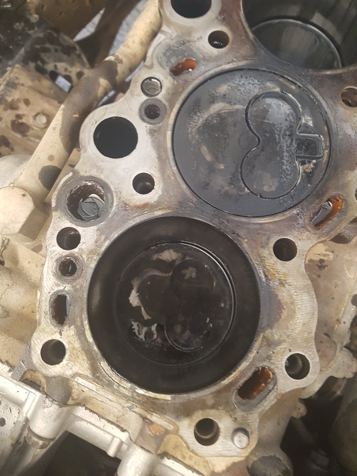

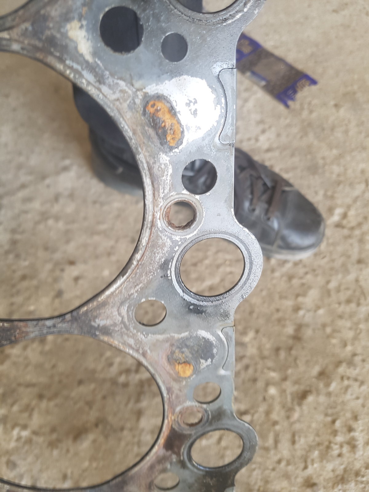

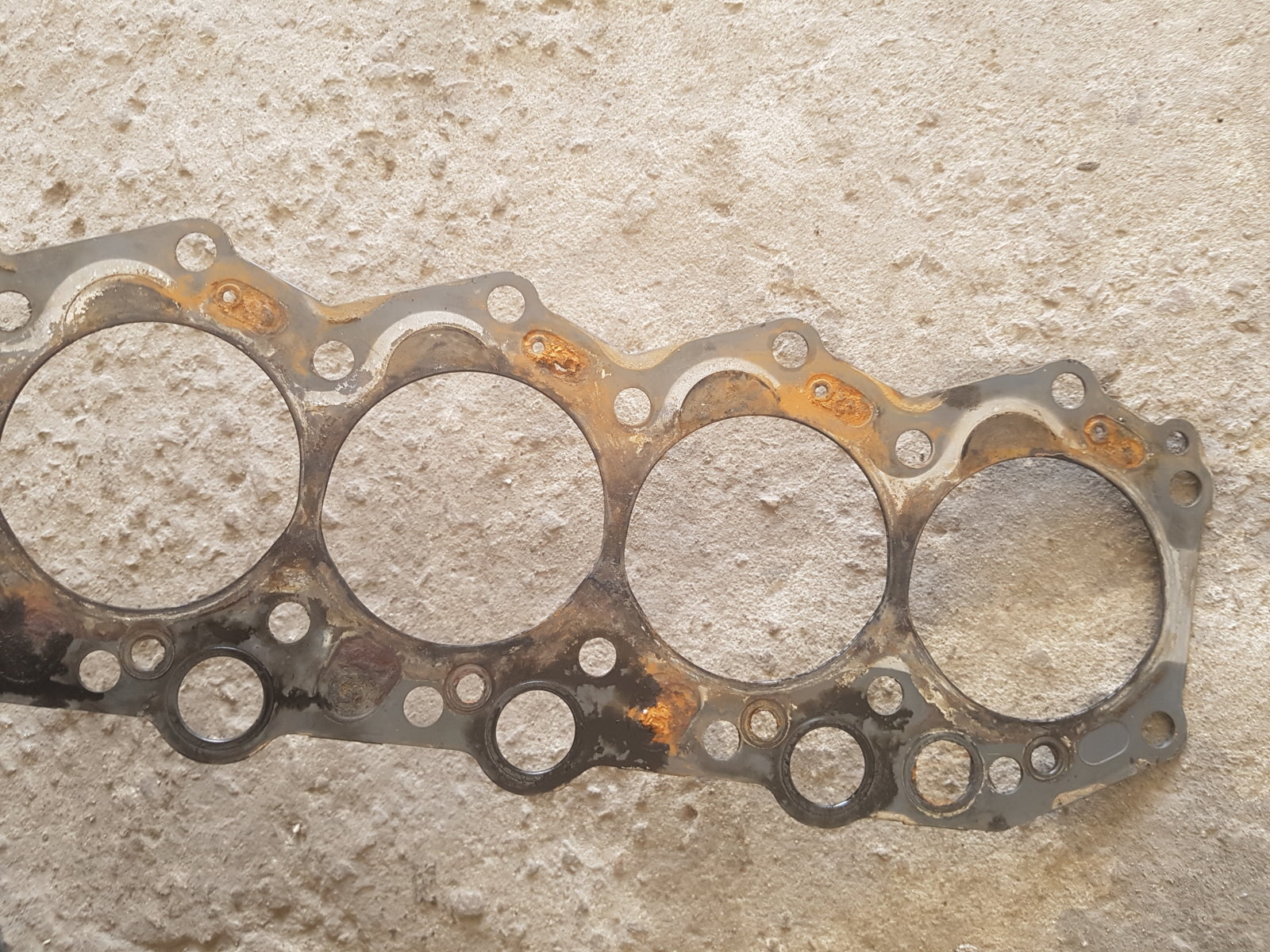

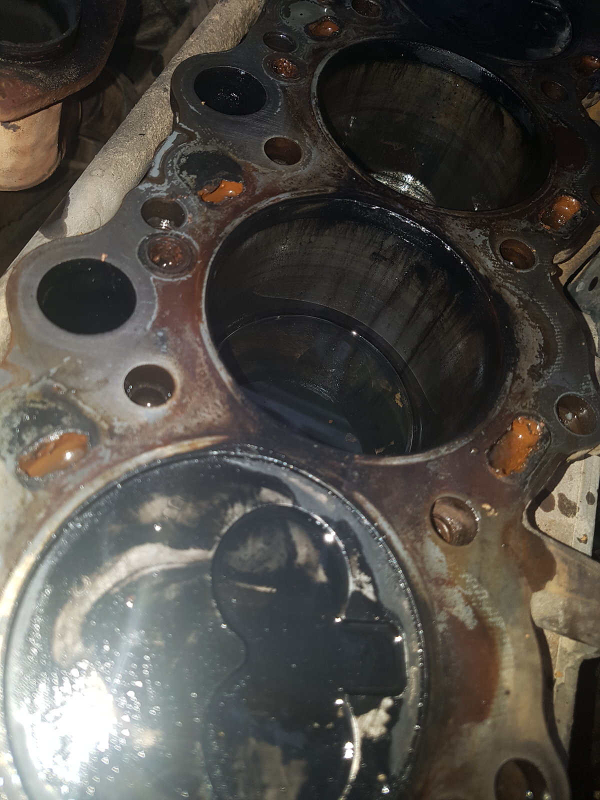

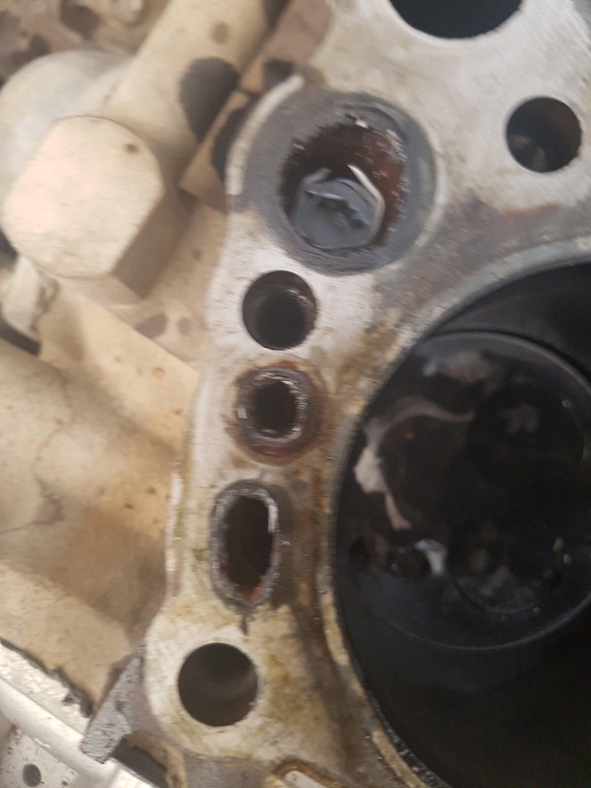

Today we disassembled the cylinder head and as you can see in the attached pictures, that the exhaust was leaking into the coolant passages, also, almost all coolant passages were clogged.
so here are my questions:
is it possible to resurface the same cylinder head and install it again?
is there any way to prevent rust in the blocks and coolant passages and how to remove it?
cheers for any advice thanks, ilyes
