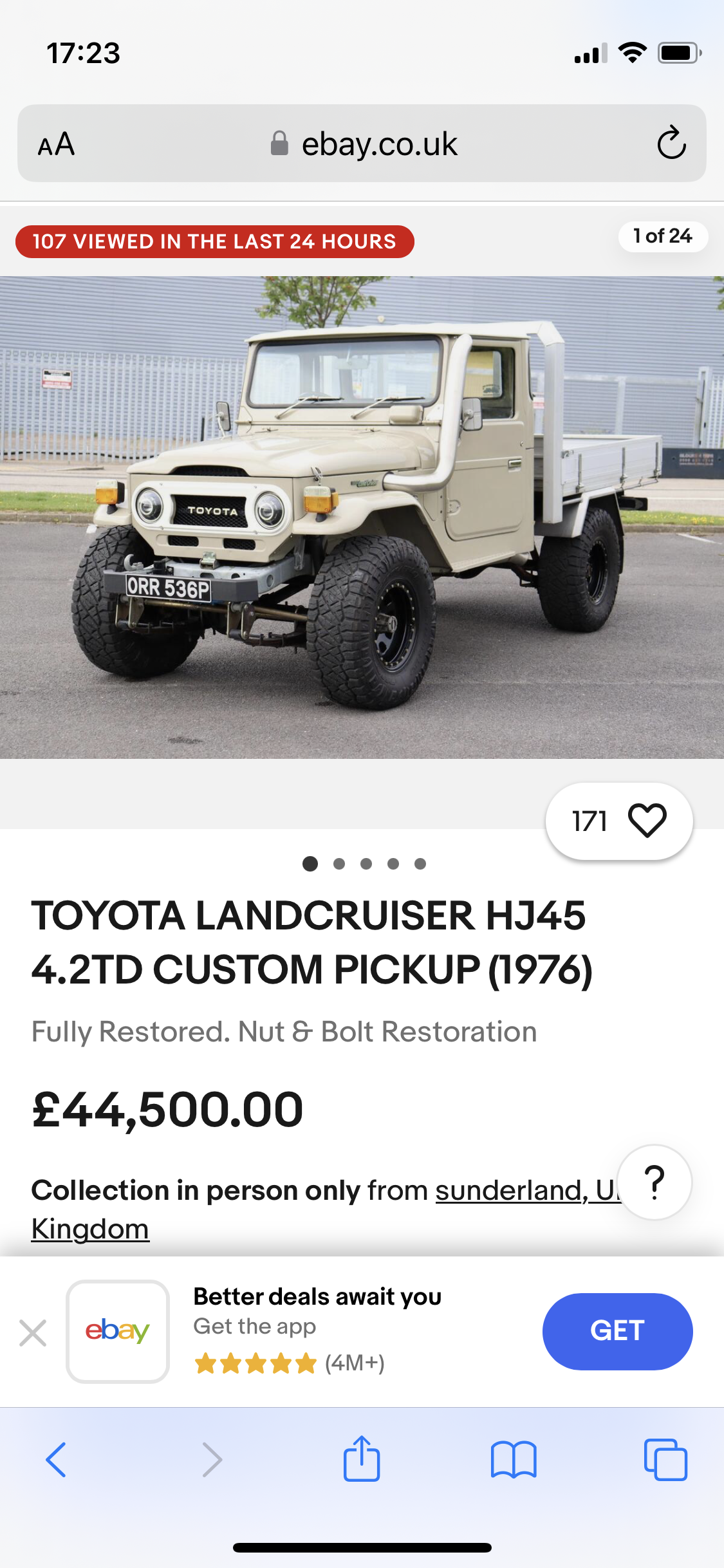

I assume you’ve seen this 45 on eBay. Expensive but rather lovely.

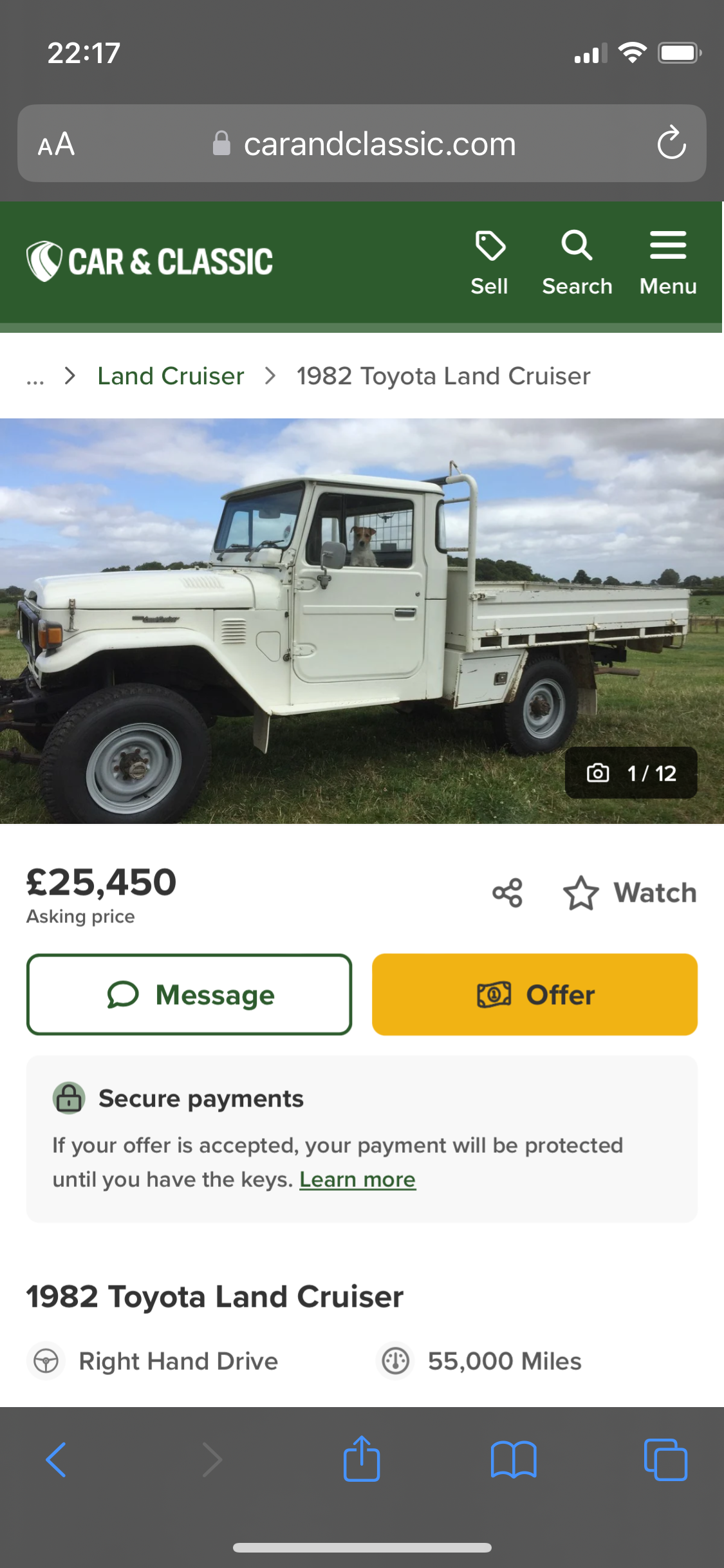

If you haven’t already seen it, there is one in Wetherby for sale, it’s a pick up and a diesel. On car and classic.
