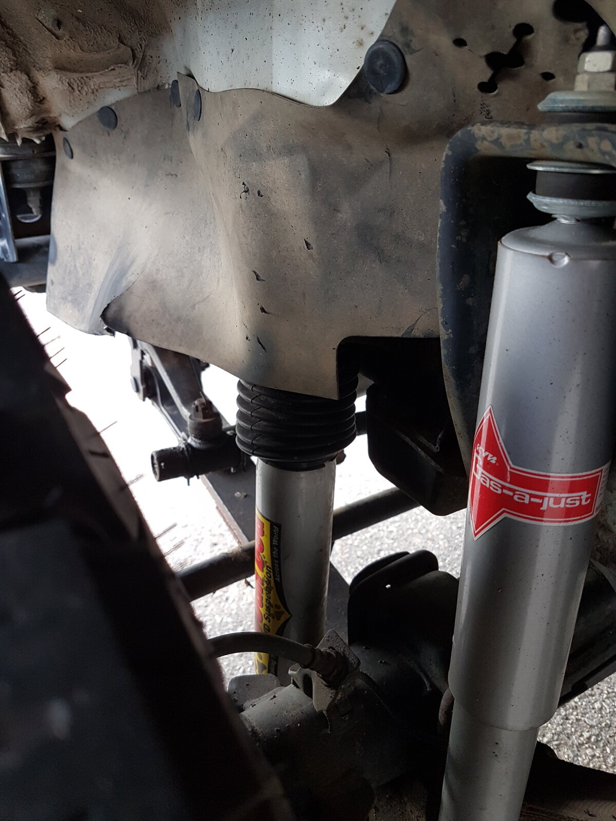

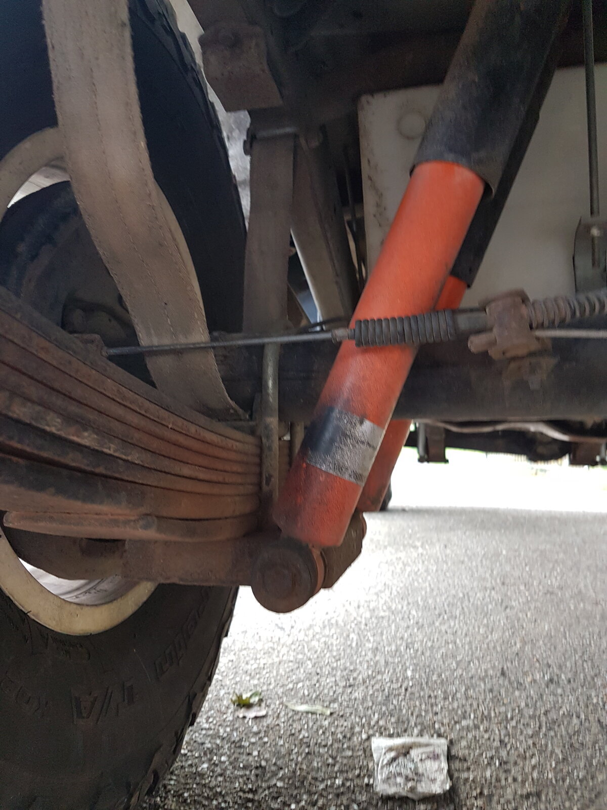

What suspension have I got? Yeah, sounds dumb, but from past experience what you`ve been told, assumed etc isn`t always accurate.
Is it standard springs or not? Is measuring from hub centre to mid point of wheel-arch a good indicator?
Yep, depends on vehicle weight etc, but how else is this done? Jack up the chassis so the springs are "no load"?
There are rubber spacers between body and chassis, about 40mm. I assume these are standard as the body only just clears the chassis in the arch.
On front, hub to arch top, 550mm. On rear, hub to arch 600mm.

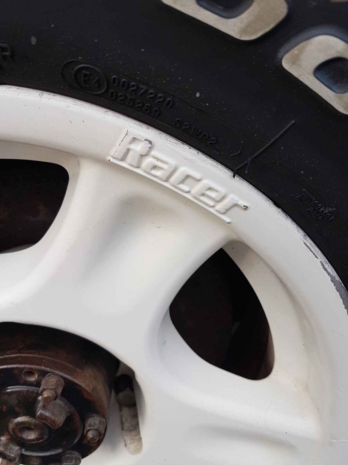

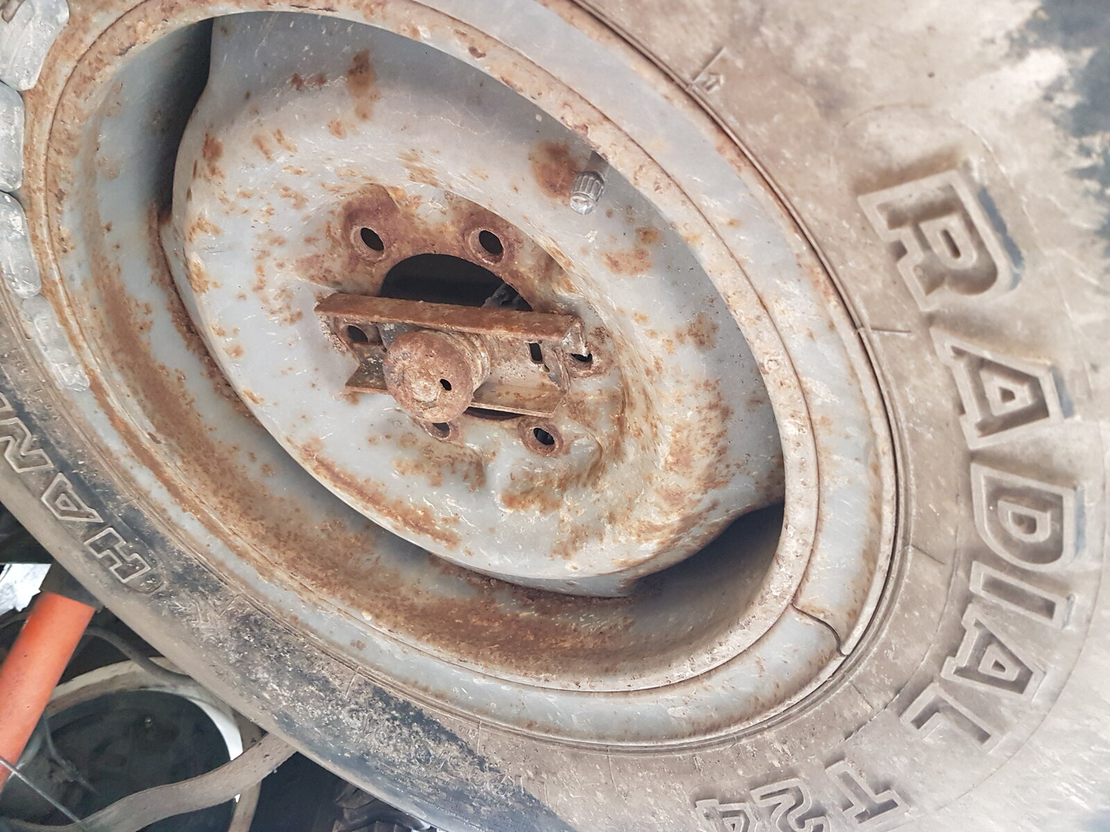

Four wheels are white alloy, the spare is under body mounted and a steel split rim, different sized tyre.
So, I`m looking for 1? 2? 4? whatever wheels similar to those fitted.
Following wheels, I reckon I`ll want to mount any new spare wheel(s) up out of the muck.

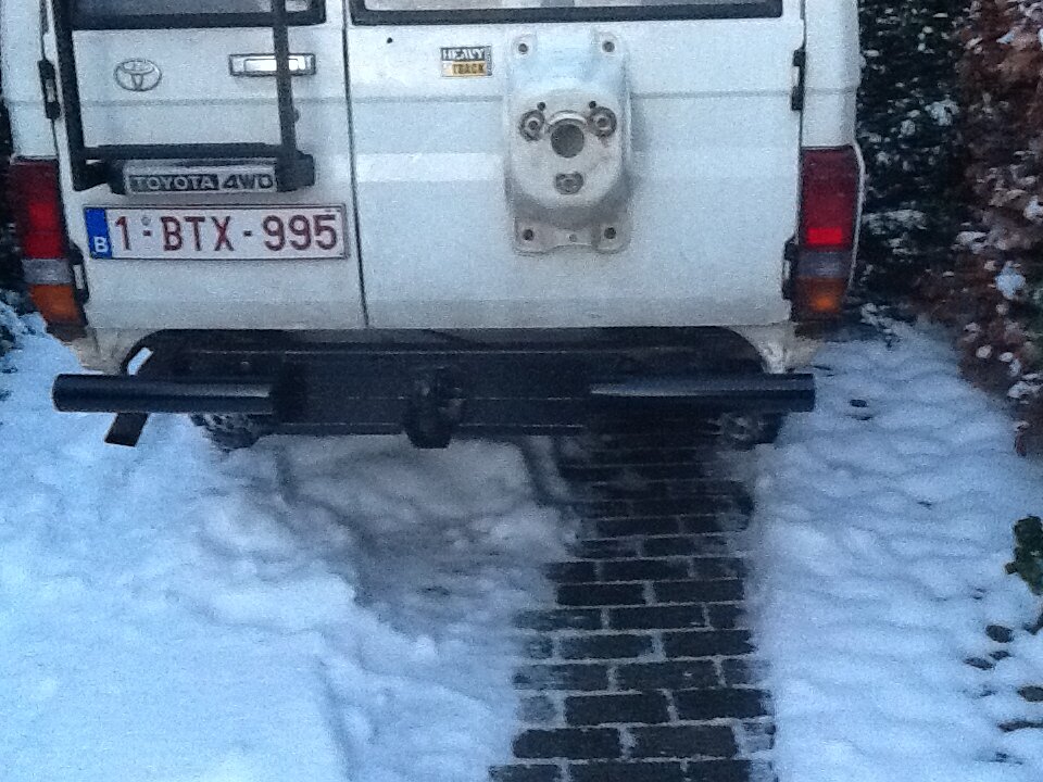

I`ve read a thread about rear door mounting. As I understand it the 75`s doors have no provision for mounting spare wheels, but the 76s and 78s do? And it is possible to fit a 76/78 door to a 75? (cutting off an extra loop).
I am probably up for a replacement bumper with swing outs, but they ain`t cheap, and not too easy to source. Would a bumper designed for a 76 or 78 fit?

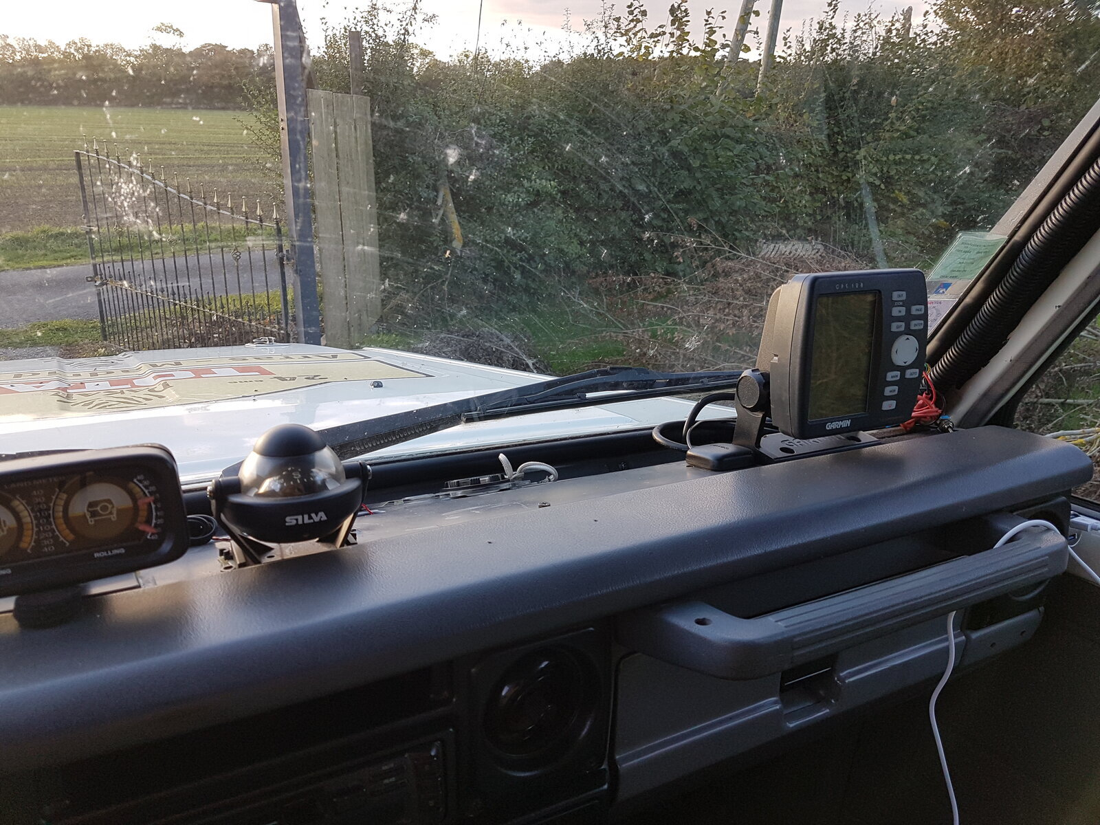

The vehicle has a "Silva" car compass fitted, but the fluid has party drained from it. Anyone got one for sale? Seen them at 80 quid on line but being a tight ole git that seems a lot to me.
Also has a Garmin 128 marine GPS fitted, but that seems dead. Be nice to have that period fitment working, but as I said, I`m a skinflint so am wary of chucking money about.

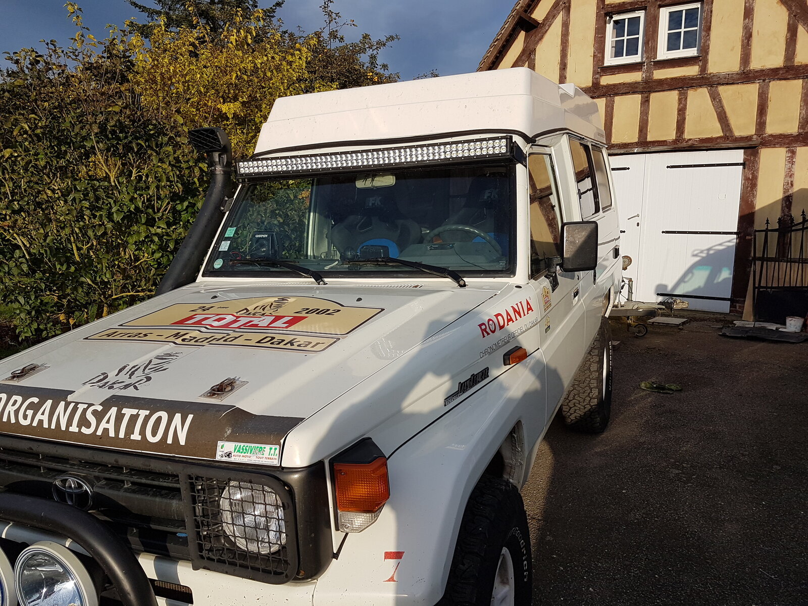

Which roof on your Troopy?
And a question about the awning please: Is that the 270deg one? How is it attached to body? Below the roof line I assume, and is it bolted through or with riv-nuts, and/or reinforcement plates or ??

The suspension is not stock. This has been built to handle Dakar support if the stickers are genuine so it has uprated suspension for dune bashing.. stock would have single shocks all round, you have doubles. There seems to me a mix of shocks on the front, Tough Dog are South African, no idea on the other. The red ones on the rear I don’t know, maybe Koni.
the white Alloys are common on Raid vehicles. Not sure where you’d source another. The OE wheels, as per your spare are only 6” so limited tyre options. (If you want a set with new tyres I’ll have some available shortly).
Ref Body I don’t think it is lifted but pictures not easy to tell. You’ll usually see distinct spacers if it is.
ref rear bumper the 76 is a different shape I think, less overhang than the Troopies.
ref compass and GPS. For a compass try a boat jumble you might get lucky. For the Garmin I wouldn’t waste your money with another old one, it most likely will go the same way. Mine died, not much use and cared for.., bought by a guy who rebuilds them and sells on eBay but he couldn’t fix it… seems the hardware just croaks on them eventually and they’re not much use today with the advances of tech. Again you might find one in a boat jumble. (Both are marine products)
Wheels are 'arcasting racer' = very good wheels, buy an extra one.
You can fit a 78 series reinforced rear door to hang the spare wheel. Had this on my 75 and is very solid. It survived overland trips to south africa and mongolia with only a change of hinges. Be sure to check the hinges as they wear out with the extra weight.
I guess the roof is from roycreations. They went bust a few years ago.

In this thread, you can see pictures of the spare wheel and the selfmade rear bumper : 'Goodbye cruiser (on the Pamir Highway.....)'

I`ve now put a new rear door on, with tyre mount, 76 Troopy spec.
New "Arcasting Racer" wheel sourced too. Yep, expensive, but a steel framed alloy, so fingers crossed that is a one-off purchase.
