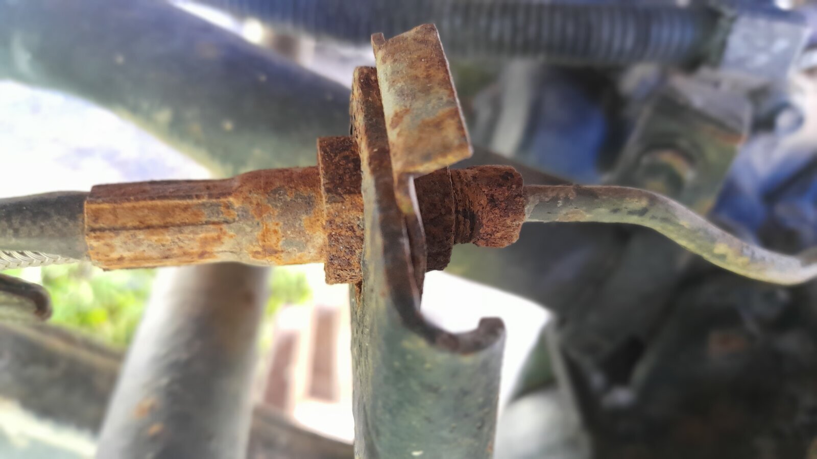

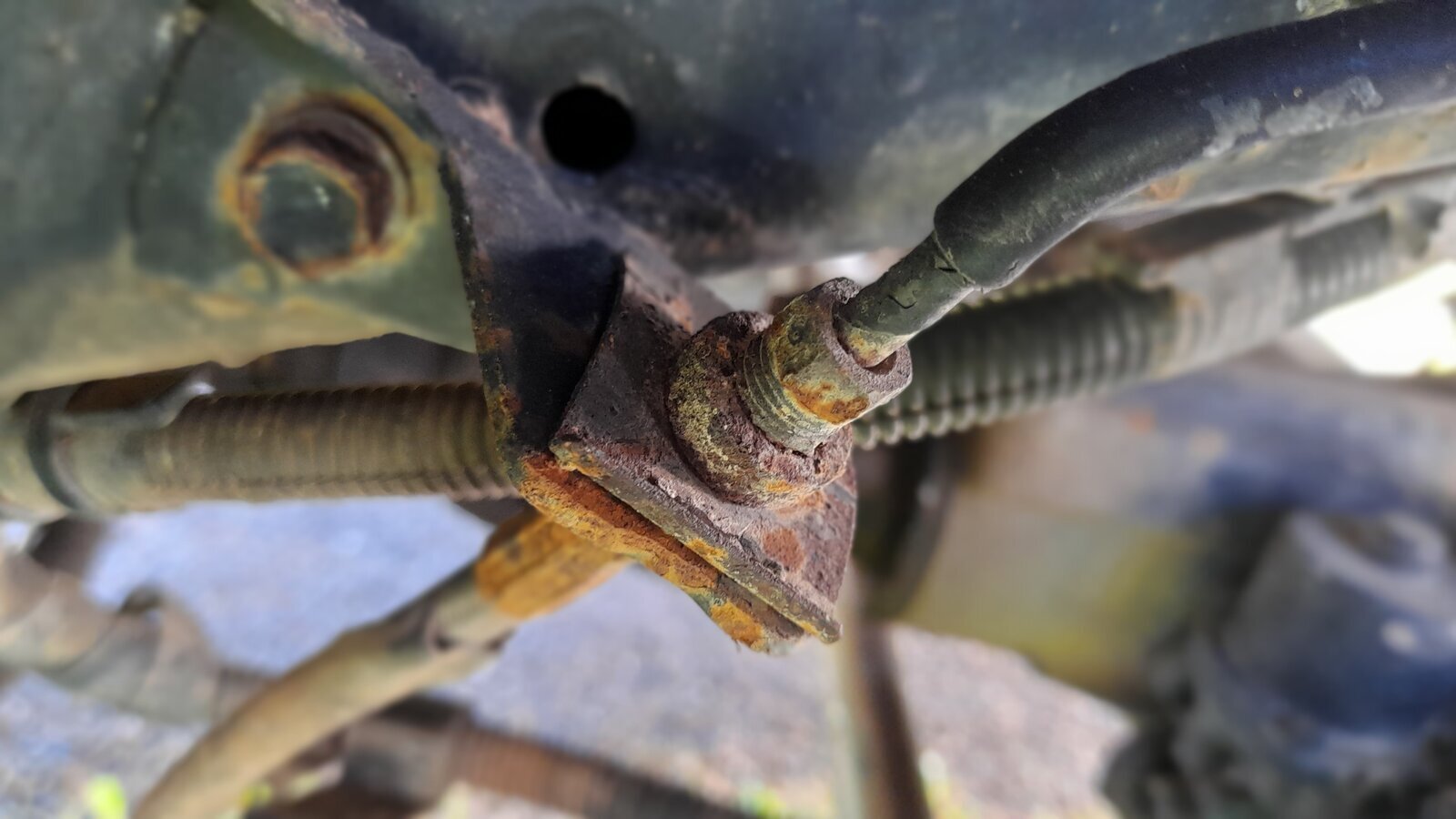

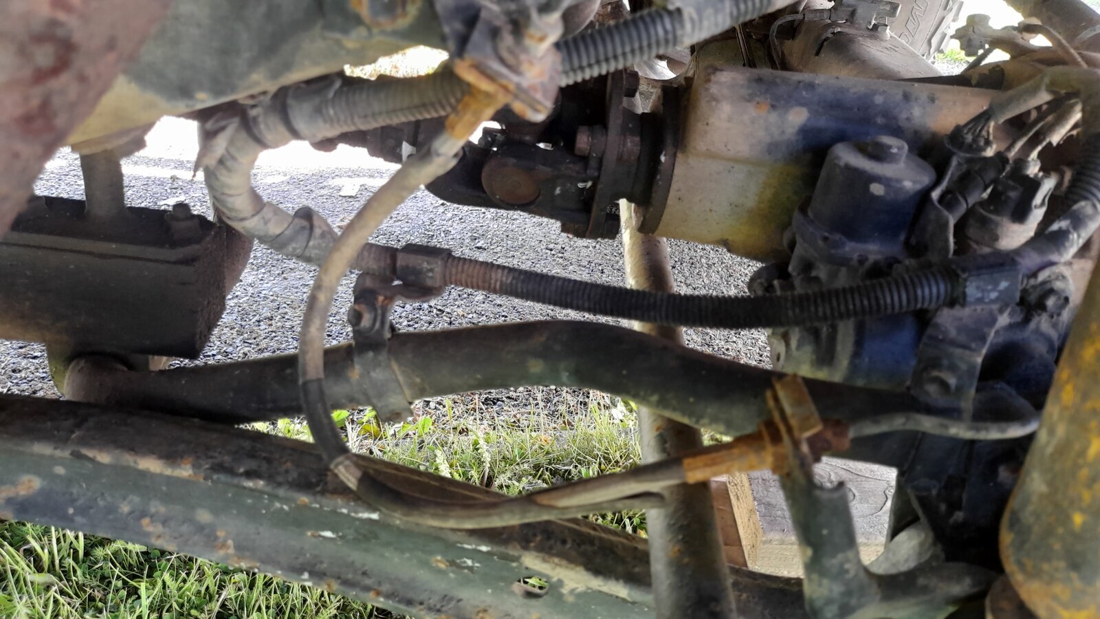

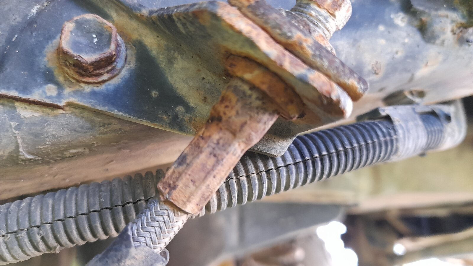

Just a quick question - can you drop a photo of this bit or what should be there - "the proper 'flange' connection to the body".
Cant quite picture what that is.
Here's some pictures

I have done some research on this as was considering an ABS and LSPV delete
Toyota brake lines are 4.75mm (3/16”) OD and the fittings have a M10x1.0 thread. The flare is "double flare" also called "inverted" flare.
