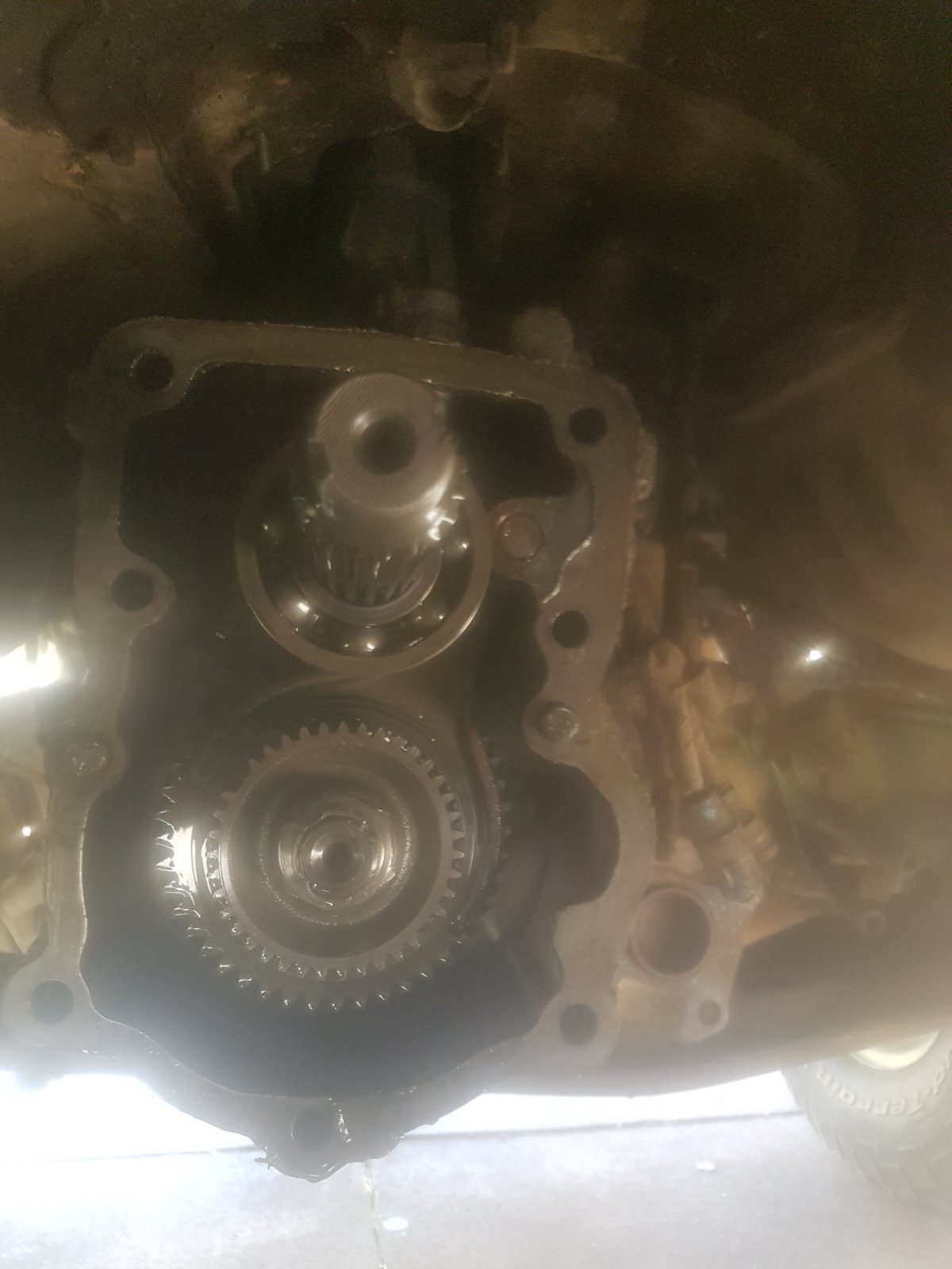

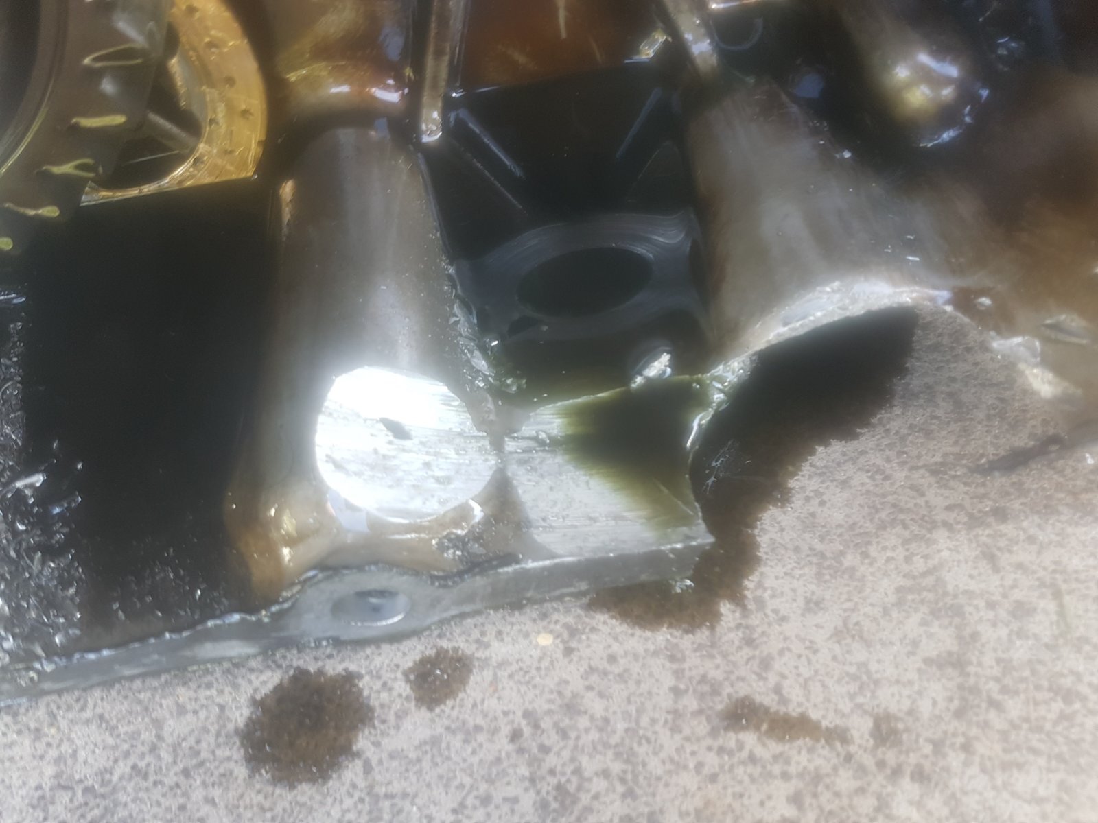

What happened was my idling shaft came out during a trip and the synchros kept spinning which ground a hole in the bottom of the back case.

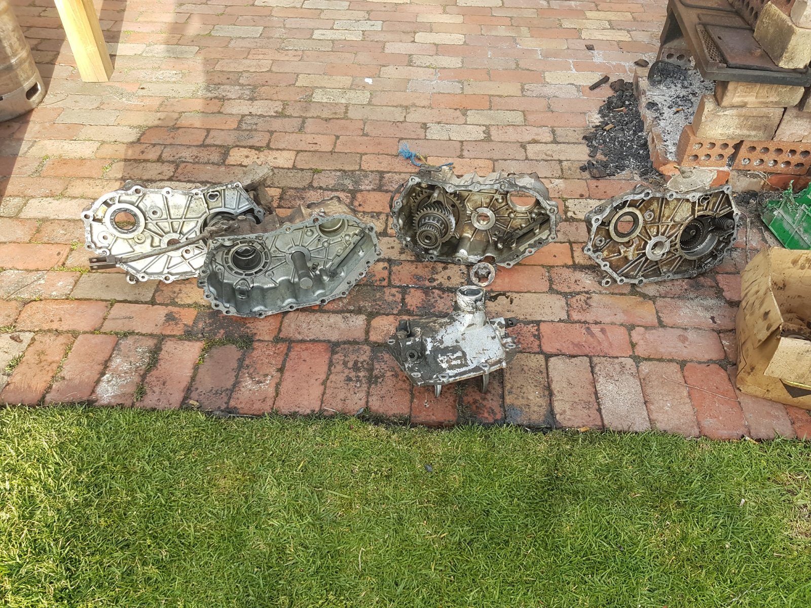

So I've split her from the 5th gear
Cleaned up the extra casing I happened to have, luckily from picking up a second box w transfer case and keeping it in the shed

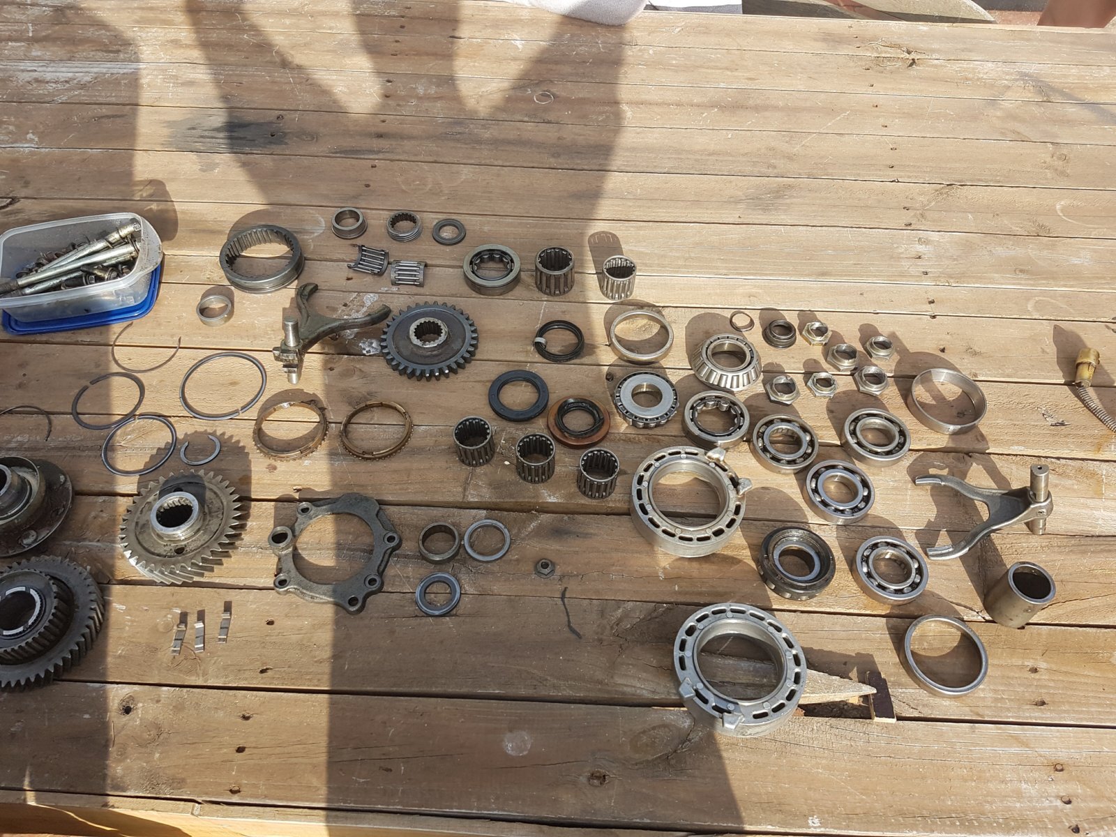

Cleaned and sorted out some spares

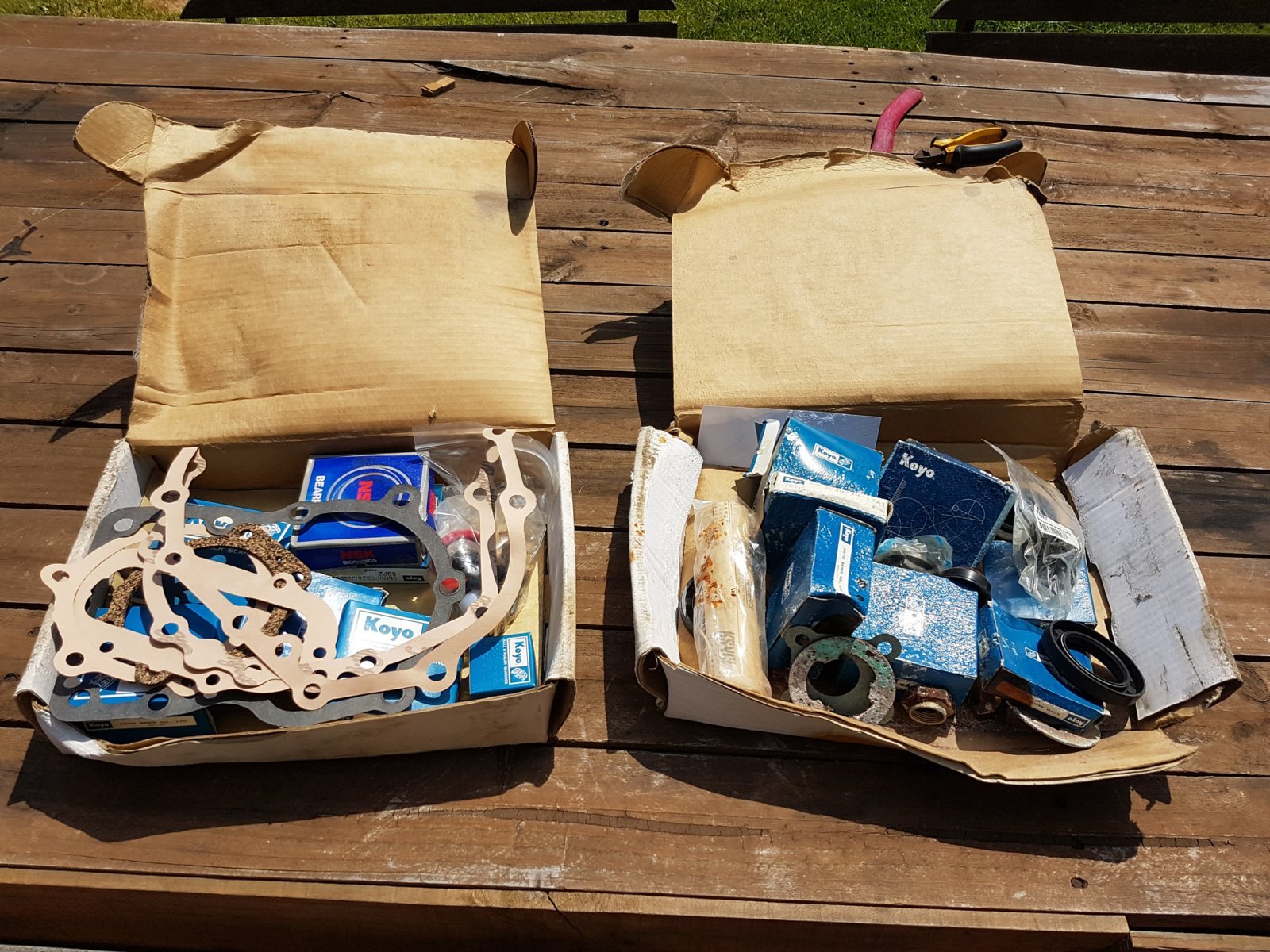

Found an original rebuild kit, still sealed (had to find a couple of new thrust washers which you can see have got a little weathered over 20 years)

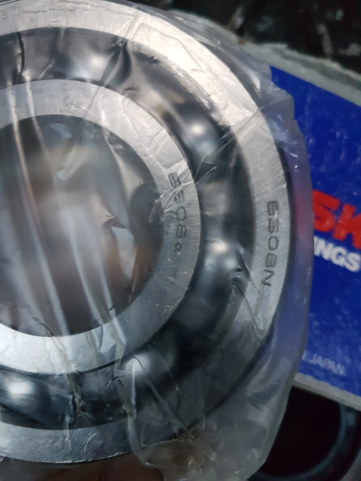

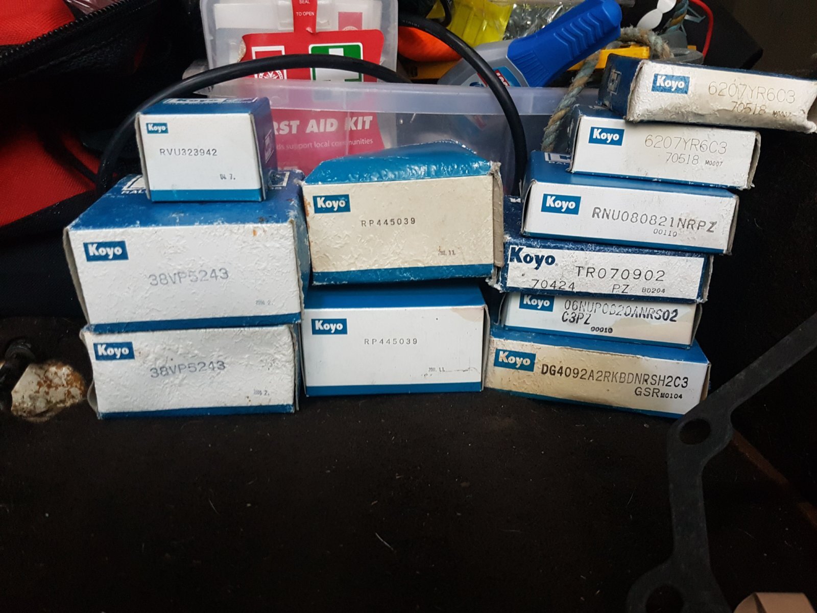

The existing bearings were aftermarket and the instructions I have do not mention any of the specific bearing numbers and they are so similar to each other it's near impossible to tell which will go where and I don't want to screw it up!
I managed to fit the easy to pick seals back in to the case but that's as far as I can go at the moment and I'm very keen to jump back in to it right away.
Here are my bearings with the non corresponding numbers...
