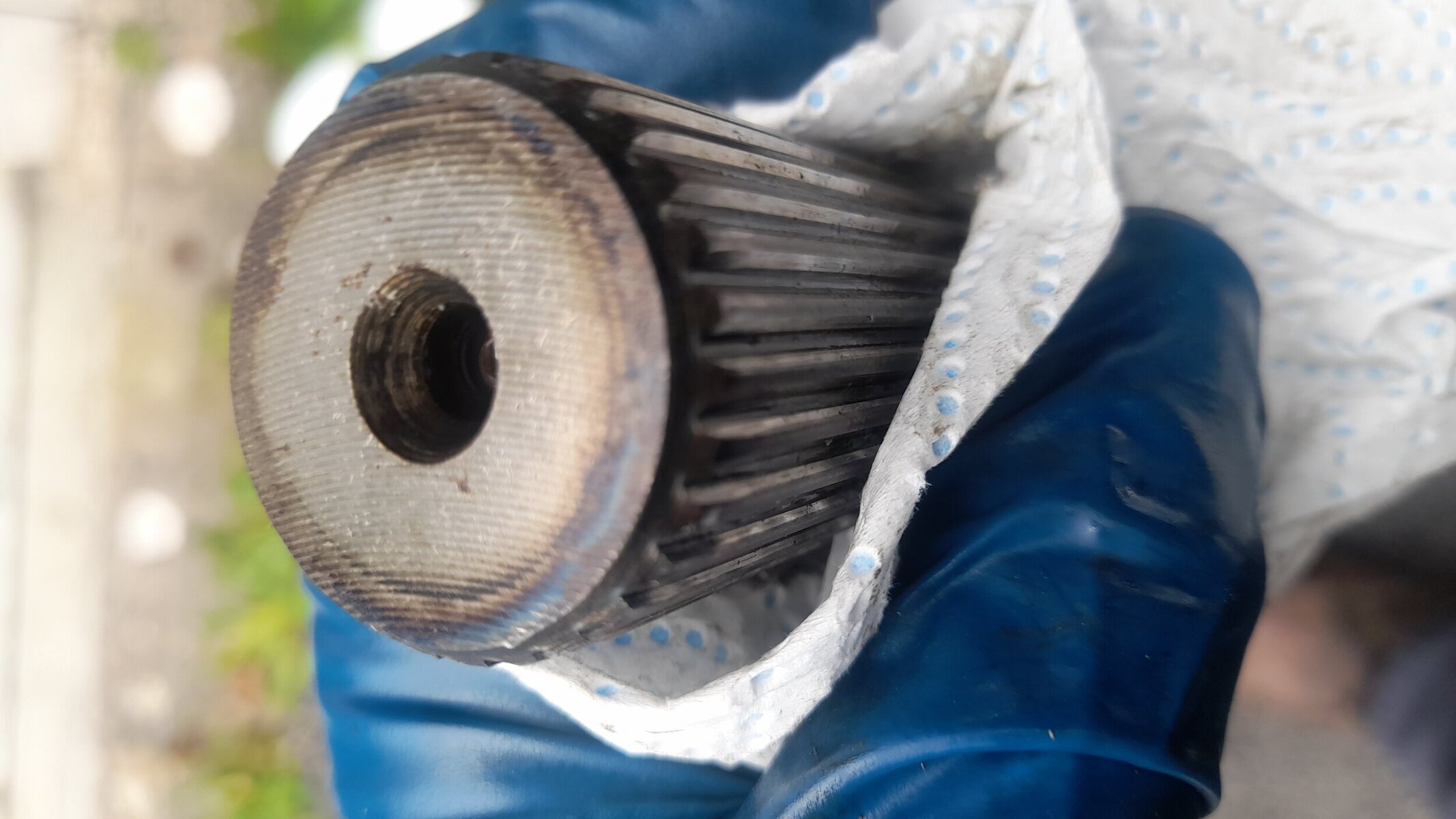

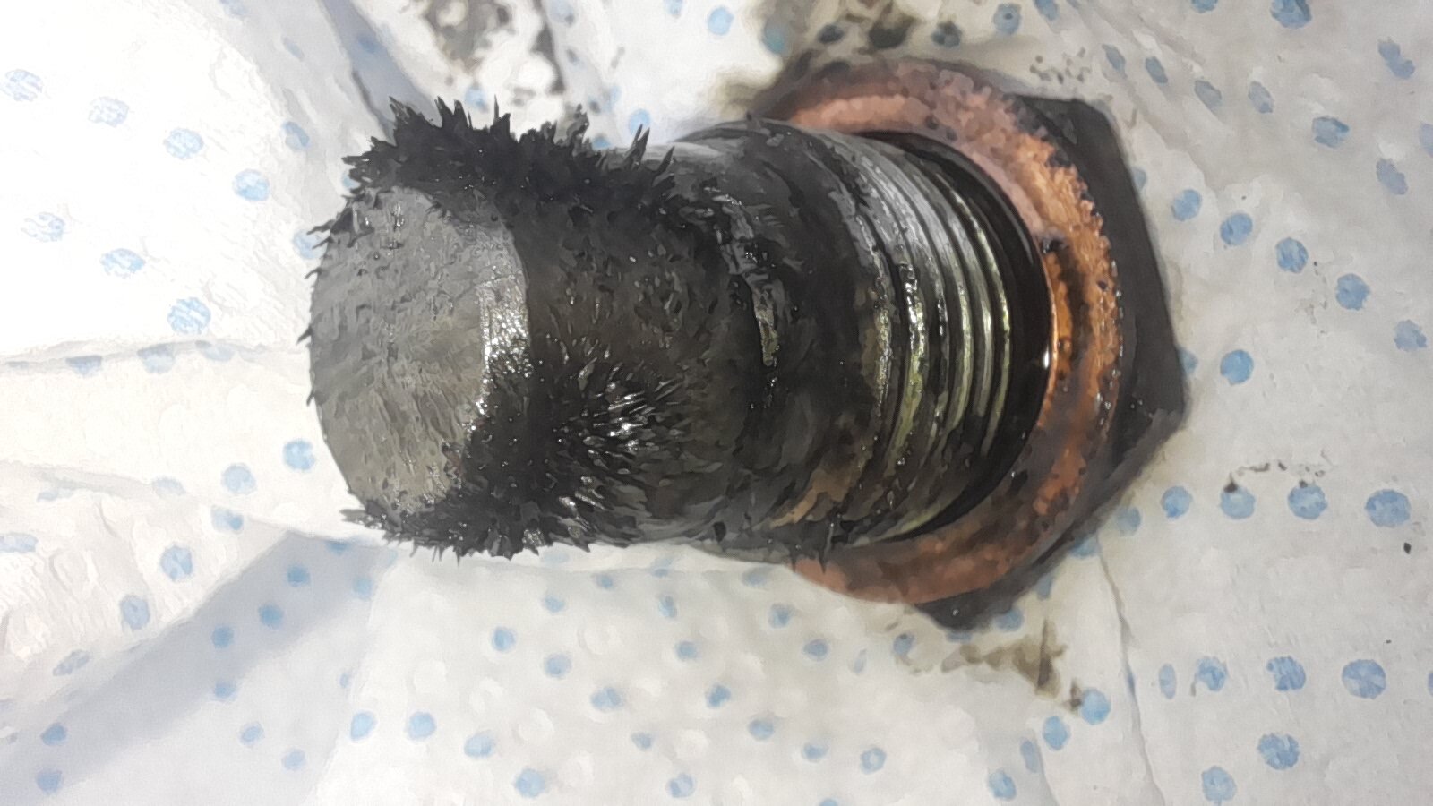

Not many shavings on drain plug and none in oil

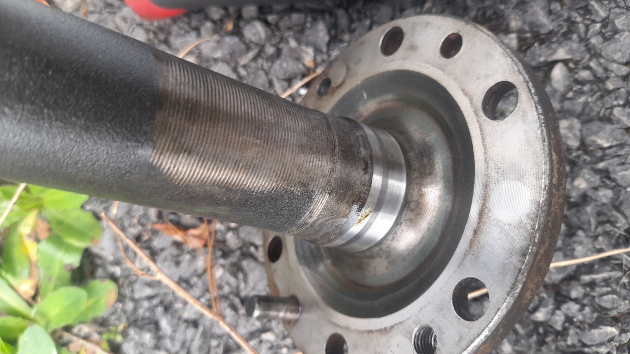

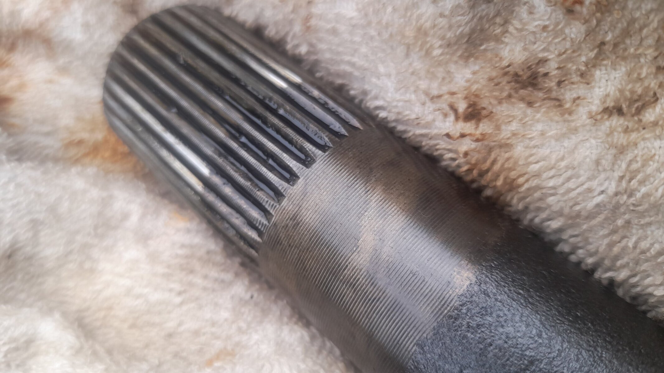

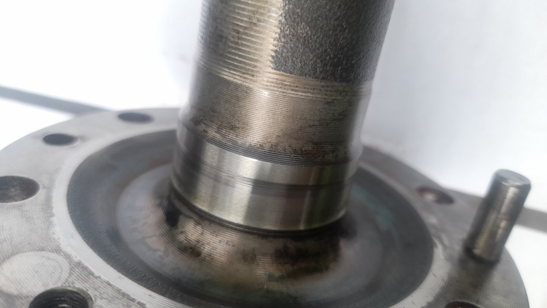

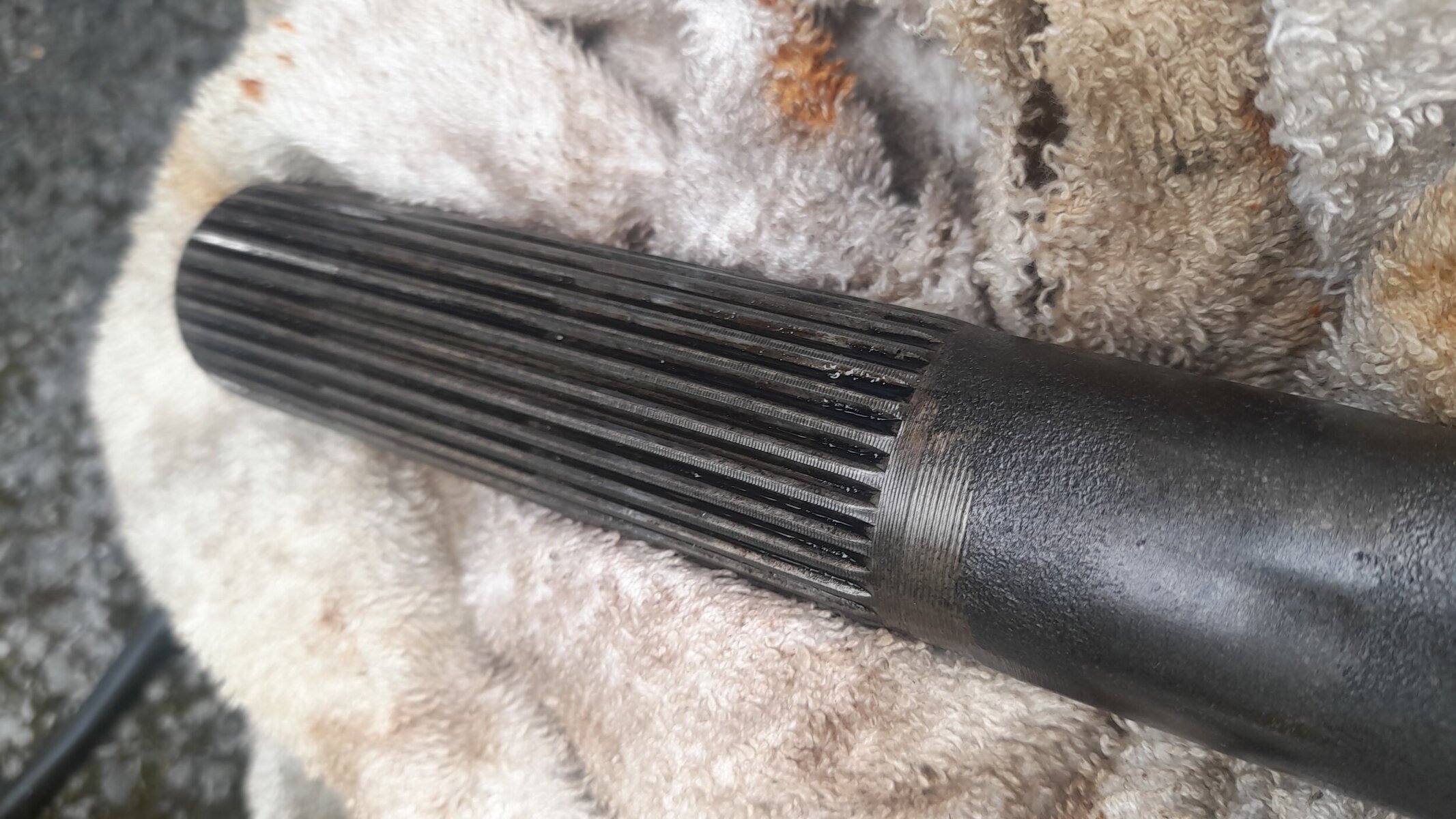

axle shafts in good condition.

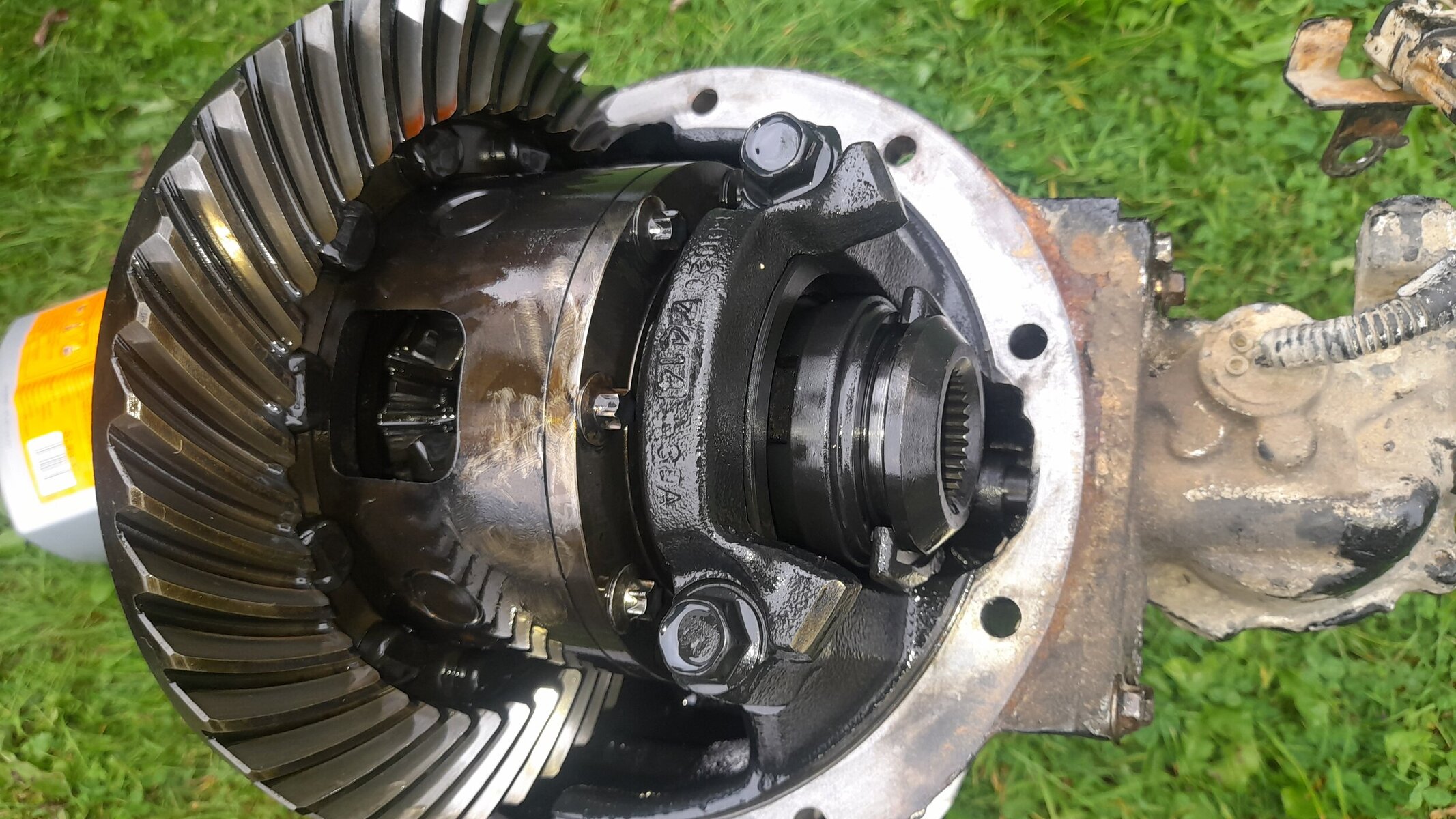

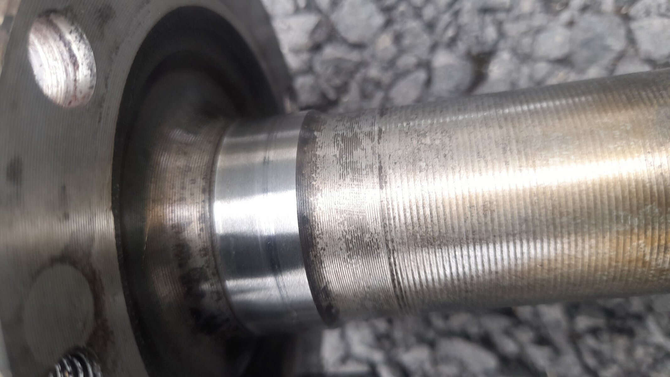

Pulled rear diff and looks in good shape (at least from what I can see) and no looseness
Appears to be grinding near pinion side
Will try and take apart tomorrow
Presume I'll need new crush sleeve and likely a bearing . Anything else?
any tips

I would check those "planet gears?" inside the diff housing. Back in the day I had your noise and it was caused by broken planet gears.
Start with taking the carrier out - just undo those 4 bearing cap bolts. When you lift the carrier out, there's a shim each side, so keep track of which one goes on which side. Having the original shims makes life easier as a starting point for setting it up again after new bearings. In fact with the precision of manufacture these days you won't be far off just using those shims with new bearings.
I agree with Frank the noise sounds like a side gear missing a tooth, or it could be the pinion has a chunk missing.
