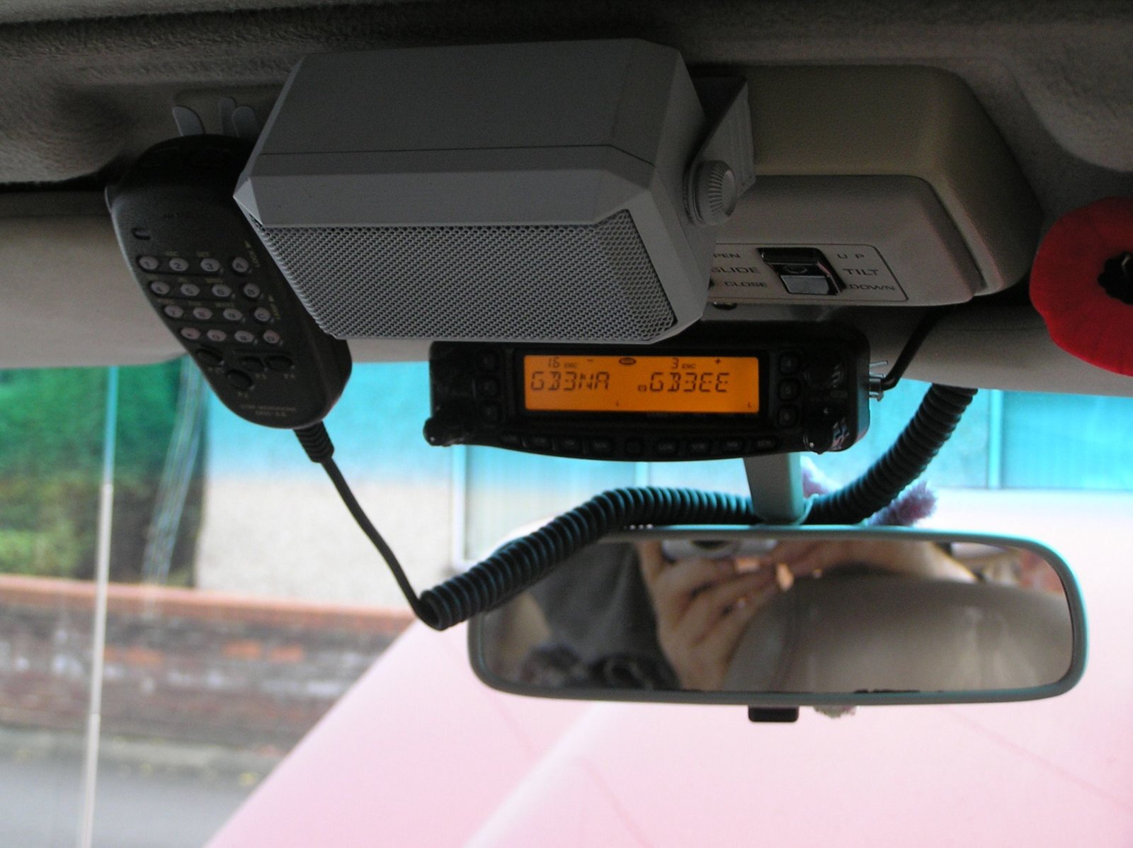

If you have a very small unit or a separate head and base unit then a good place is above the windscreen.

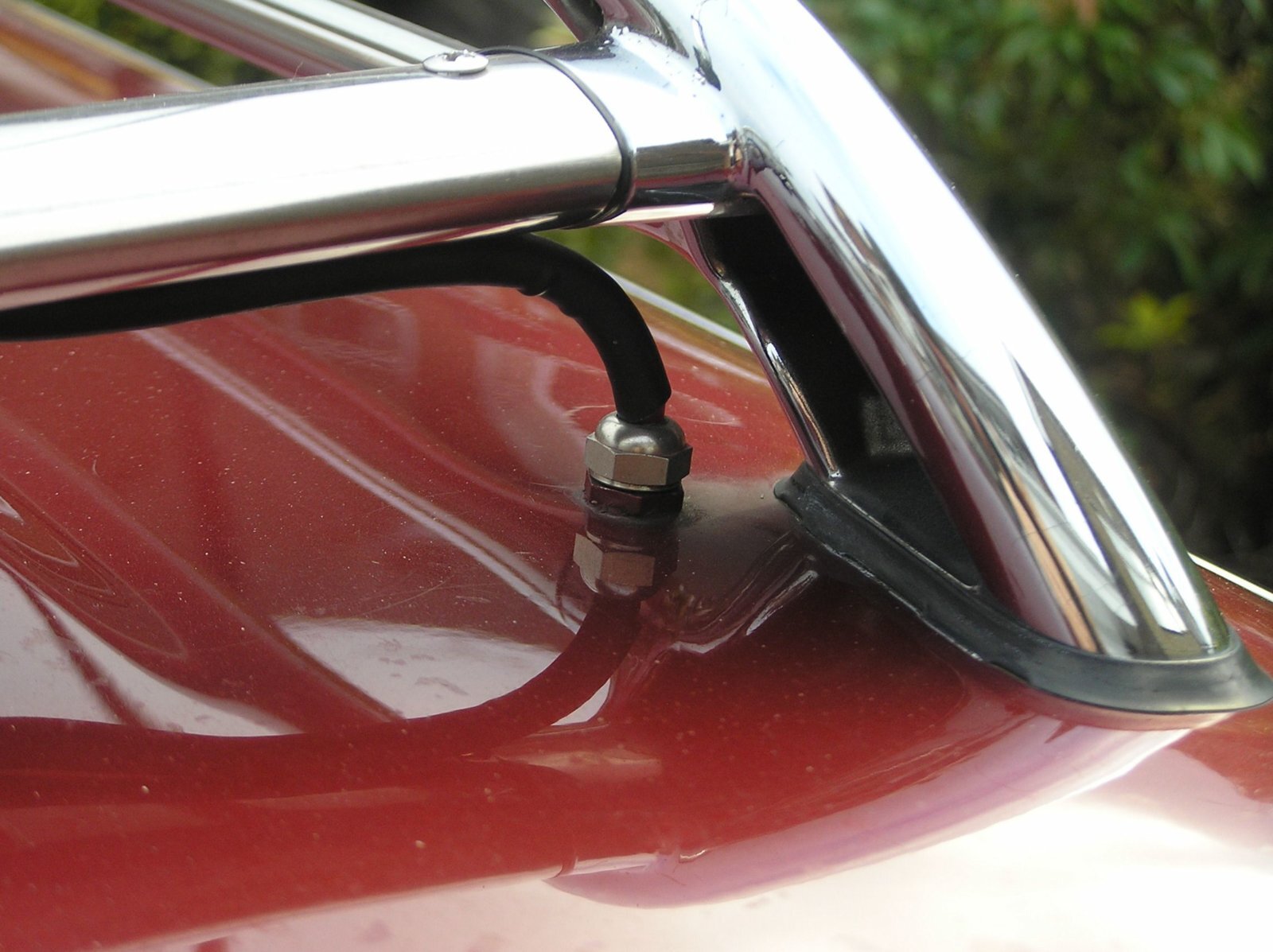

If you drill the bodywork I recommend you use a decent IP rated grommet, not a cheap rubber bung type.

I like the idea of an overhead installation (Towpack) and I had seriously considered it, but my unit is a touch too large for comfort.
