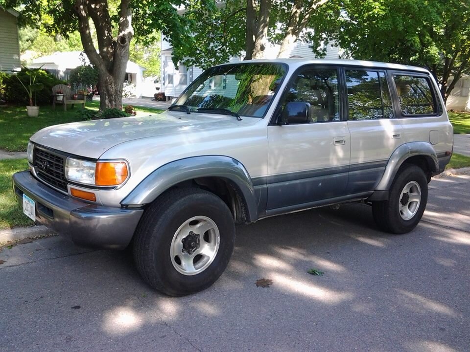

As many of you know, I picked up a relatively rust free, but quite neglected 1996 Series 80 4.5L Land Cruiser in Arizona back in January, sight unseen. It had an inoperable transfer case, but the price was right, so I bought it.

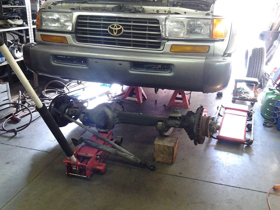

Unfortunately, I shucked a passenger side spindle in San Diego, and fell into the hands of a thoroughly disreputable mechanic, who not only overcharged me, but failed to do a proper job, which resulted in the destruction of my entire front axle in the middle of the Mojave desert at midnight, with my boss in the passenger seat. I had the axle replaced in a wonderful place in Gilbert Arizona at a place called "Desert Tool Service", home to Landcruiser nirvana.
Then it was 1300 miles of trouble free trekking across the American southwest to my home in Iowa.

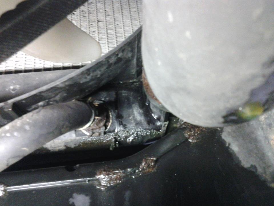

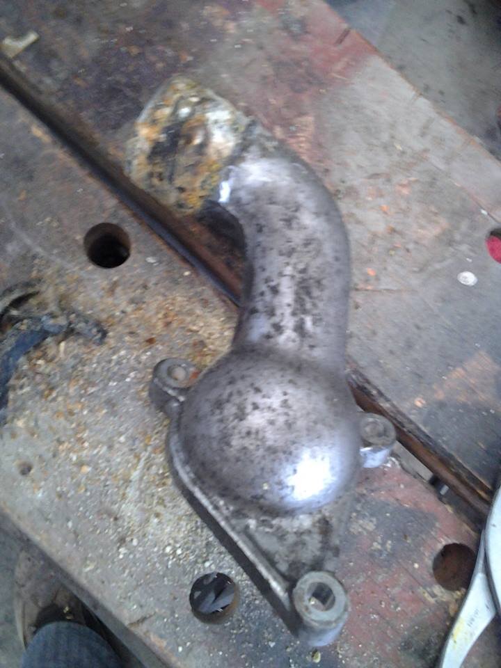

The good folks warned me about the ticking time bomb that is the original Toyota radiator, and directly at 181,000 miles it expired.
While I was in there, I rebuilt the thermostat housing with epoxy

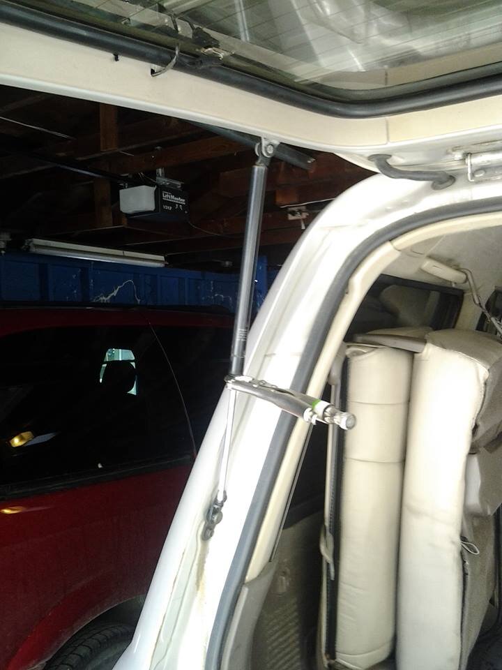

And the expired tail gate lift

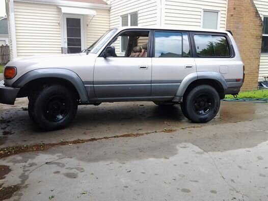

Then I did the wheels:
Both the trim and wheels were sprayed using aerosol can products marketed as trim and bumper as well as wheels, respectively.

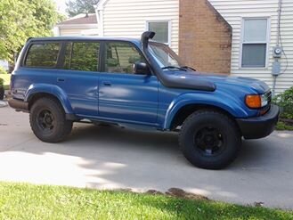

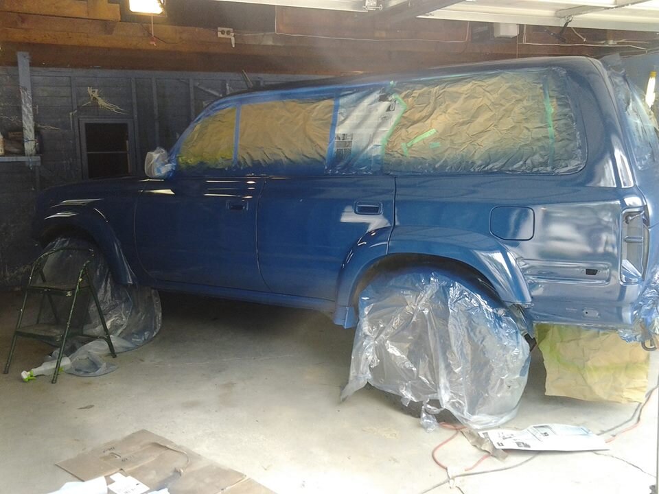

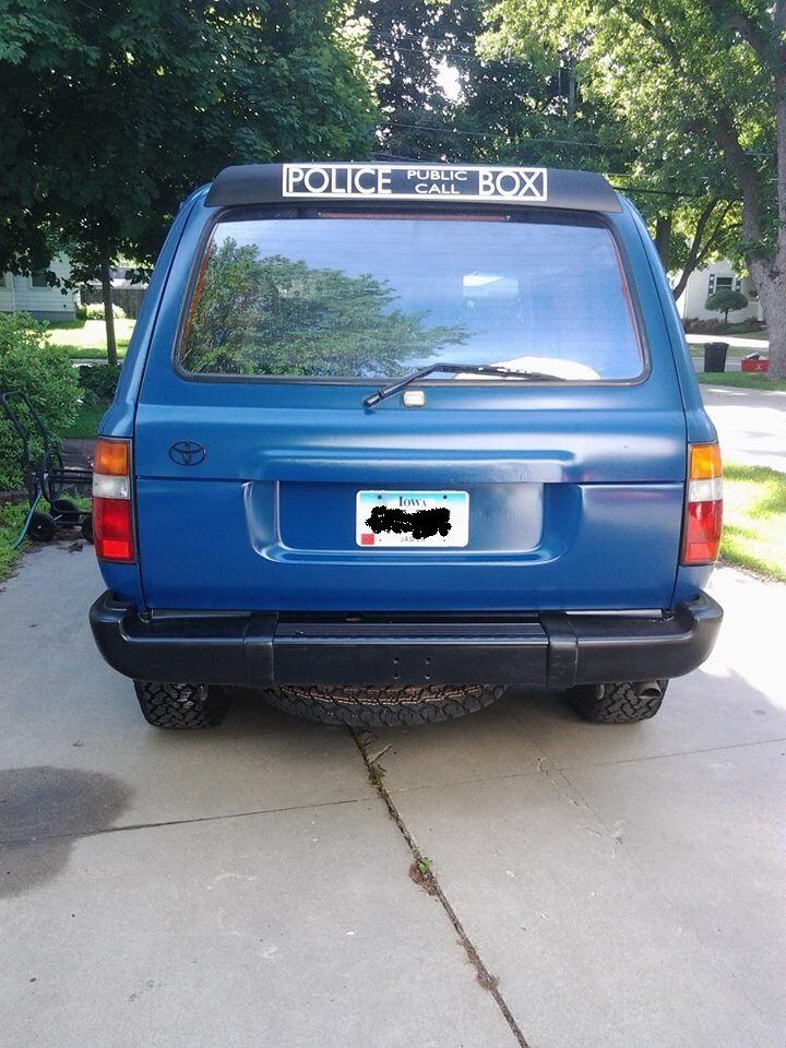

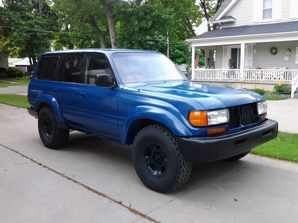

So, I put it in the paint booth, and resprayed it blue. The industrial distressed look is really popular, so I did no body work, leaving the trail dings and what not on it, and used a gloss blue paint I found at the tractor store.
I briefly lost my mind and purchased a $40 snorkel off ebay, and spent a couple hours installing it. According to all I've spoken with, these are amazingly well made, and installation was a breeze.
Both of my daughters just left the nest for the last time, and have ventured out to make their way in life. As a tribute to them, and their undying love for "The Doctor", I decided to make this Series 80 "bigger on the inside."

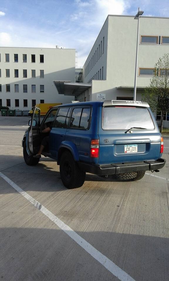

And now I am cleared by customs to import it on a temporary basis (dependent on my continuing employment here) to Germany. Three cheers!
Delivery is the week of the 17th.

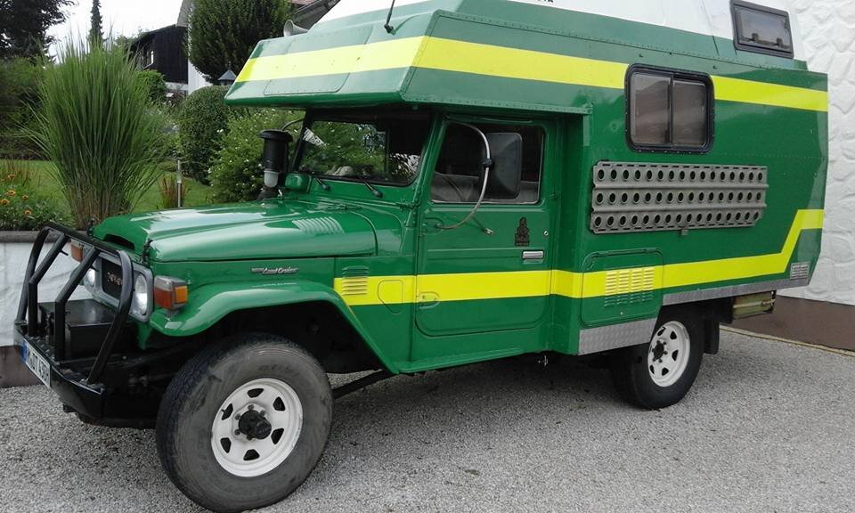

Delivery should be soon. Oddly enough, I went on a walk around my new neighborhood in our German village, where I encountered this gem:
I think I need to get to know this fellow.

The green 40 looks cool! :icon-cool:
