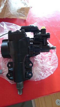

Package from Toyota arrived:

€1300, pretty reasonable
Is that price including import duty and all other costs such as postage etc? If so, you've done just fine I recon...
Tax is included, postage was €100. But I ordered a bunch of other stuff as well, so...
:) the steering box was the most expensive part.
I also ordered an a/c clutch. Also pretty heavy.
Sounds expensive to me - that's over AU$1900 but you did say it is new and I don't know how much a new one is in Oz. However I had mine re-done with a reconditioned (genuine and rebuilt) unit in 2007 and I just looked up the receipt. It cost me $660 for the unit which is 445 Euro or 380 Pounds at today's exchange rate.
I know a rebuilt can be cheaper but the gears inside that cause the free play in the steering wheel, aren't replaced with a rebuilt one (at least not here). A rebuilt one costs €1200 over here... and you have to send you old unit in.
So a new one was my only certainty
Well, if a new one is 1300 and a rebuilt one is 1200 then it's a no brainer as our American friends would say.
