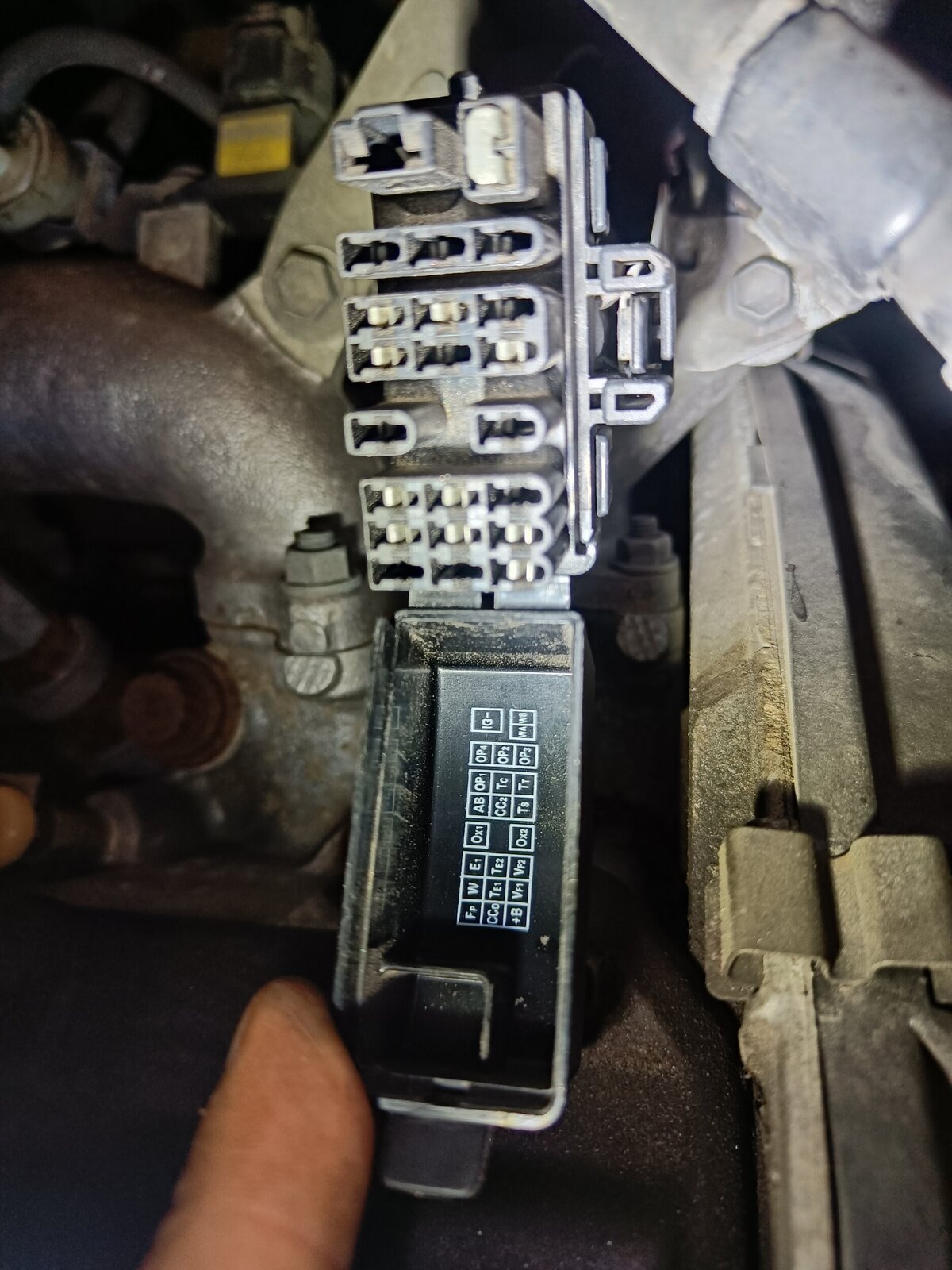

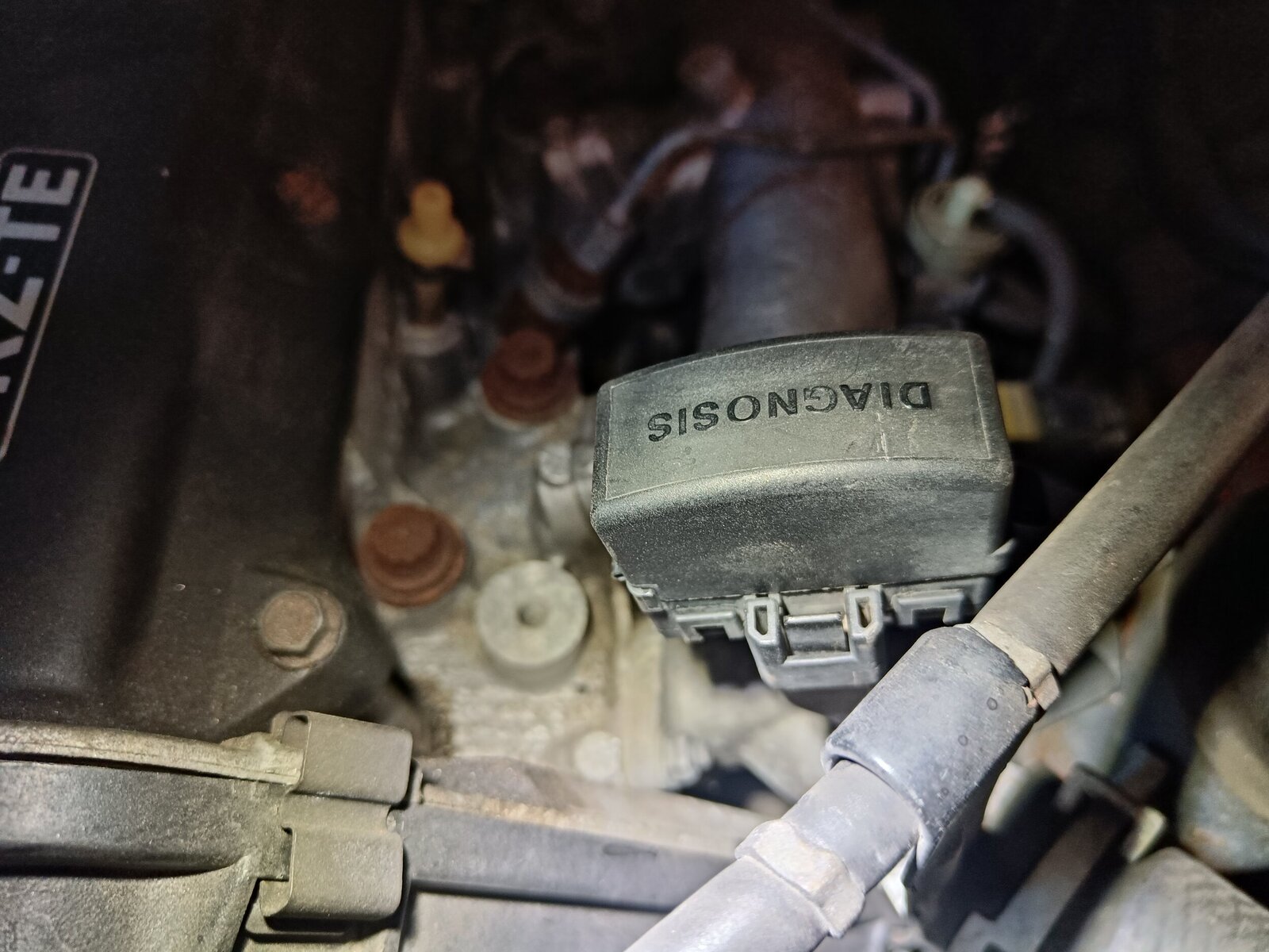

Any tips to get airbag warning light to turn off (stationary)?
I had to take my steering wheel of for a moment and in the process got the light on. Everything should be okay now, but the light stays on.
Car has the old toyota diagnosis connector in the engine bay. I google that maybe some wizard shit with paperclip might do the trick, but if anyone has better instructions i would be happy to hear them.
Thanks!
with the paperclip trick you can read the stored codes. if you triggered the code you need to pull a fuse (EFI possibly?) in the fuse box to reset it or take the battery off for 10 min should work too.
