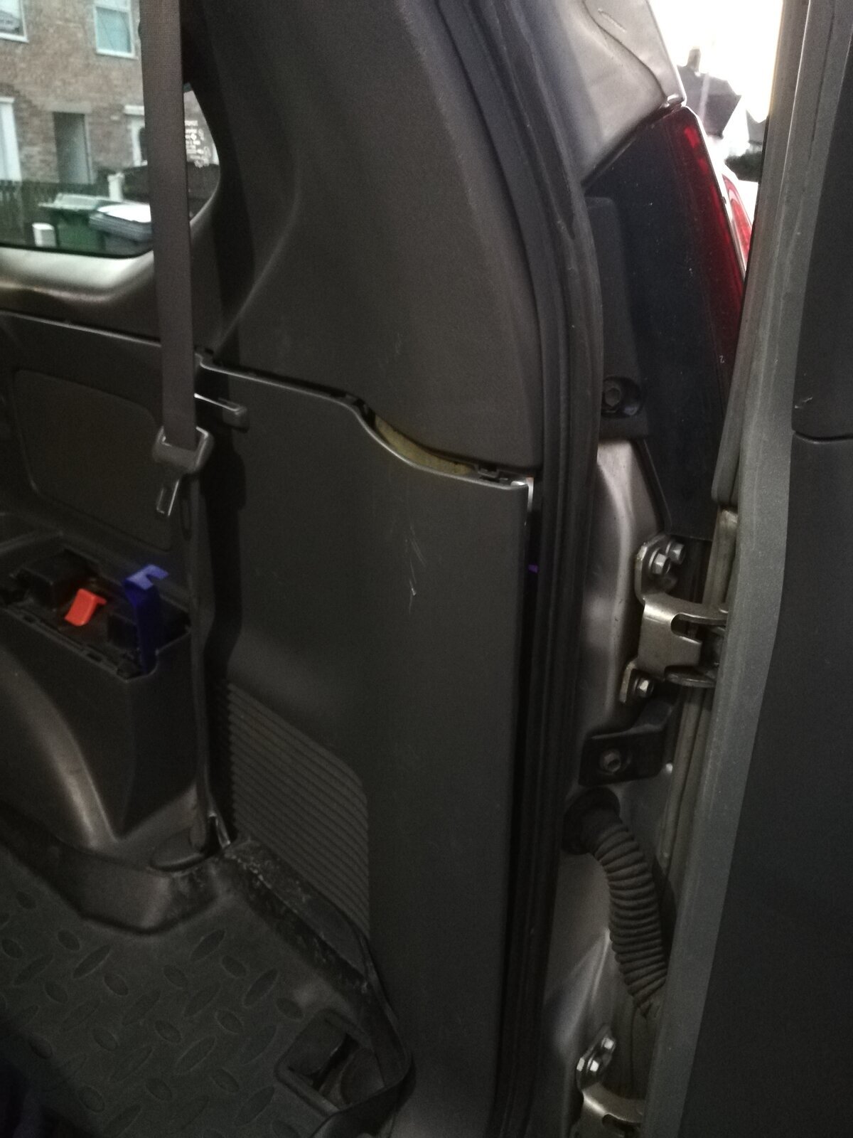

This is the rear back panel hiding the culprit.

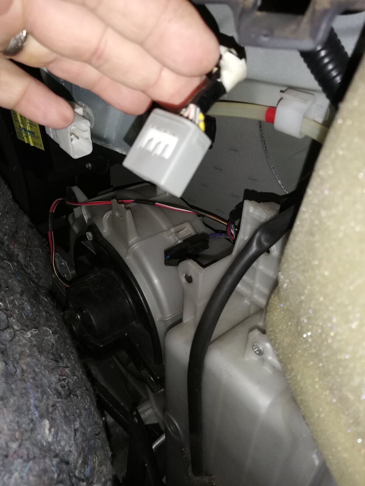

This is the plug causing all the earache so just unplug and it is the end of you nightmare.
Update on my alarm going off as since disconnecting the rear plug in the above pictutre my alarm has not gone off since.
