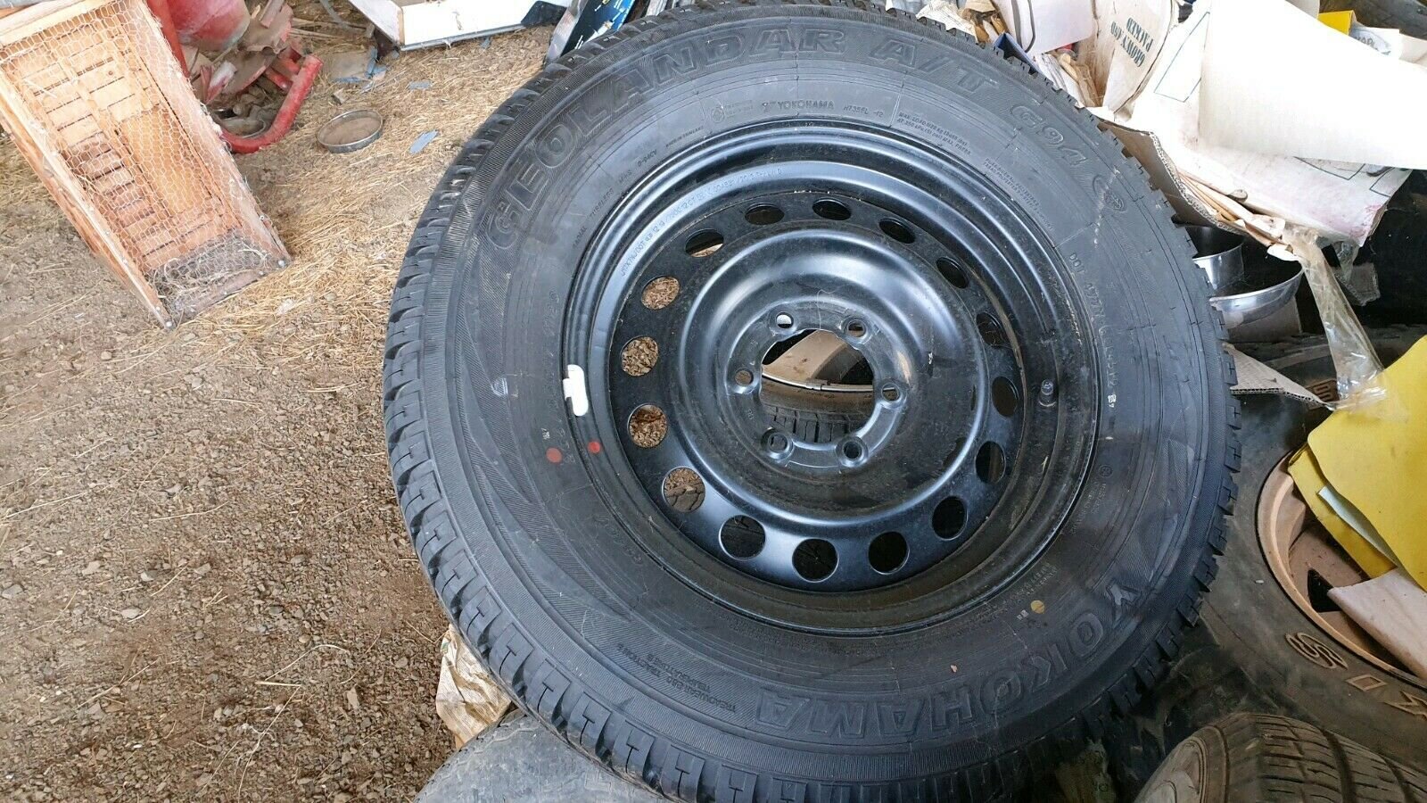

Hello yes another rim question on the HZJ75 Troop carrier
I am currently running stock 16x5.50 split rims on my troopy
I would like to run 16x6 Hilux rims similar to the ones attached. I want to paint them grey to mimic the look of the new steel rims on current model cruisers
