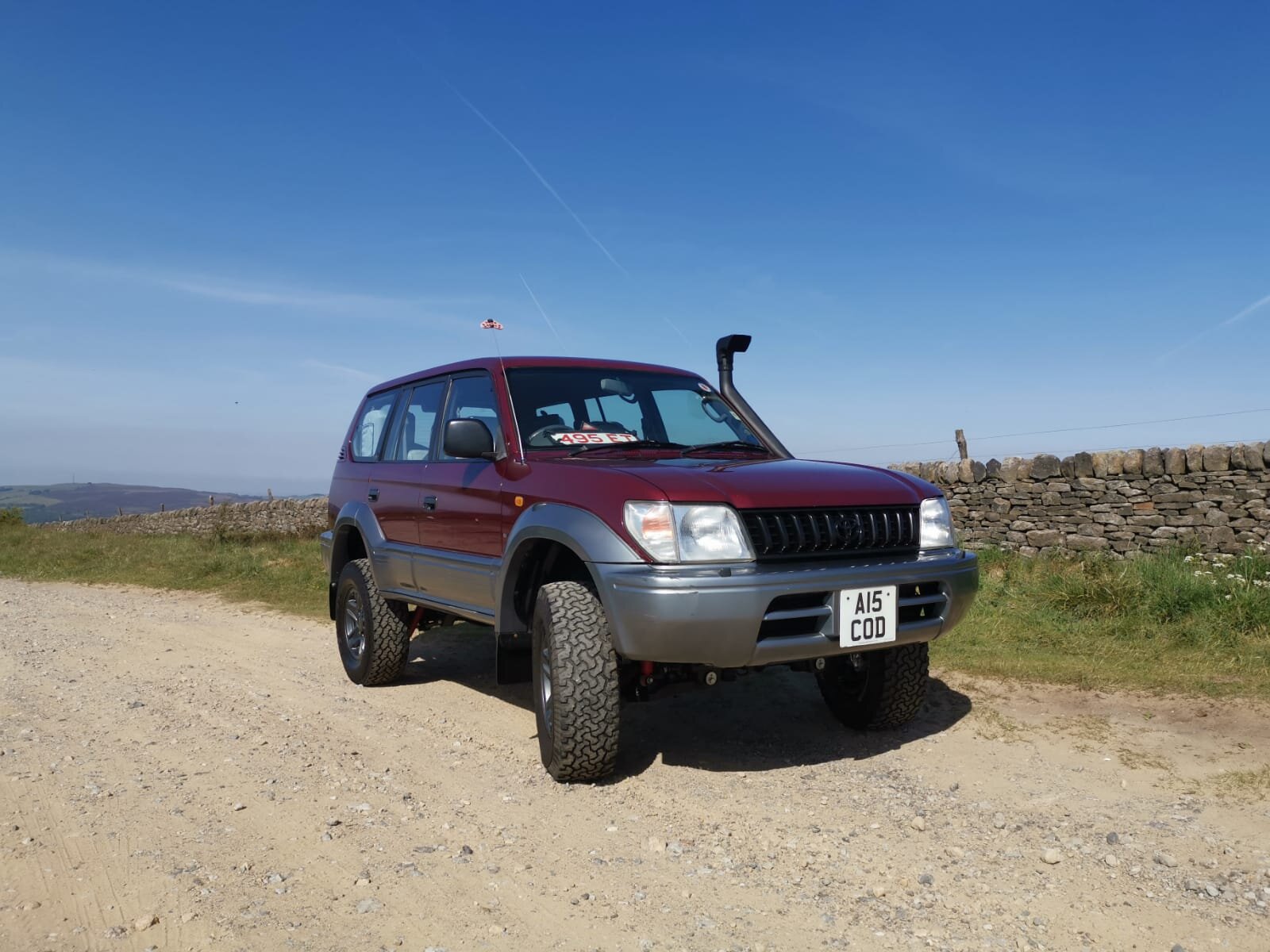

I'd say 60% of it is new metal, the bits that aren't were scaled with an air scaler then painted in por15. The new metal was painted in chassis black from Frost restoration. The whole lot was then coated in clear waxoyl inside and out.
