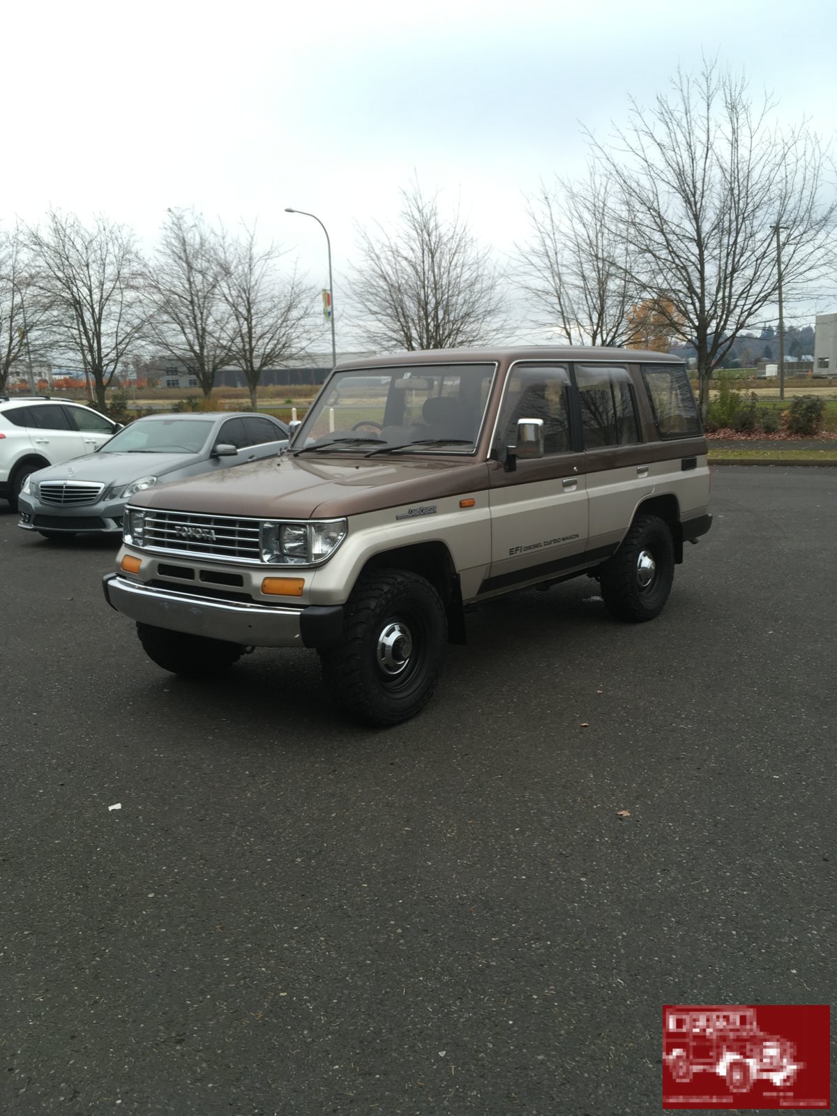

Hi just picked up a new to me 9191 LJ78 wagon. Found this forum full of fresh new j70 owners with big plans. My new rig is in very good condition for its age. Only has 24k miles and everything seems to be working.
