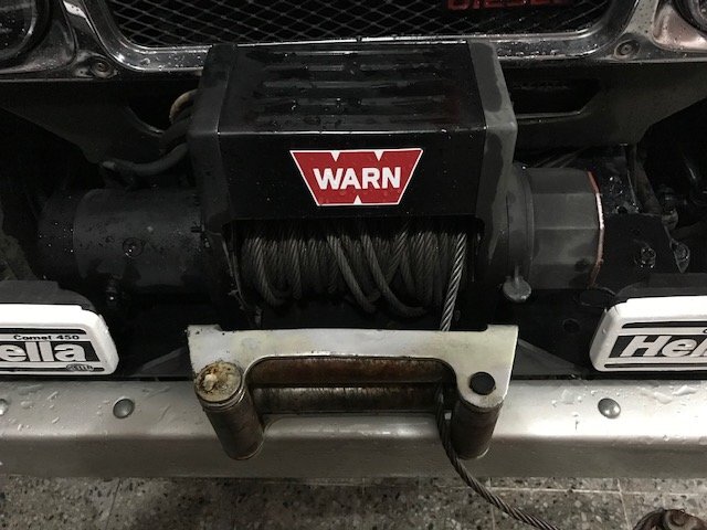

Anyone know what this Warn winch model is?

looks like an older warn Tabor.
On the gearbox side there will be a serial number somewhere on the housing.
If you can find that I should be able to identify it.

I think I actually found what it might be. Have a feeling previous owner just threw some Warn stickers on a Champion Power Equip winch. This photo looks identical... not sure about their reputation but still works pretty good.

Hi Bobby, the cover on the right looks different. Yours is polygonal whereas the Champion one looks round and a bit larger. You may have a Warn after all. I agree, the solenoid box looks identical.
Whatever it is, it looks like the cable is wound on in reverse, it should spool off the bottom to keep the leverage on the winch to a minimum.
