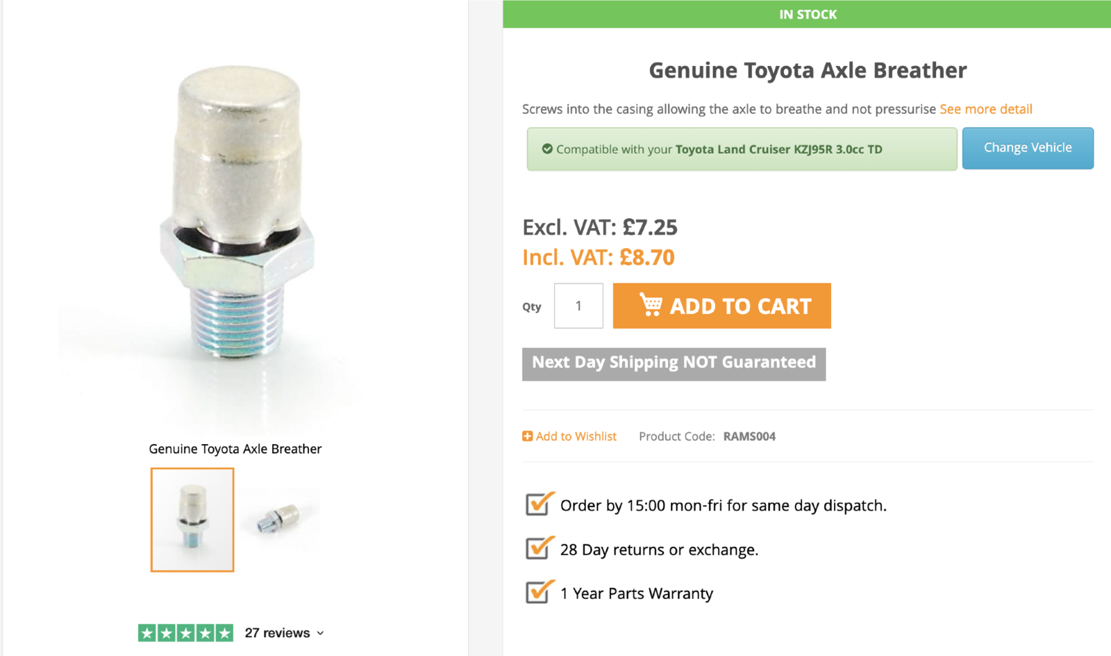

I changed mine. It rusted up and fell apart. It unscrewed easy and the new one is loose as fbnss says. See photo
They are on Ebay as well for £11

The best way to check that is to chuck it in the bin! but the good news is that with the exception of a bulb those breathers are just about the cheapest part you’ll ever buy for a Landcruiser! your front diff has one as well so hang the expense and order two!
EBay as Buller mentioned or Roughtrax, they had them in stock when I bought two last year.
It might not stop the weep on your hub seal but it’s a good place to start!
