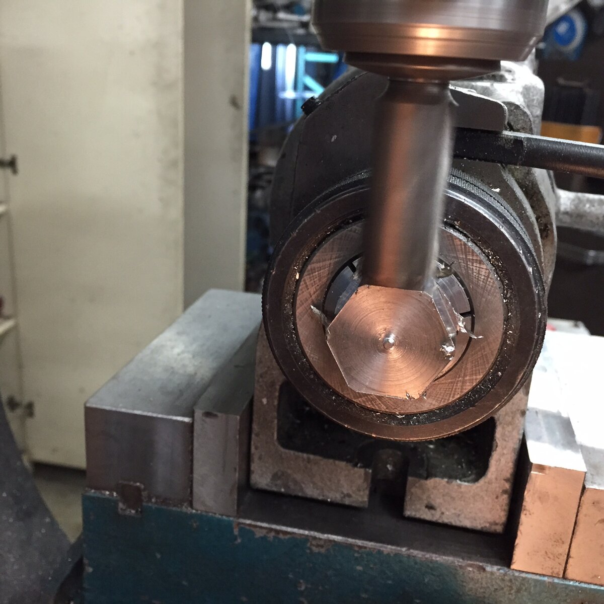

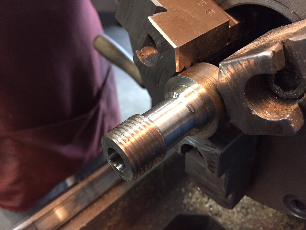

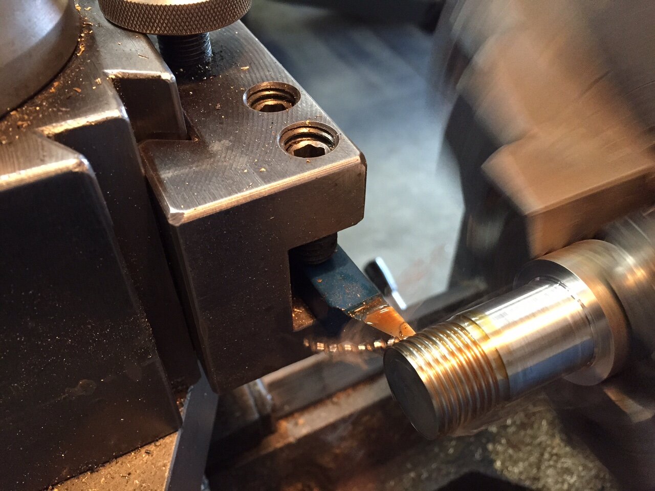

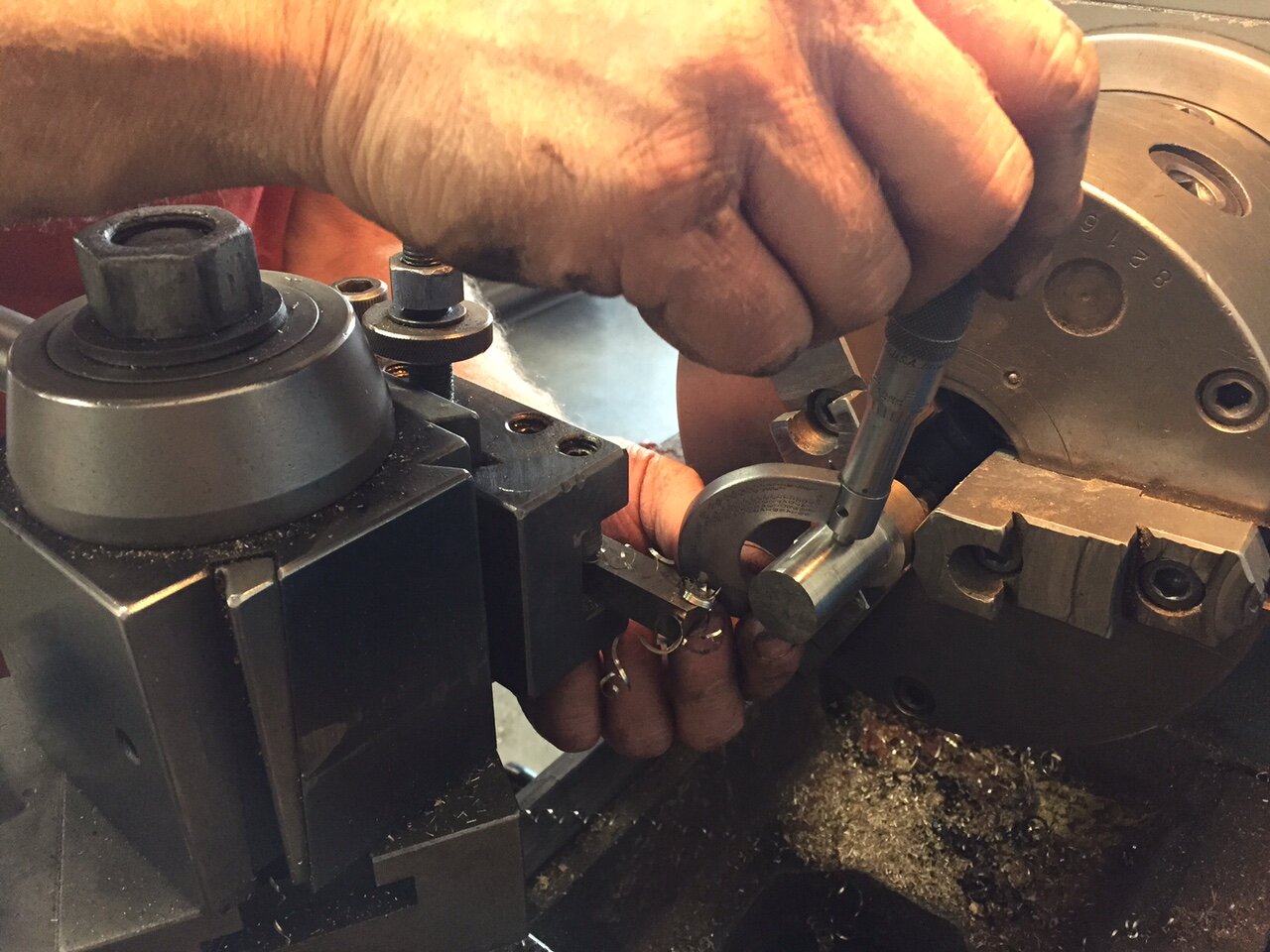

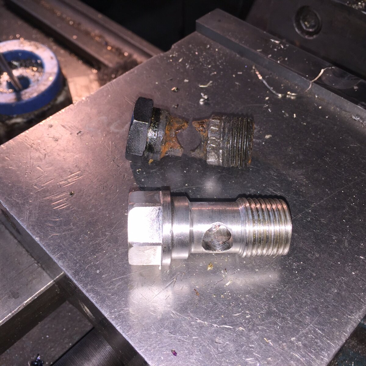

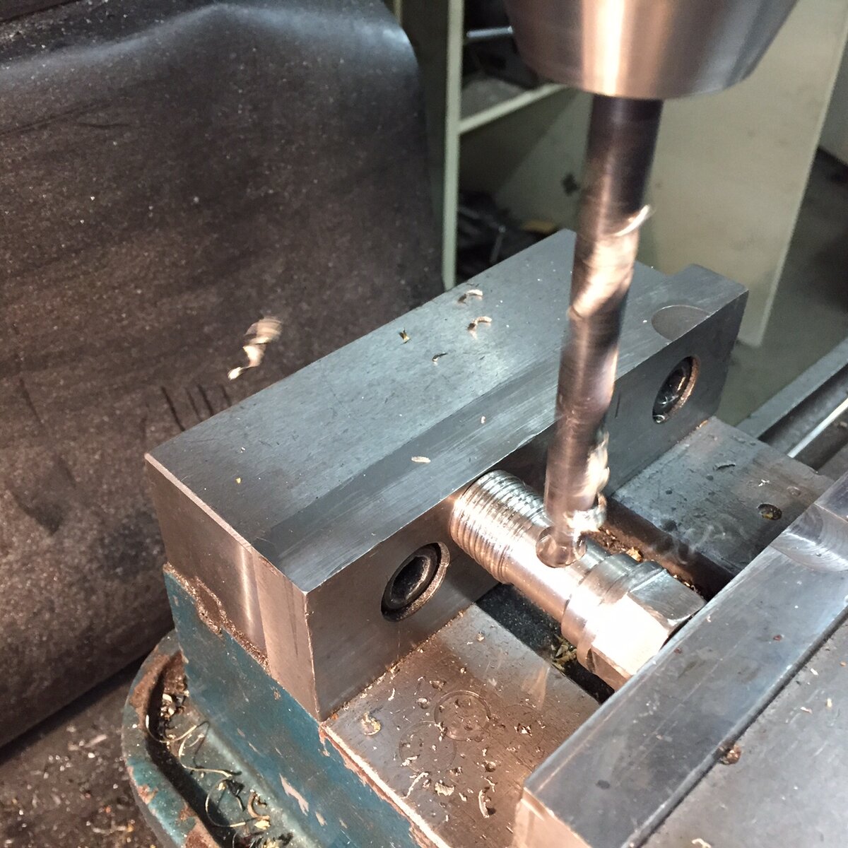

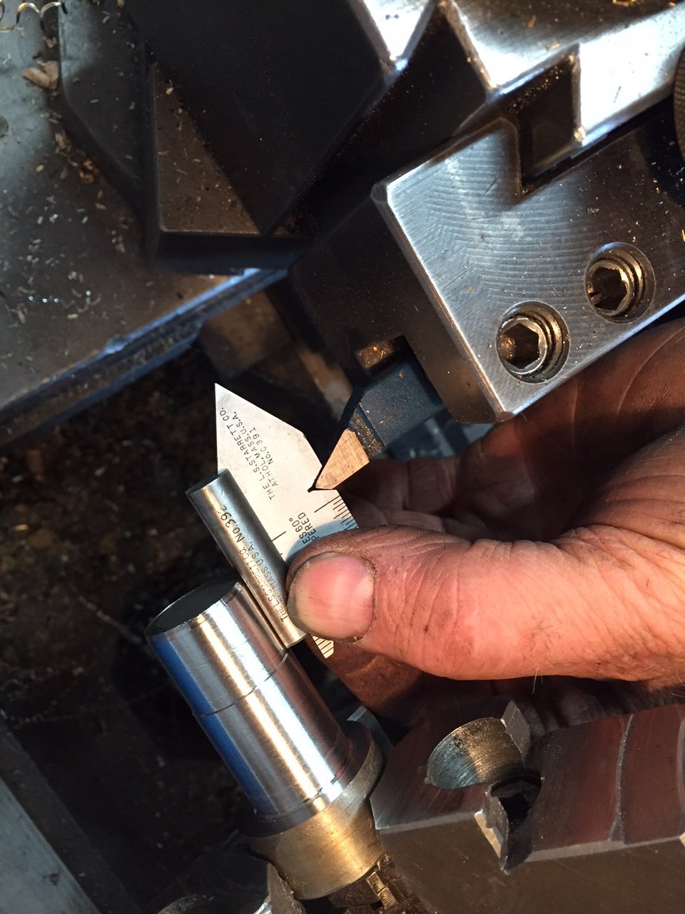

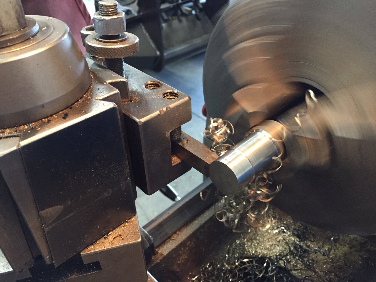

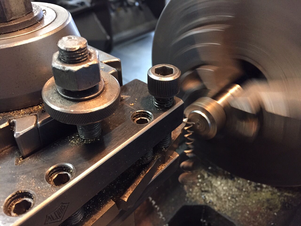

THANKS!! Italian pump went south on the pressure washer. Replacement banjo bolt was 5 days away and cost 85.00 plus freight. Used stainless on the one we made............should last forever.
I wondered why the machining had a "grainy" look about it, stainless is a barsteward to work with, IME.

Super sharp cutters and plenty of lube I guess, when machining...
