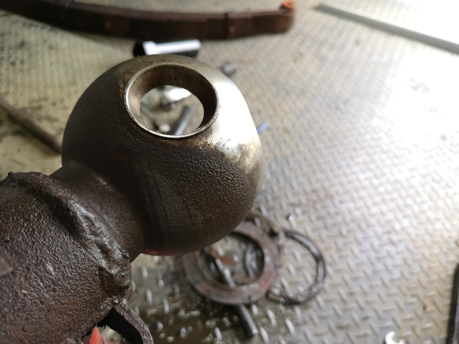

    I stripped the swivel hubs today and the surface is heavily pitted. To my knowledge it didn't leak before but I'm a bit concerned that there a bit to worn ?

    If they are leaking make sure it’s not oil getting past the inner axle seal from the diff. I was told my hubs were leaking because of pitting but it was actually oil from the diff as this seal had failed. I had it replaced with a special sea kit from terrain tamer last month, a thousand miles later all is dry

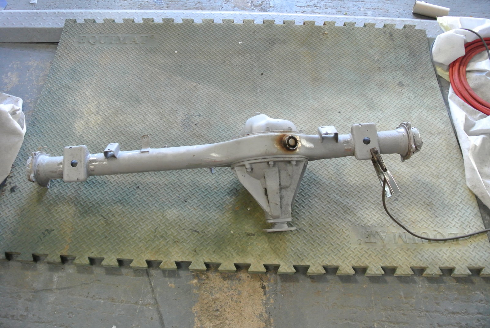

    Some photos of some of the chassis work etc

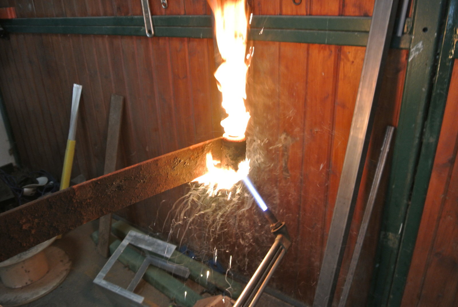

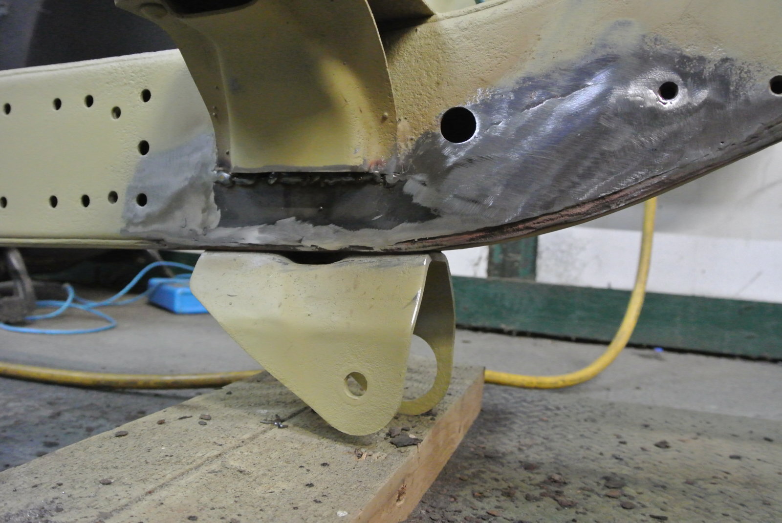

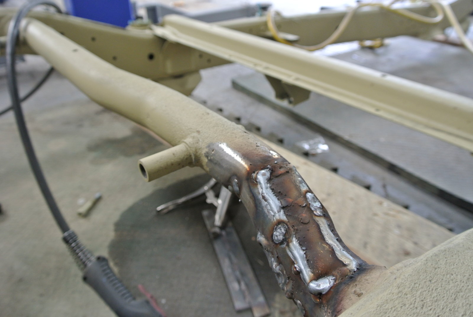

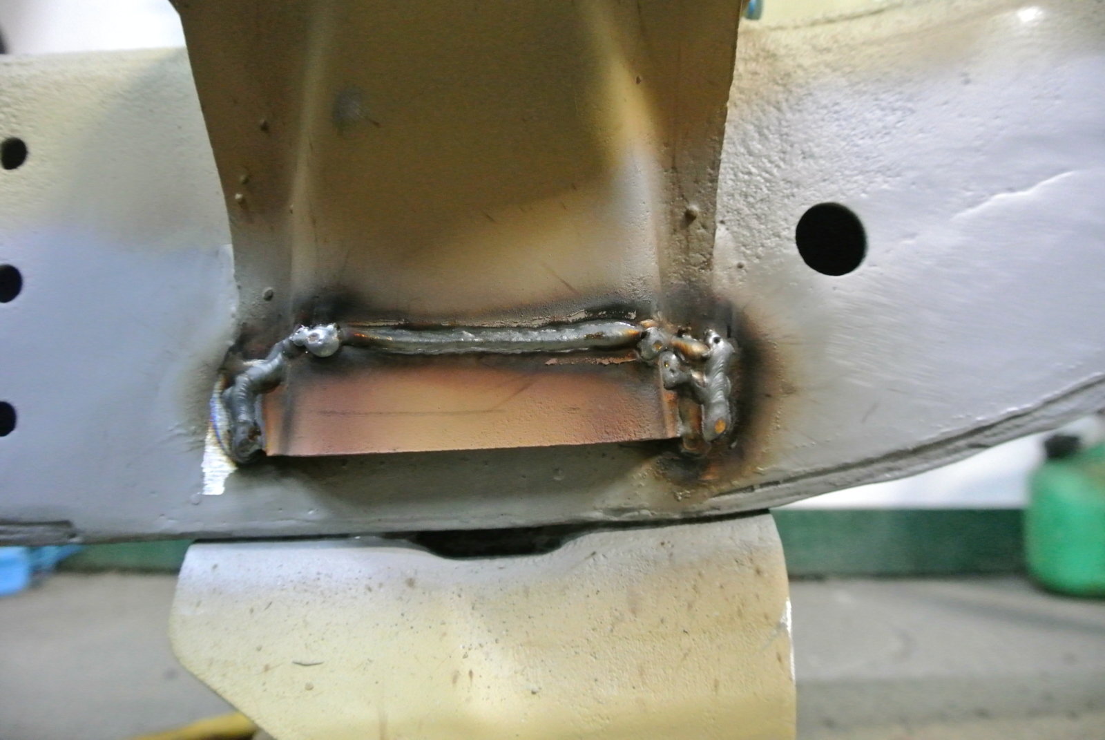

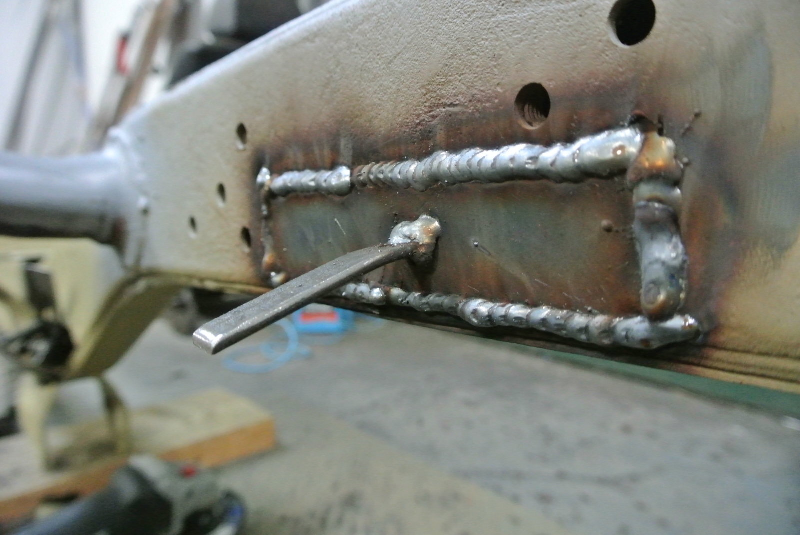

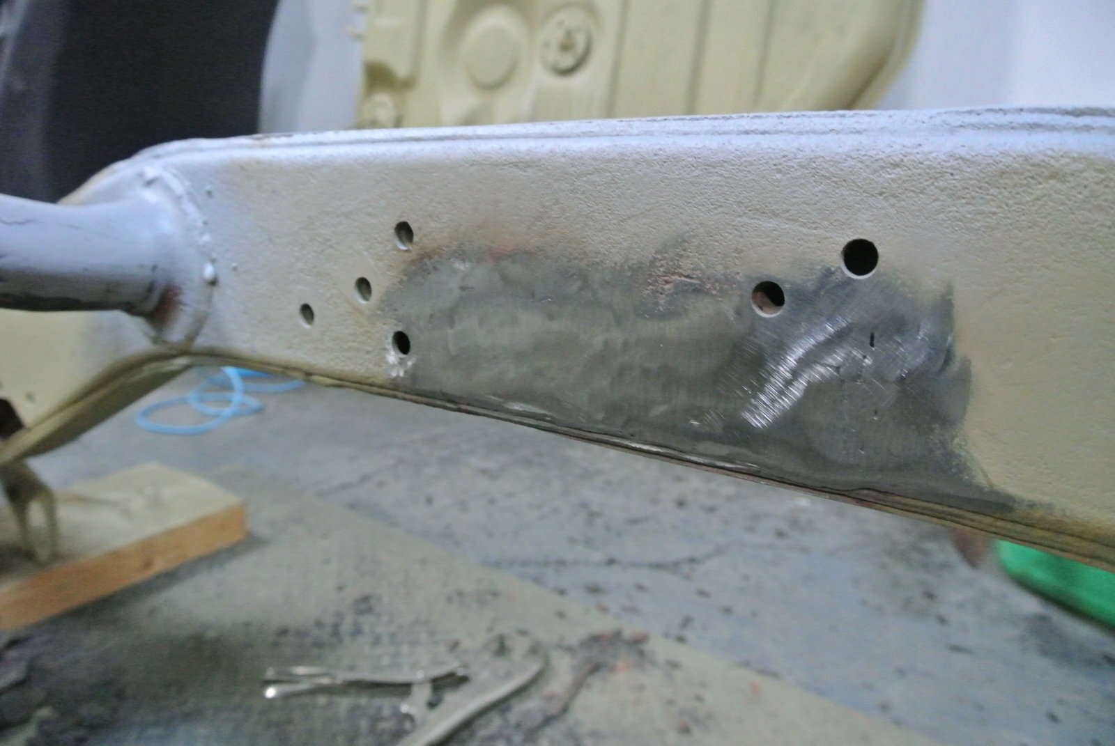

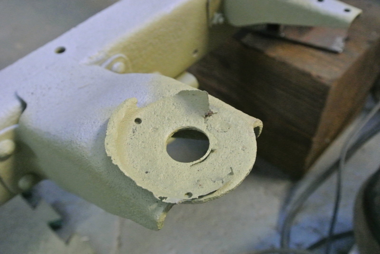

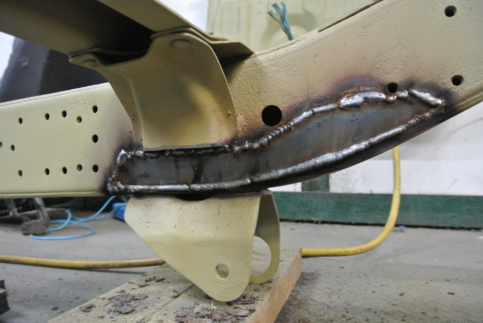

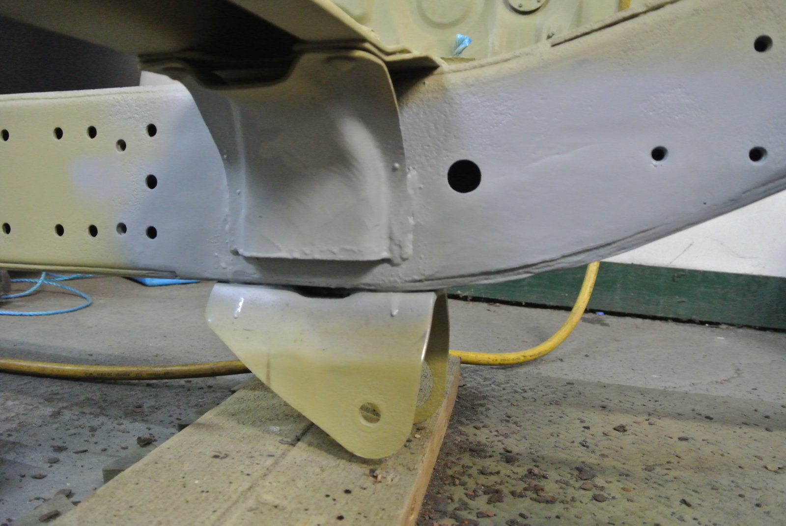

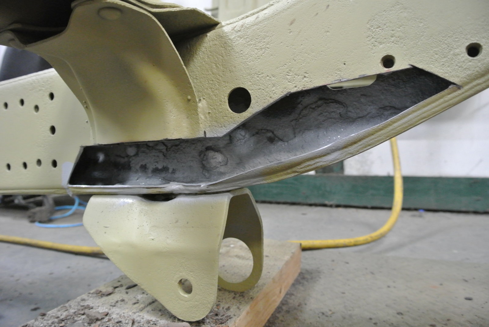

    This was the worst of the rust on the chassis
    DSC_2817.JPG DSC_2819.JPG DSC_2820.JPG DSC_2821.JPG DSC_2822.JPG DSC_2823.JPG

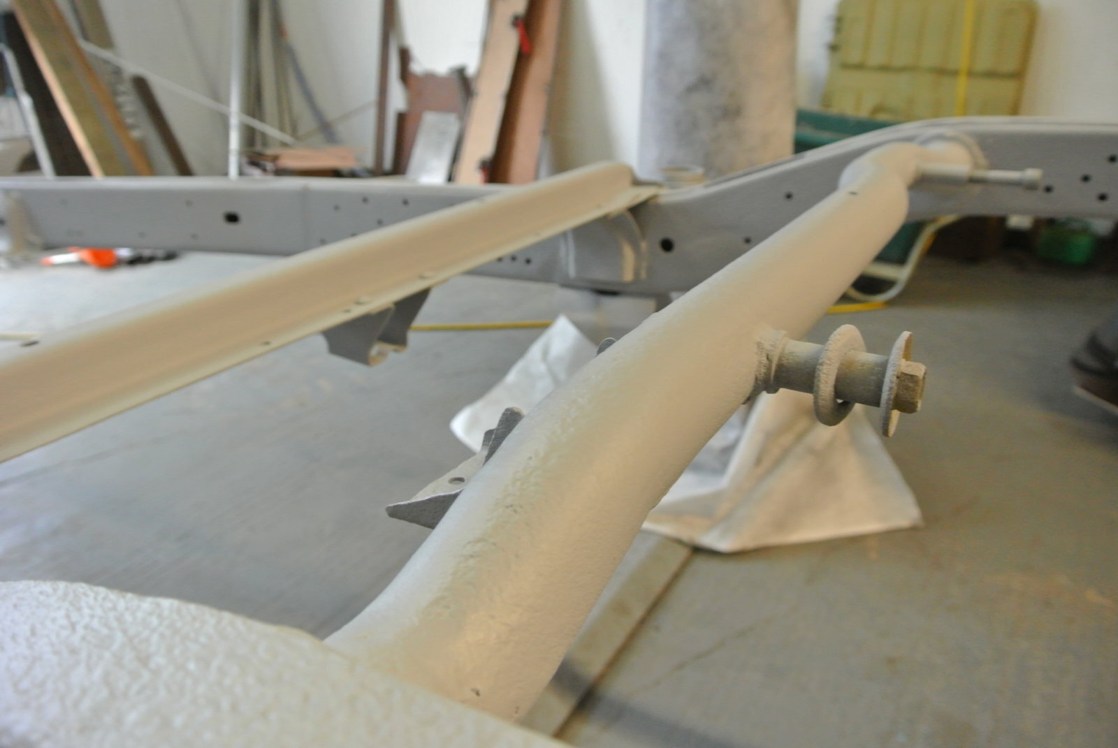

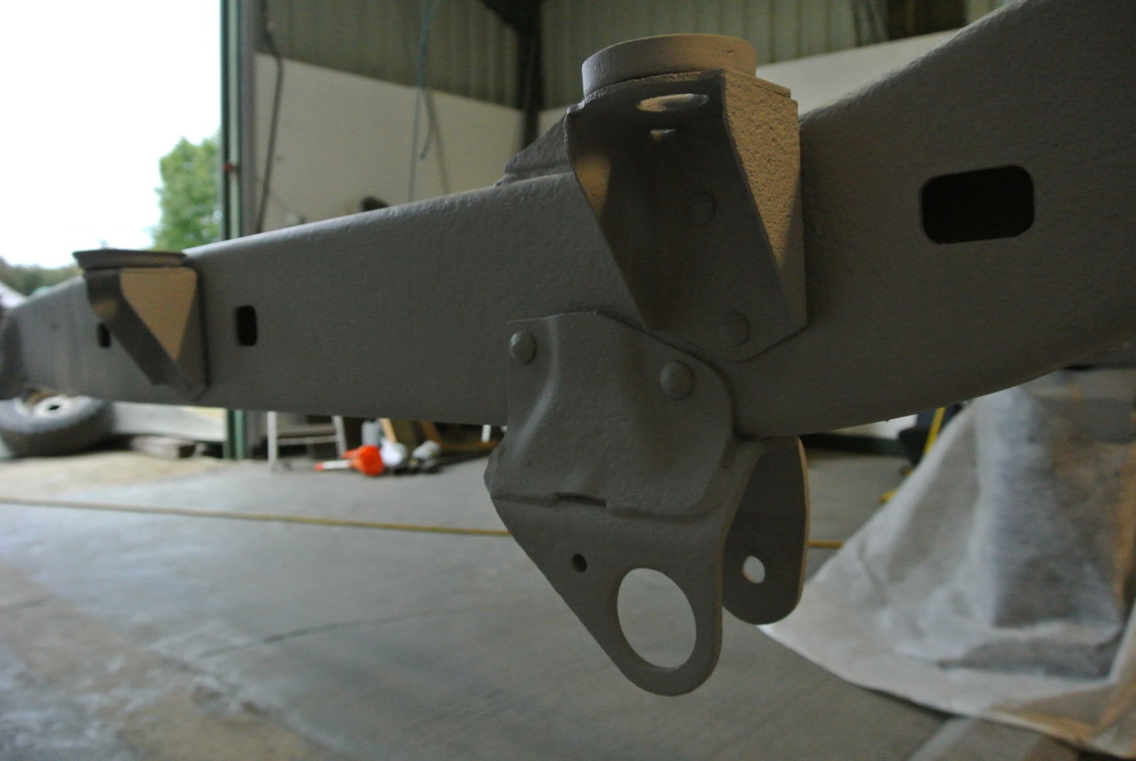

    some primer

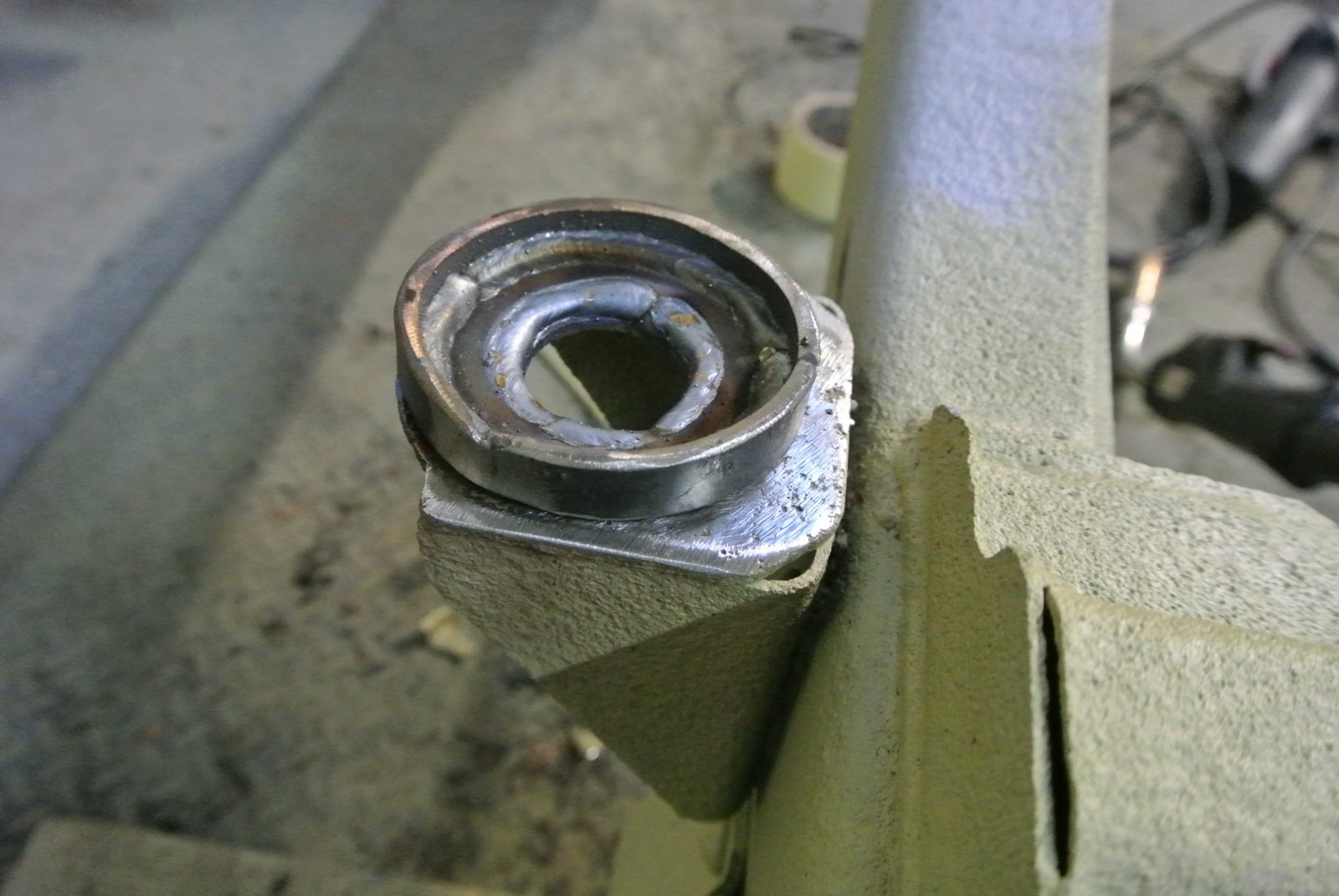

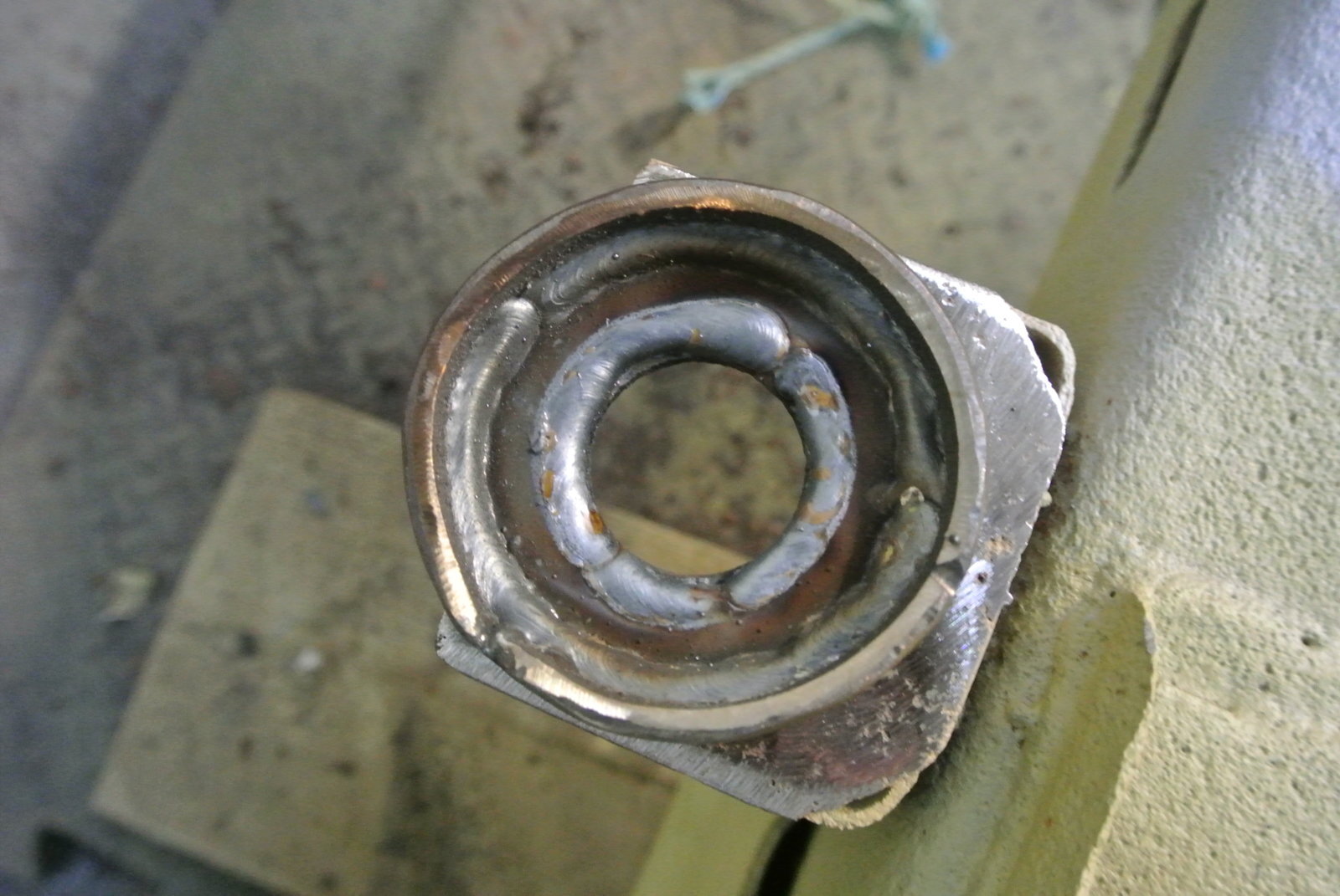

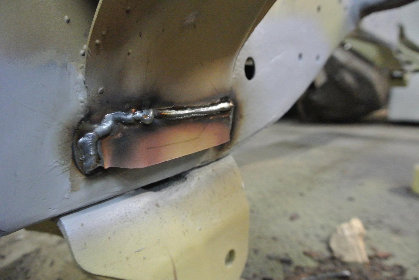

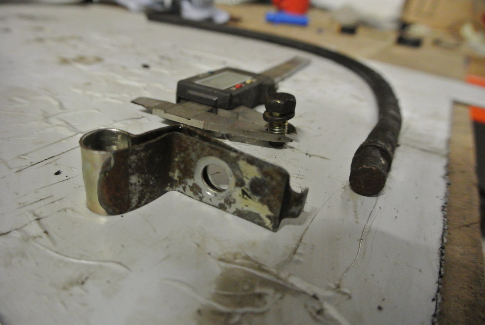

    Forgot about these 4 of them needed replacing

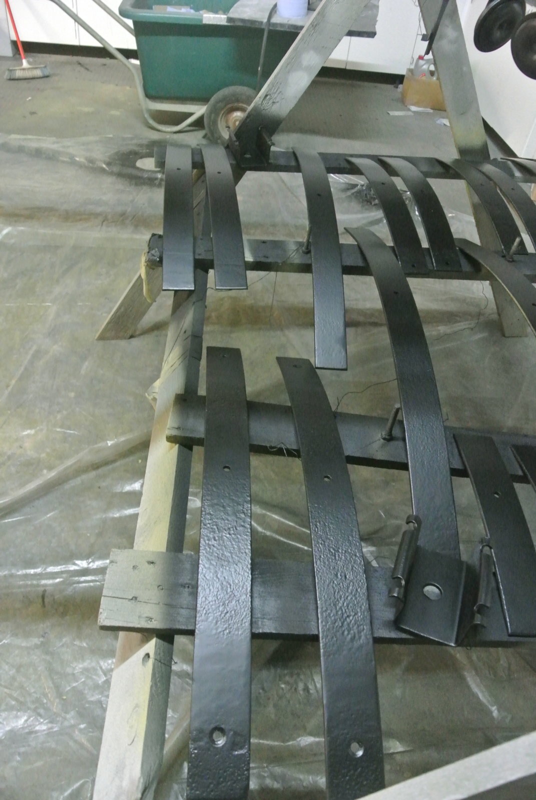

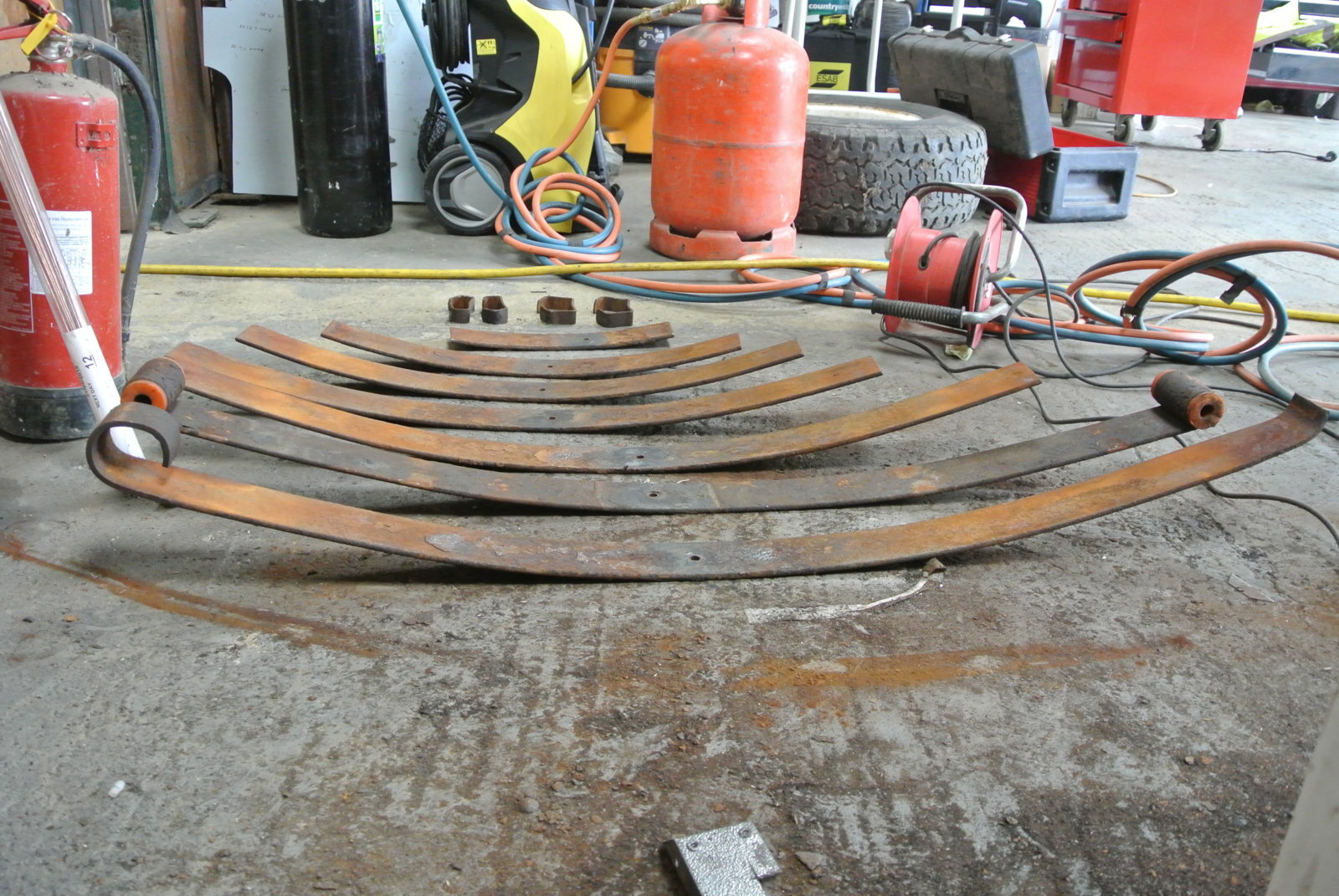

    some leaf action

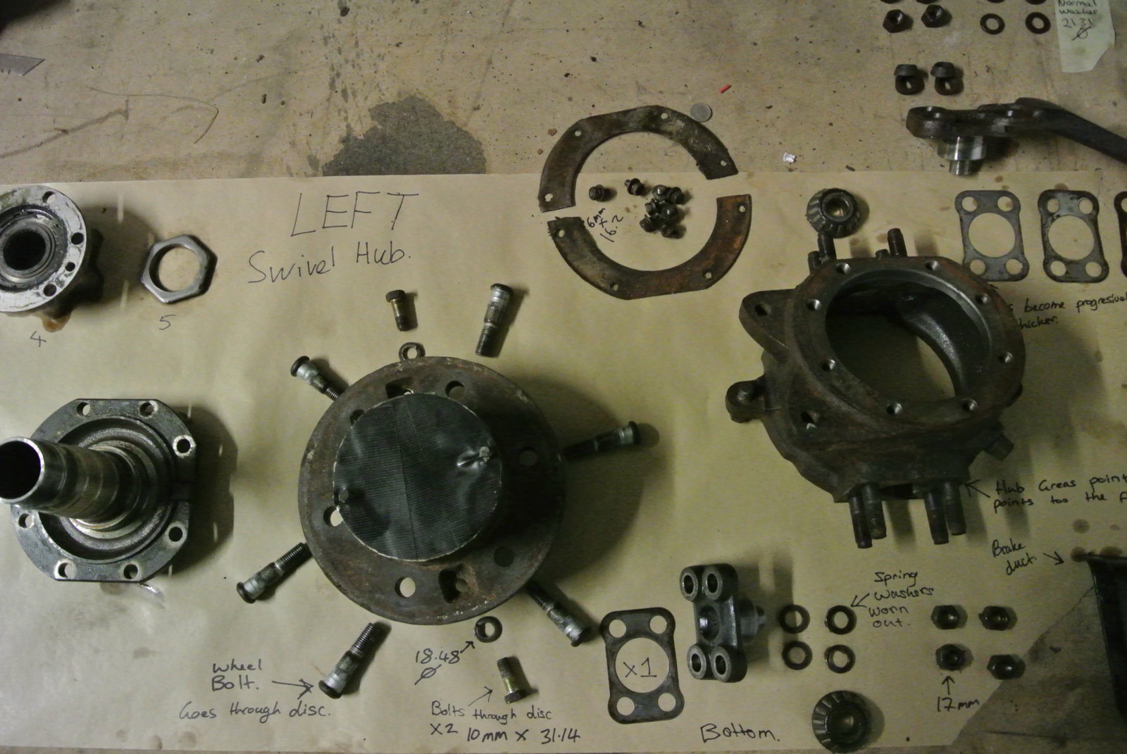

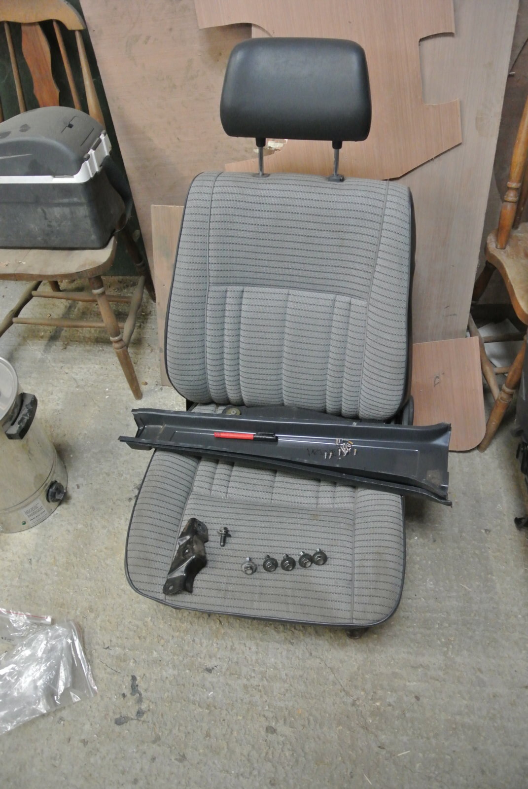

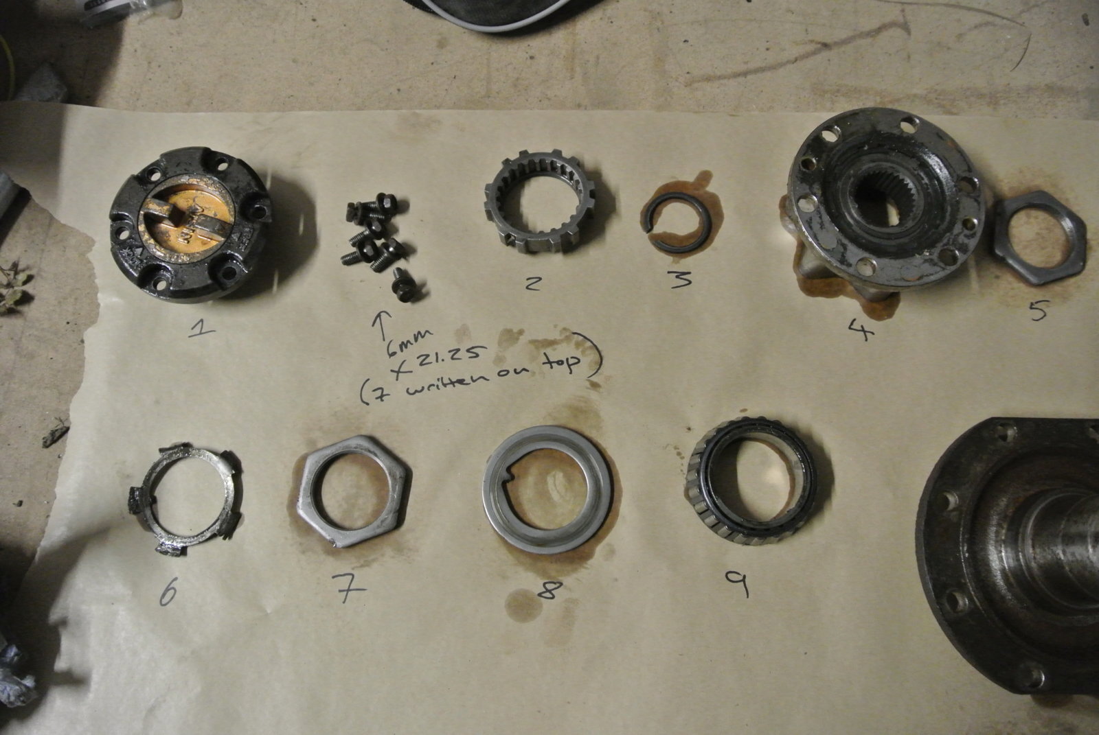

    Lots of itemising of parts, god knows I wouldn't remember where all them bolts came from.

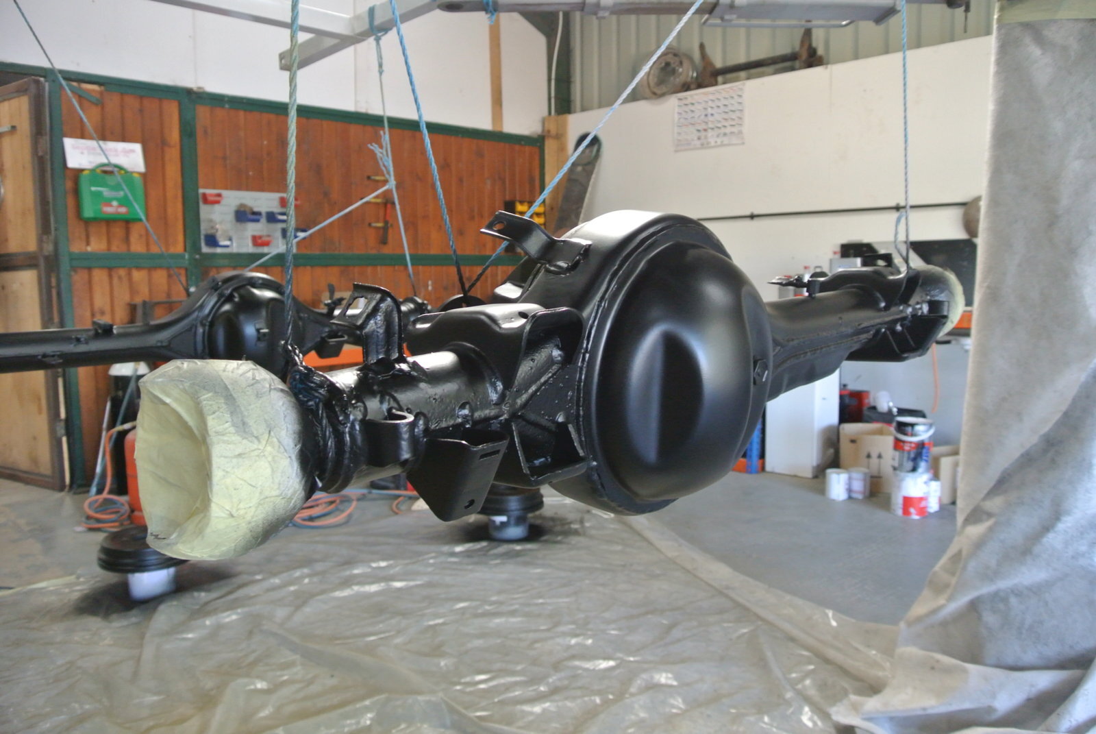

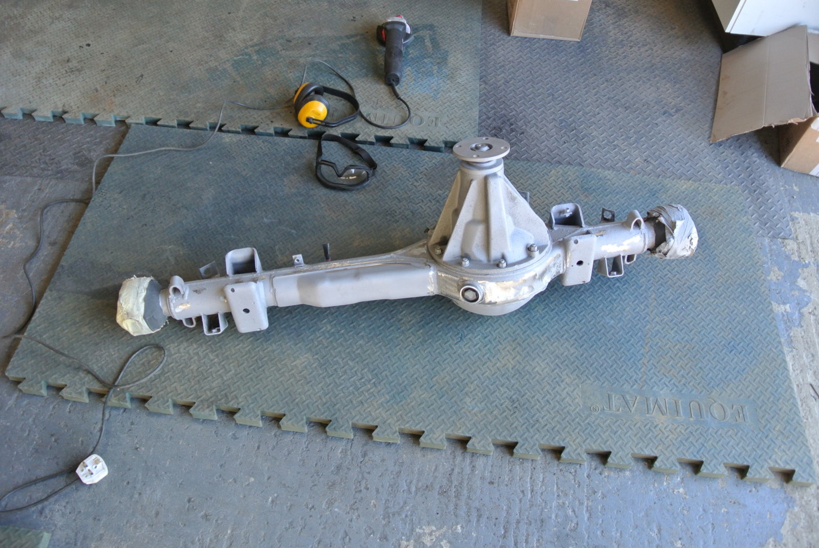

    Prepped and painted a few more parts trying to get as much painted before it gets all winter like.

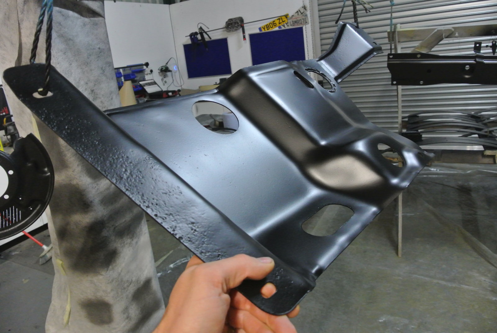

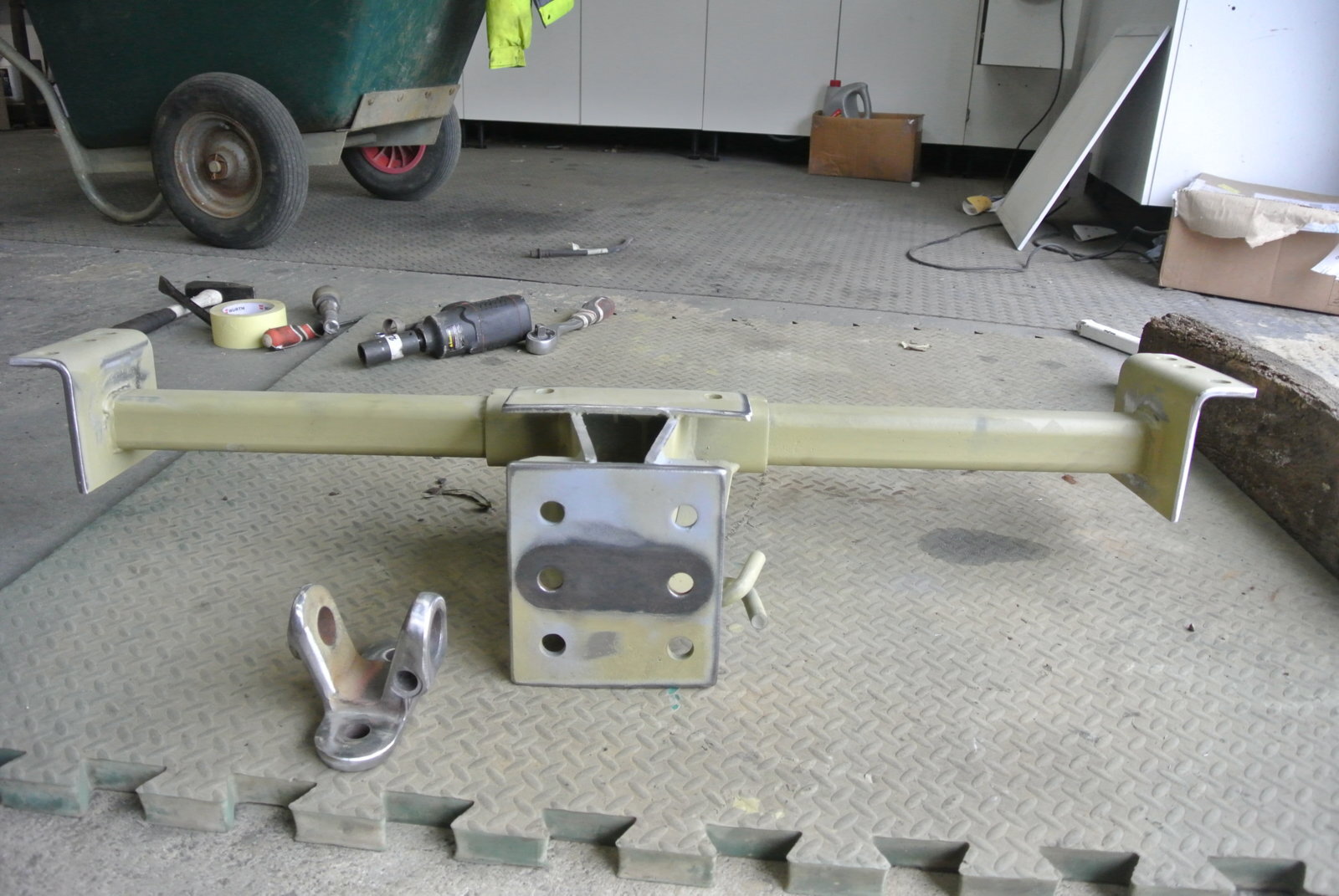

    Some Satin black

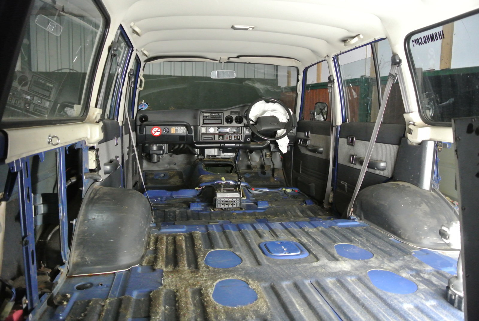

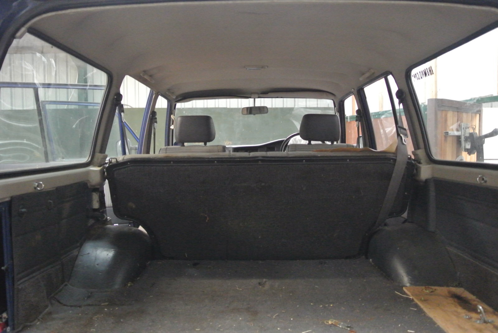

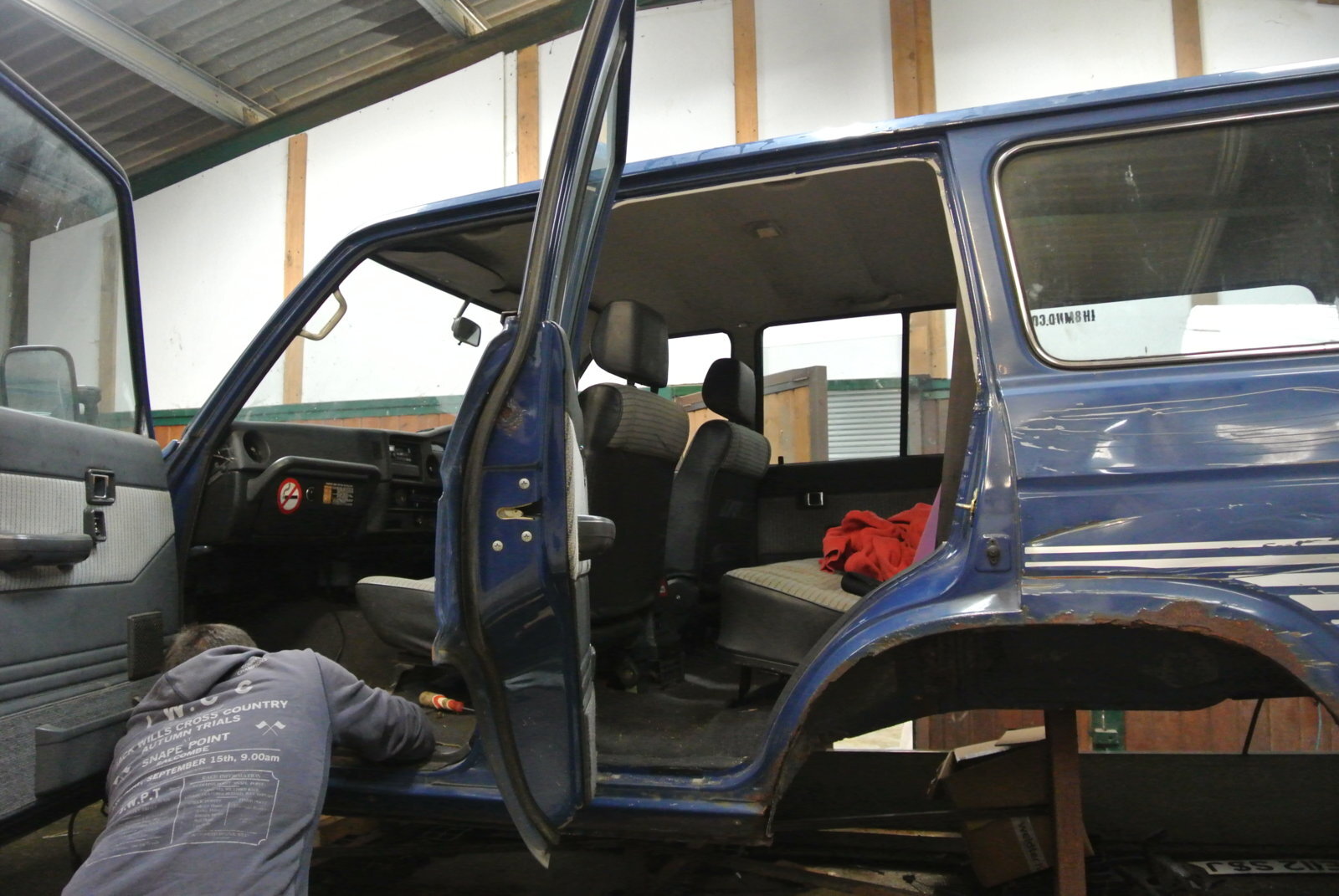

    Cheers Ben actually starting to feel like I've put a dent in the work know, a mate of mine popped round on the weekend and gave me a hand. He stripped the interior out whilst I did a bit of painting on yet more chassis parts... got to appreciate it when your mates don't mind giving up a Sunday to offer a hand, just got to convert him from defenders to a Toyota ha ha

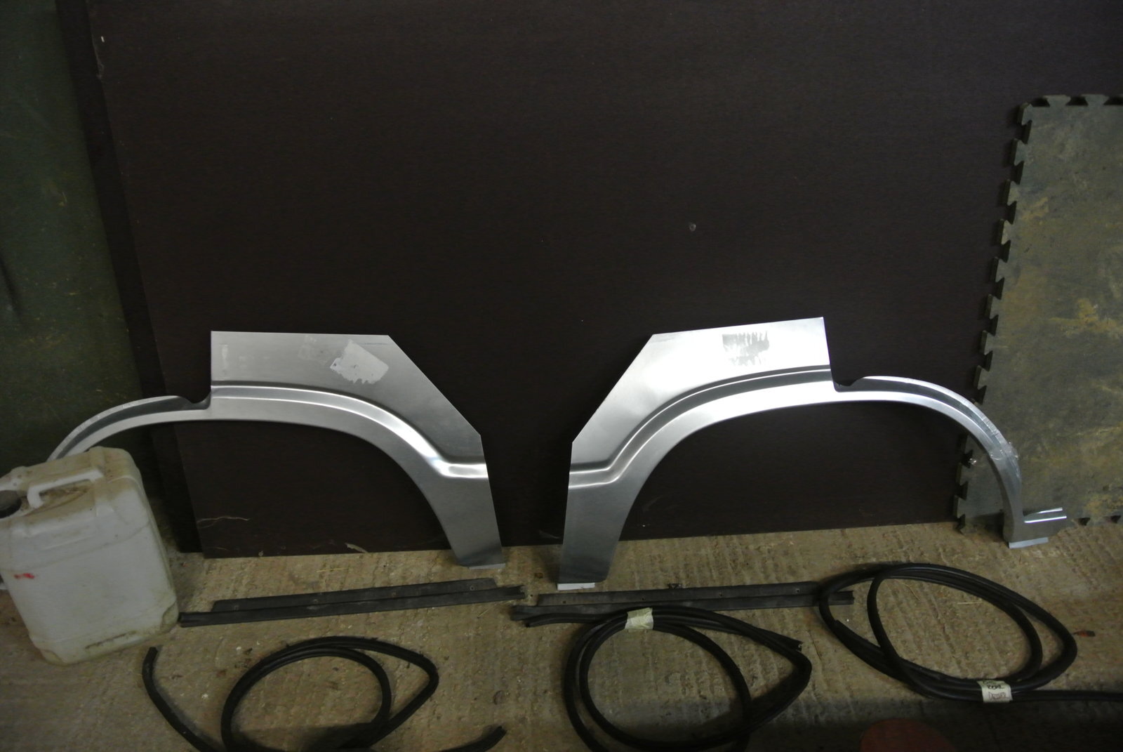

    ow and some repair panels arrived from cruiser world. Result.

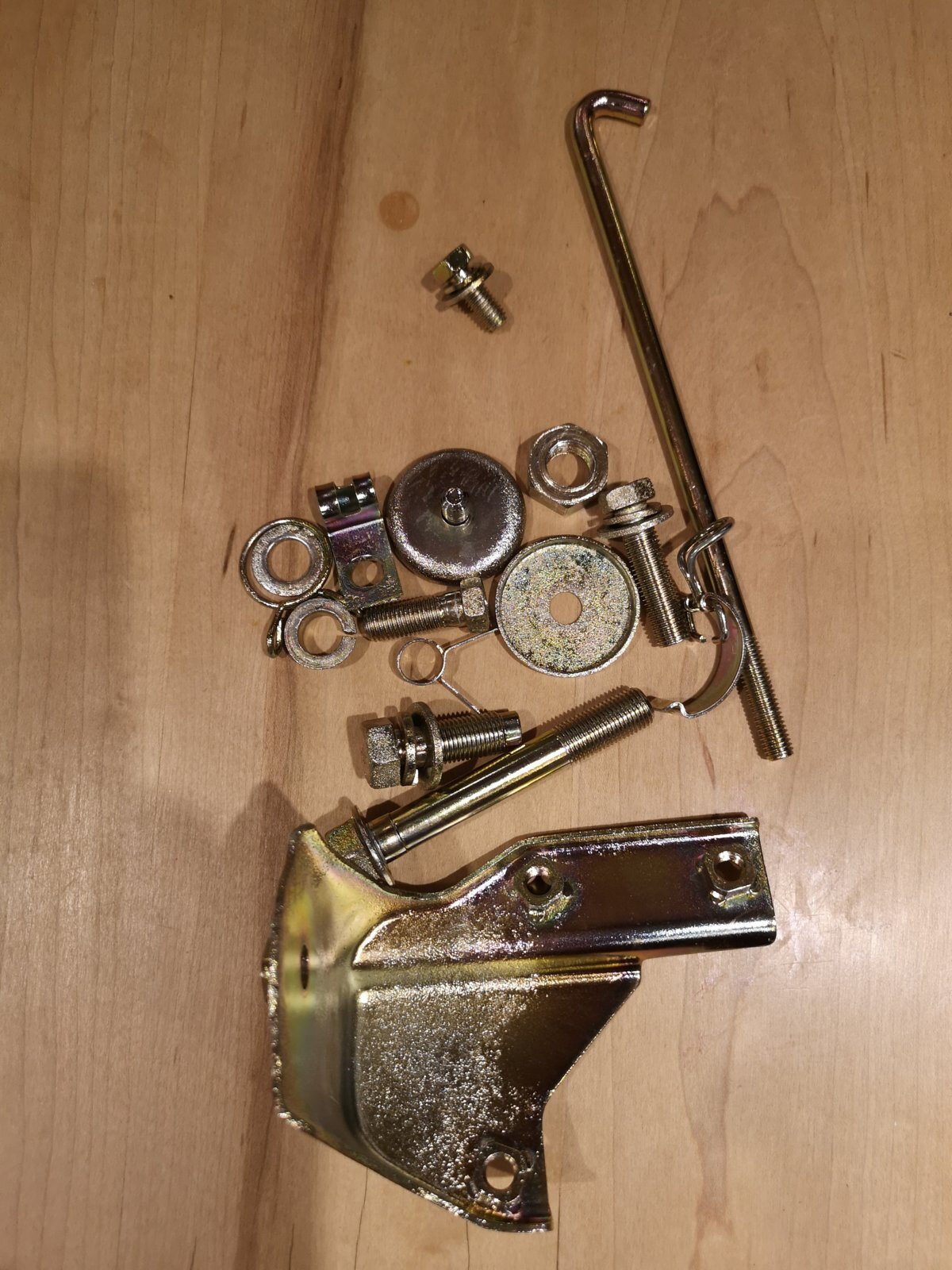

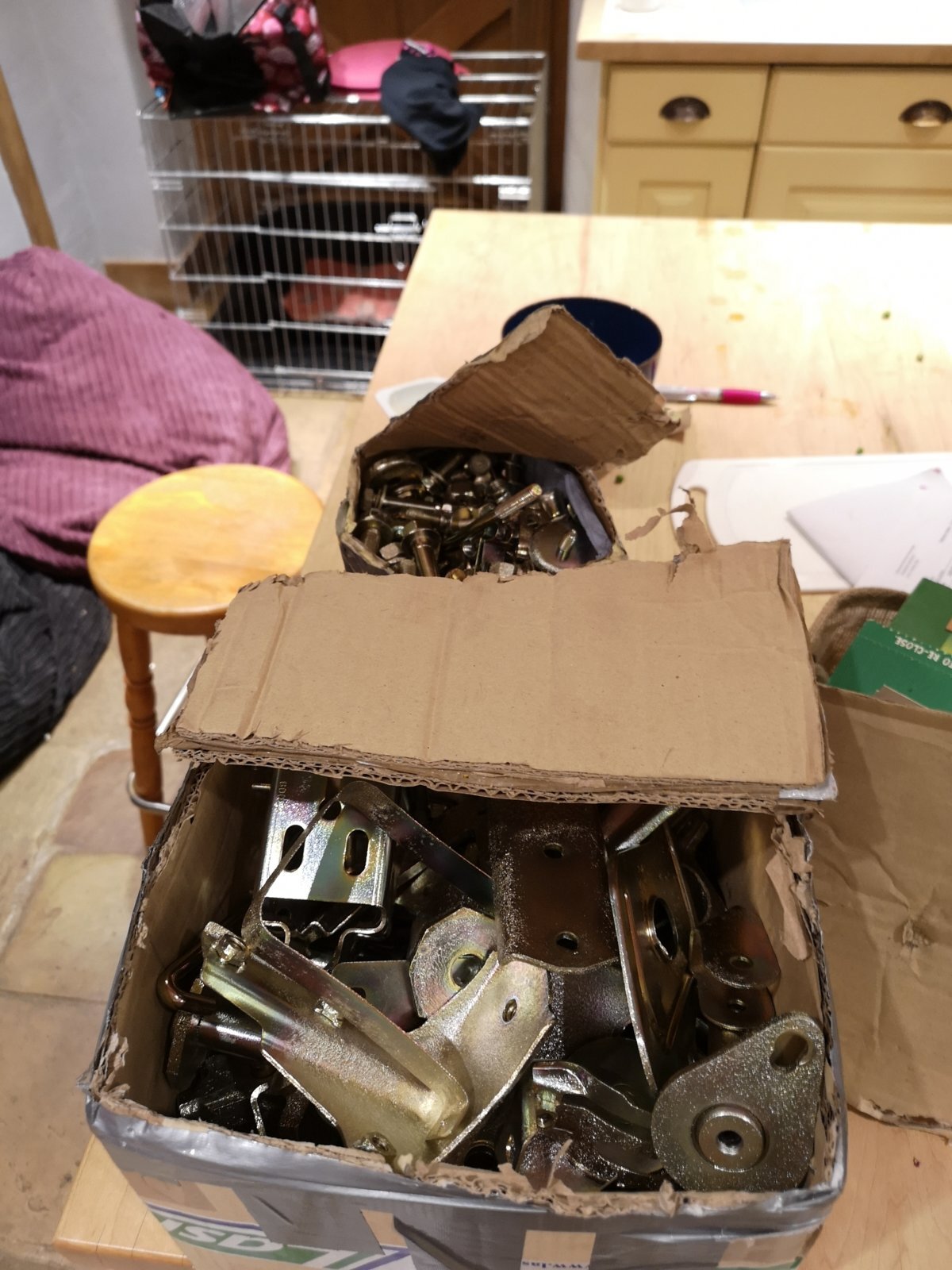

    Parts in the kitchen!! Many many bolts zinked the guys at reality motor works smashed the rusty out of the hardware. Kinda sad I know but can't stop looking at how shiny it all is

    Had the same rear wheel arch panels from cruiserworld, they worked well. Wish i had fitted a rubber strip to the lip once they were done to stop stones chipping the paint off Hayden.
    Also have a check under the back edge of the rear inner wheel arch under the vinyl cover, a common place to go too.
