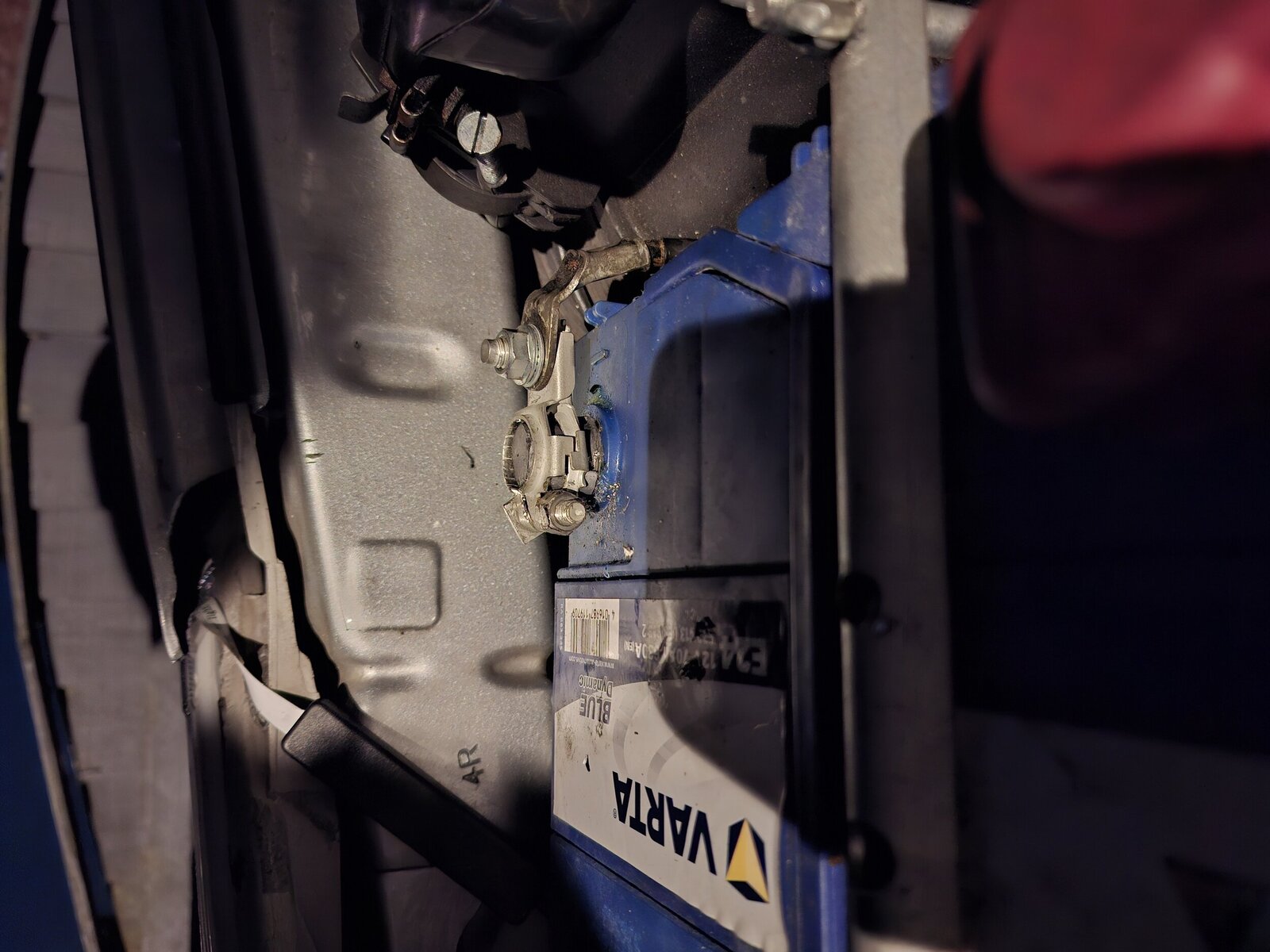

I think I found my problem as think it was my negative battery connection.
A few weeks ago it struggled to start as with a slow crank but after close inspection it was the negative terminal came off the battery so only running on one battery.

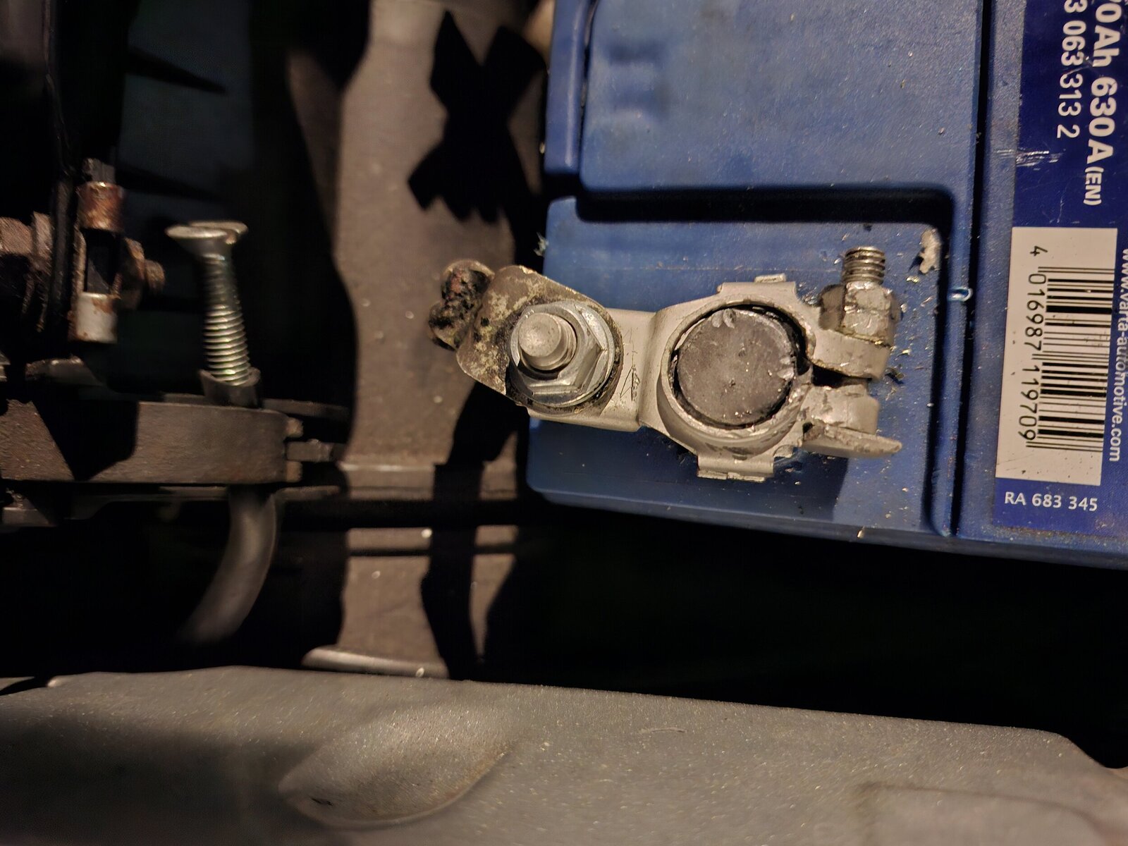

I inspected the terminal connection this time and was loose again even with a new terminal connection.
The problem is the battery terminals are very thin compared to a normal battery for some reason.
I bought spacers to fit on and then fit the terminal connection over it and tighten up.
It worked OK but and cranks fast as normal but I'm not 100% with the fit on the battery terminal.
Fingers crossed it stays on.

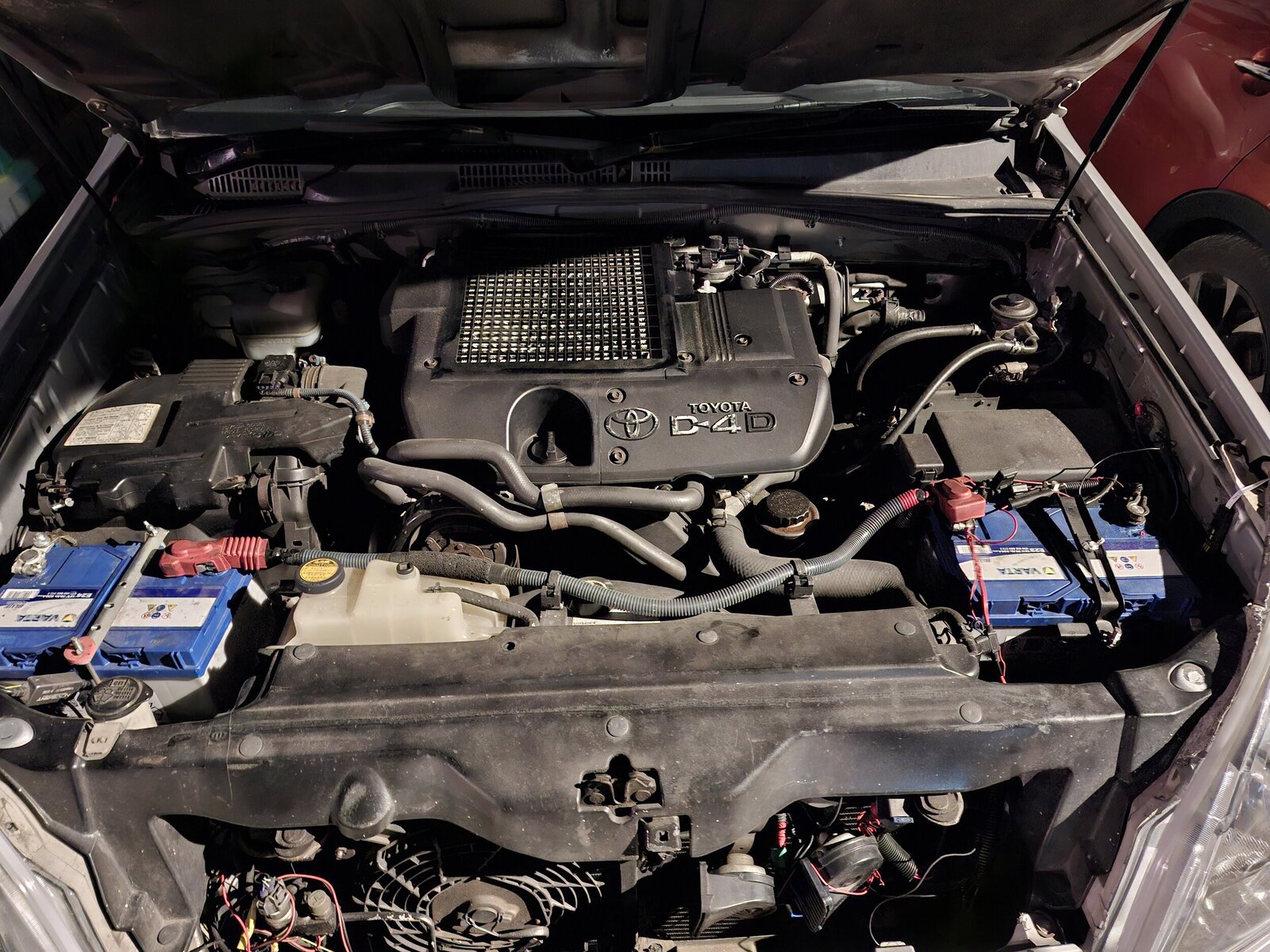

The battery's are a pair designed for the 120 with duel battery.
They are opposite to each other in respect to the terminals + - .

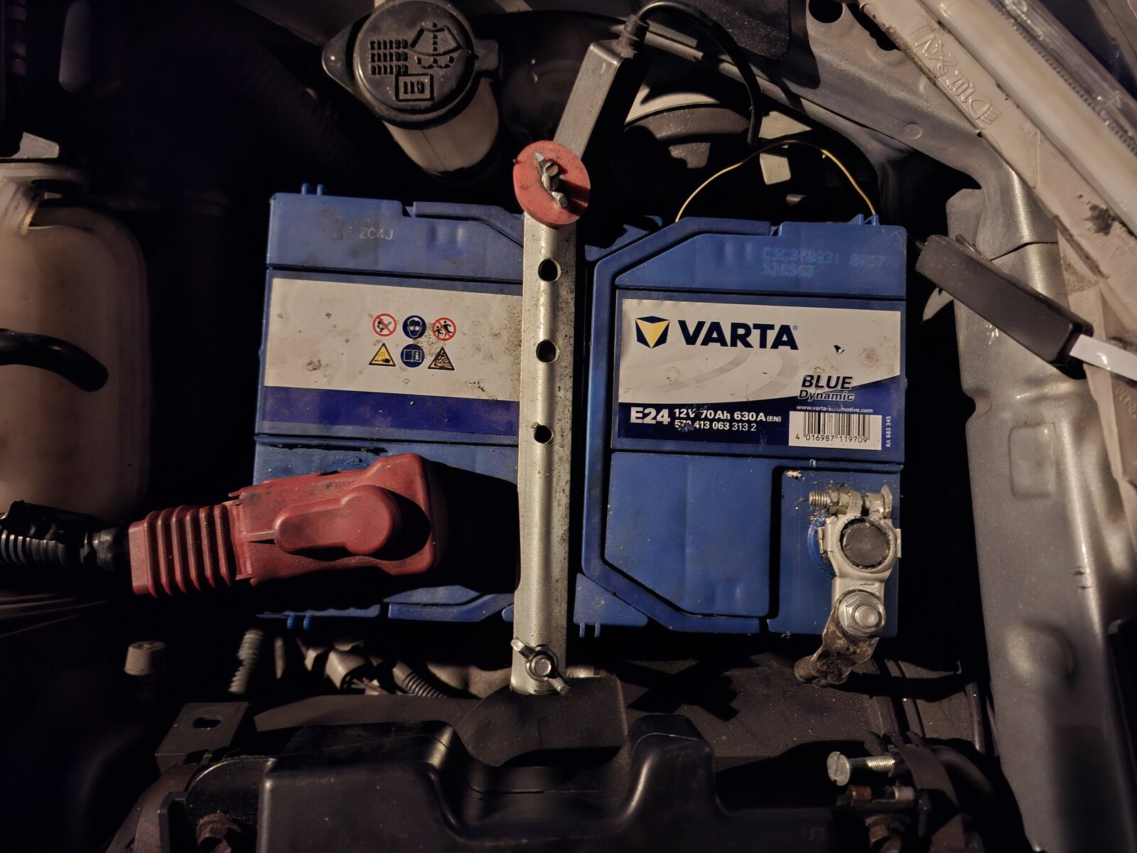

If you zoom in to the negative terminal you will see why in not 100% but tight for now.

Wonder if someone changed that clamp in the past and put the wrong one on.

I have changed it three times and sll to big.
Doesn't fit the terminal correct and once tight the clamp is closed fully but can just lift it off easy.
Even bought one from roughtrax and still to big..
It only seems to be the one terminal as all the others are tight.
In bought varta because i didn't much care about batteries and they were recommended on here but having learned some varta fit and thats about the be all and end all of their criteria .
Positive and negative clamps are sometimes different sizes and its clear as day from your pics that the clamps is to big . aint nothing special about them so take what you got to a local parts supplier and ask for a smaller one .
Or you can sleeve the terminal to fit the clamp - lots of batteries these days are supplied with smaller terminals and sleeves to oversize them, so they can fit different applications. Your local battery place will likely have sleeves (I've binned a couple off of batteries bought from Tanya mail order).
Negative terminal deffo needs sorting as you know! You should be able to start easily from one battery - when i did the same test on mine it pointed to the same dodgy -ve connection.

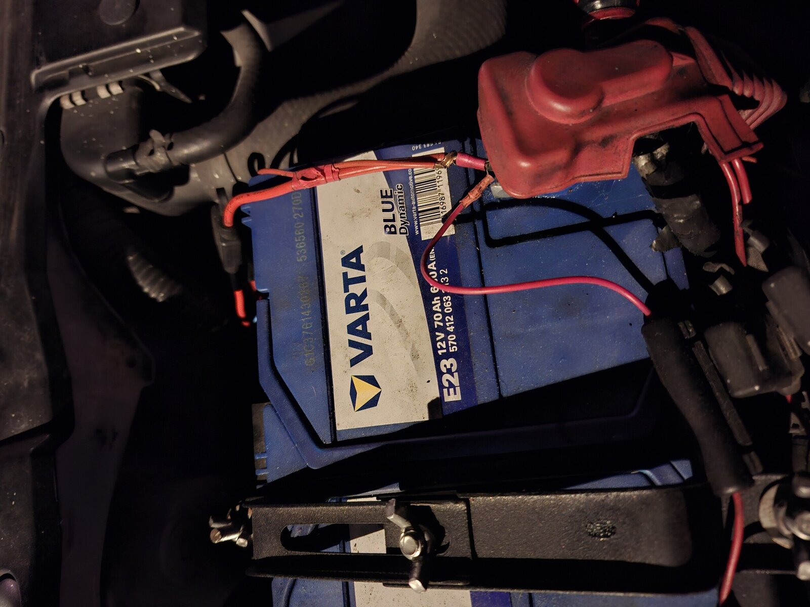

Stating the obvious but watch those bare live wires
