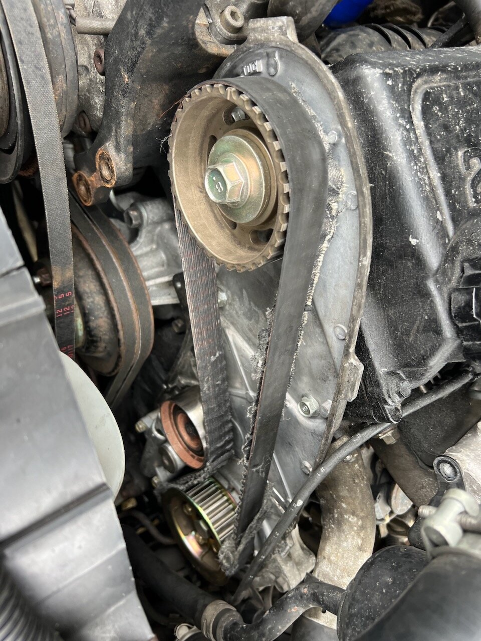

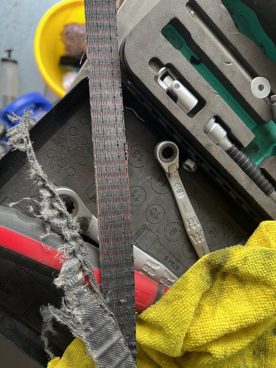

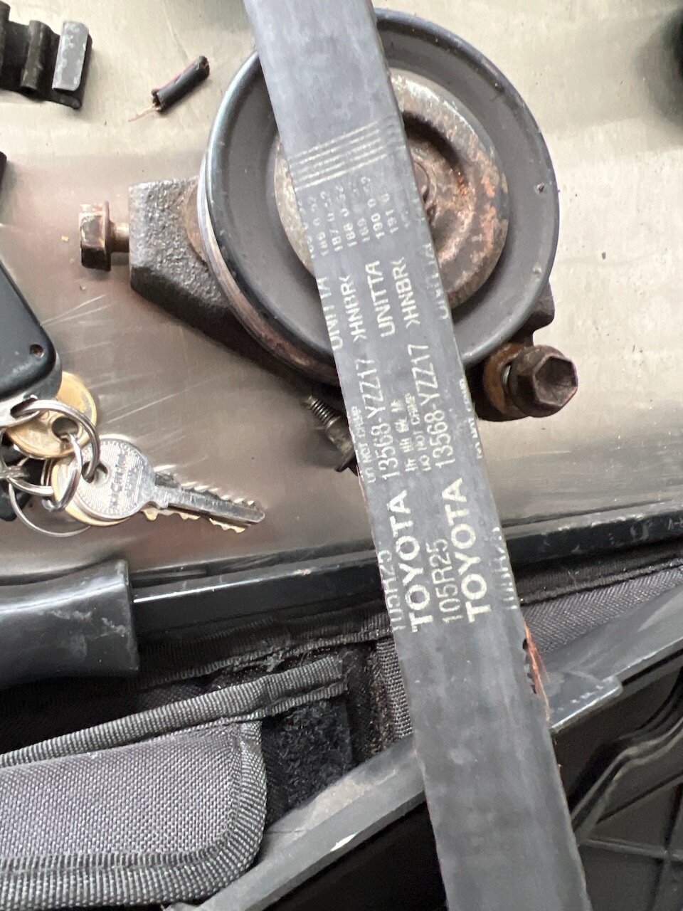

Got the cover off fully at least, camshaft turns over a few degree each way without issue so that didn't seize, tensioner pulley also moves freely as I've cut the belt off now.

Looks like simple belt failure to me based on the above and looking at the belt

Thats a very odd problem. Looks like a fault in the belt manufacturer to me. Or has the engine seized to cause the belt to shred its teeth. Worth getting receipt and speaking with Mr toyota
Engine cranks fine (not tested after realising the timing belt dun died), camshaft moves fine too. So nothing seized internally from what I can tell. I'm inclined to guess fault with the belt too at this stage. Will continue to poke and prod
I cant see all teeth coming off at once through faulty belt? A few teeth might come off causing a misfire and the driver to turn the engine off.
Not all the teeth have been stripped. But when it started losing power I got into a nearby layby and only turned the engine off once I was there, Hopeless joined me 10 minutes later and we tried to debug. We started and idled the car again at the side of the road before concluding it needed to be towed. Tis only once I got it back and in pieces that the issue with the timing belt was apparent

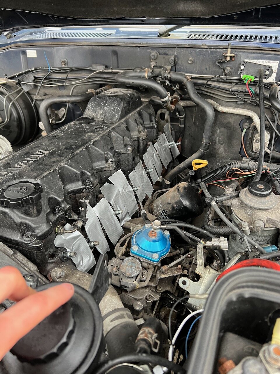

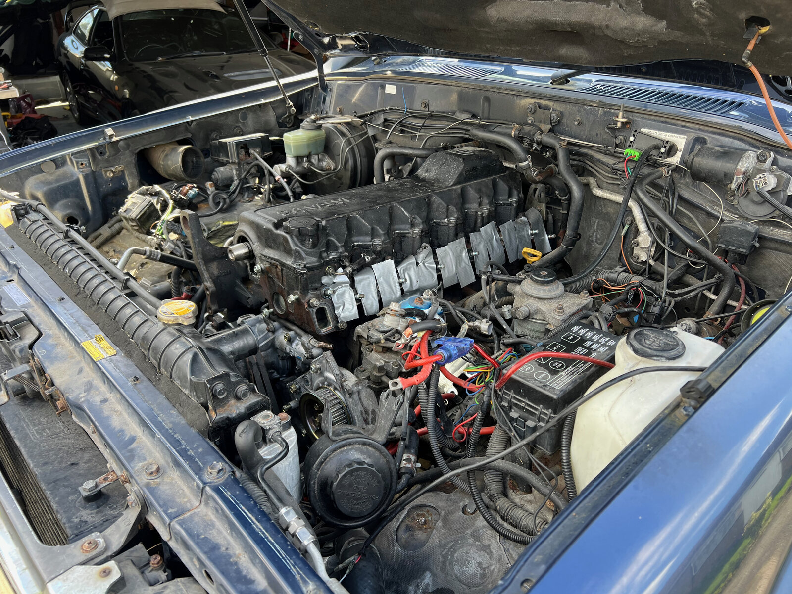

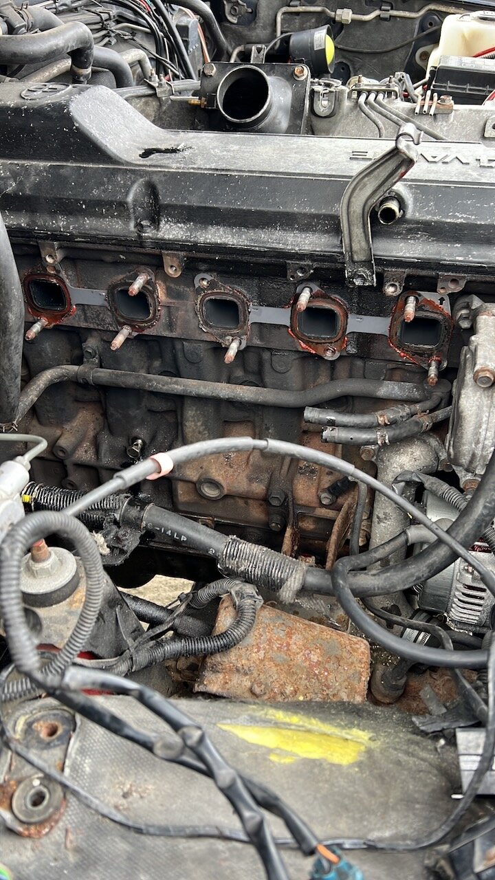

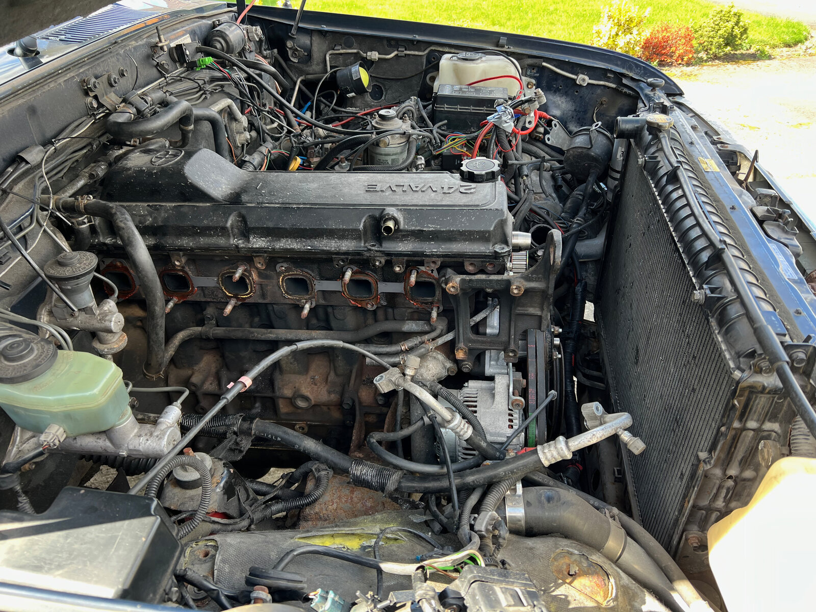

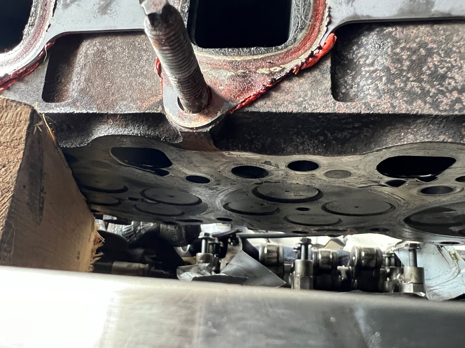

That's the intake and exhaust manifolds off. Not much left before the head comes off. That'll be tomorrow's job me thinks

That belt looks a lot older than the ones I've taken off mine at 60k miles each.

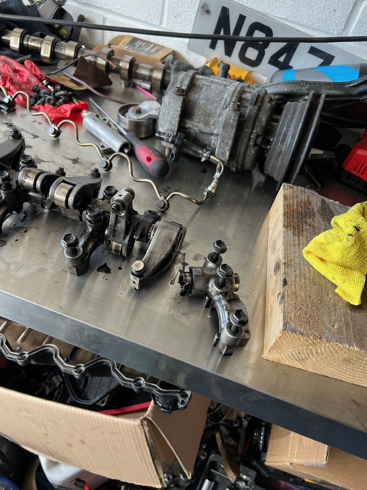

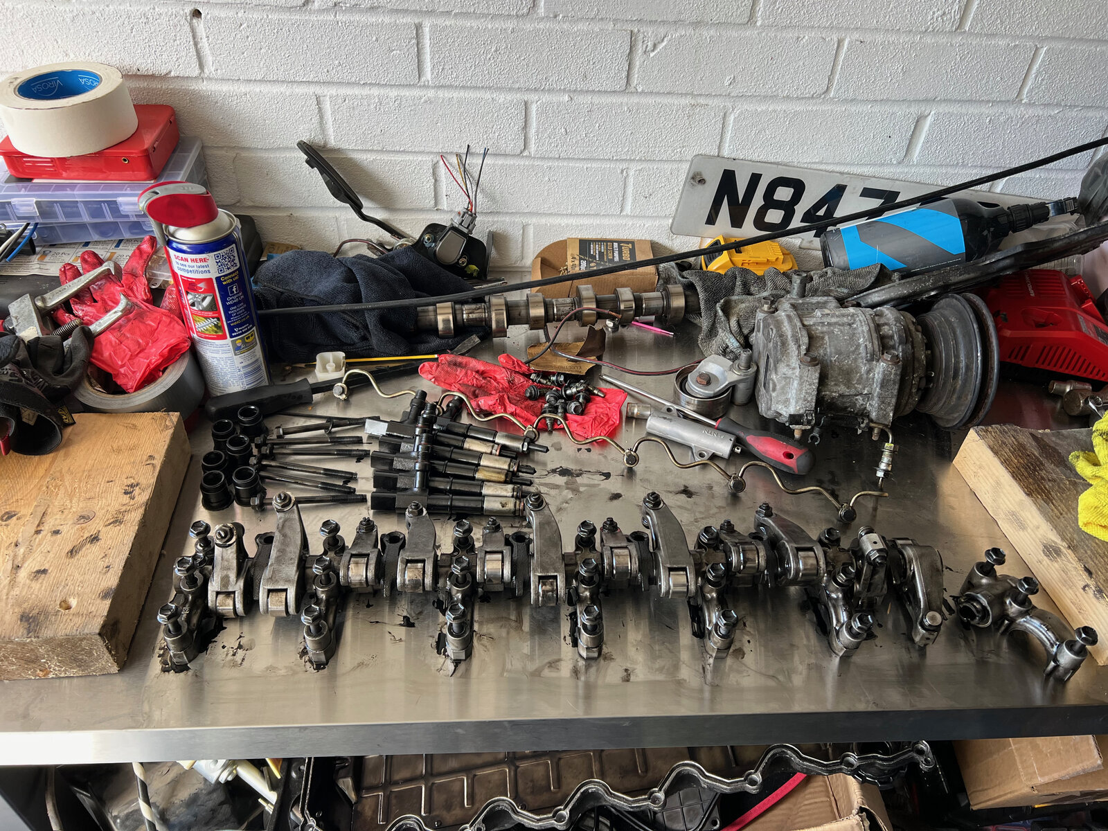

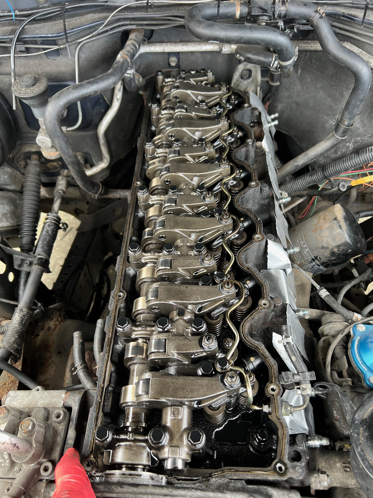

Stripped out the batteries, the fan shroud to get a two prong pulley on the camshaft pulley... Bah. More work required than expected apparently. Took the valve cover off and have pulled the "nozzle holder seals" ready to pull the injectors. Many of the rockers have play, some are solid still. Both play up and down (with the movement of the valve) and play side to side (parallel with the direction of the camshaft). We continue to await just what's happened internally
Man down, first obvious signs of something gone wrong

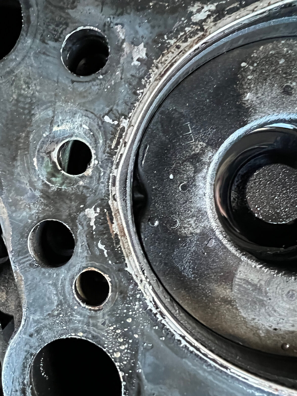

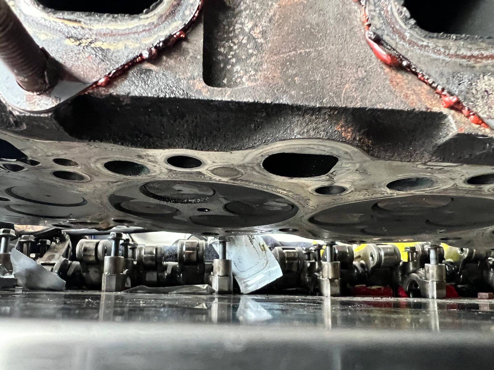

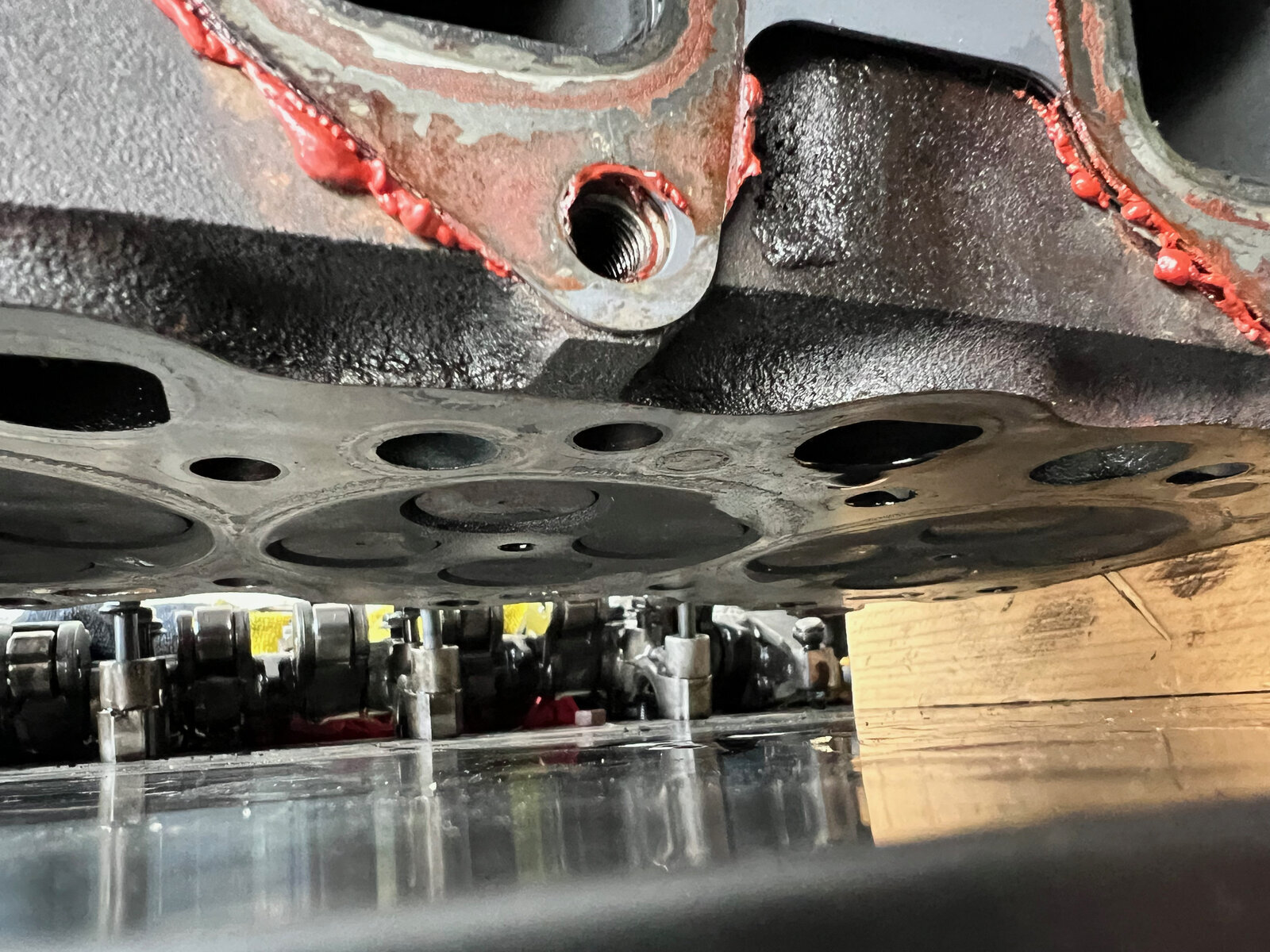

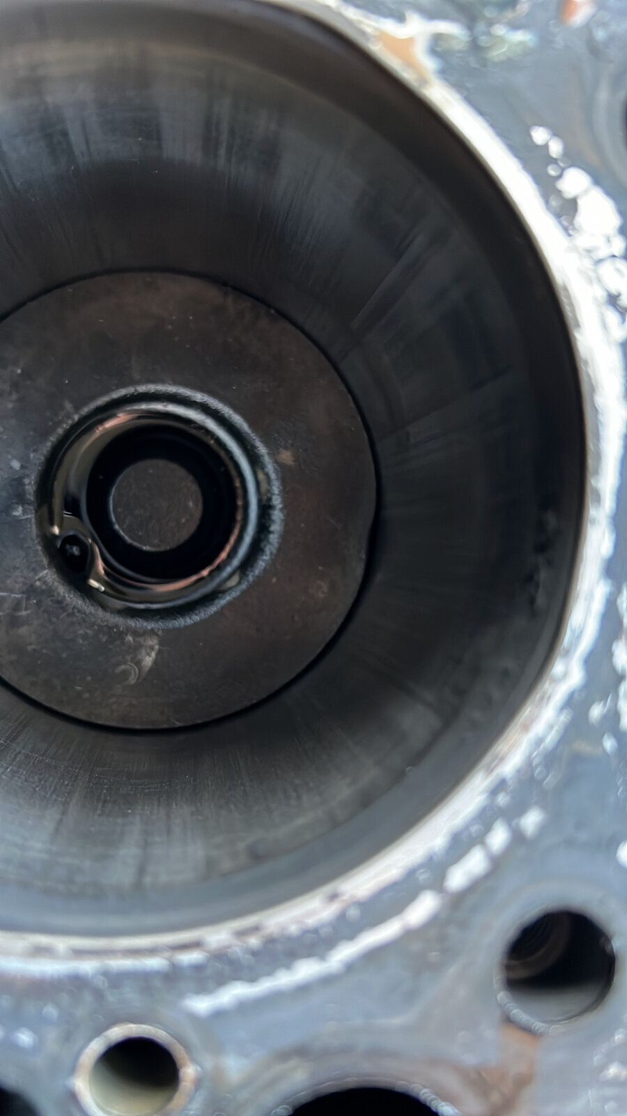

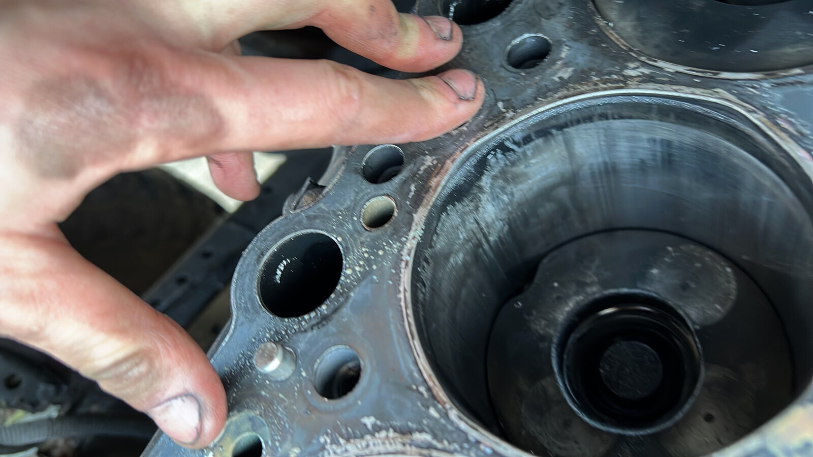

Head off. Valves impressively look fine. All pistons have feint valve marks... others however look fuggin' wrekt.
So that's been my weekend. How have all yours been? :tearsofjoy:
