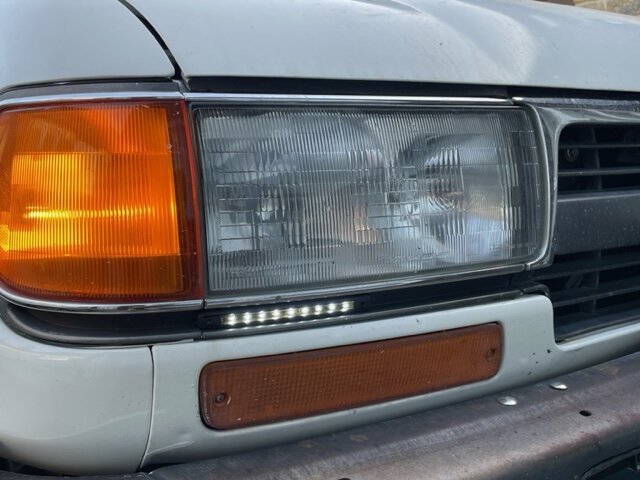

1) White parking lights on both sides

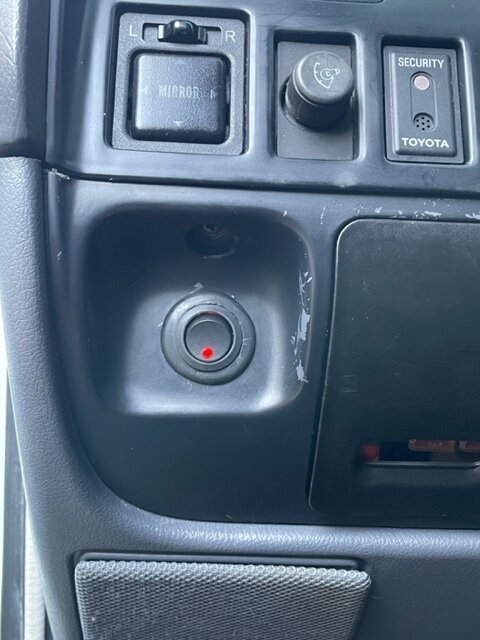

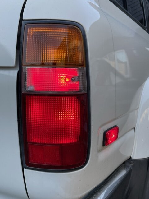

2 & 3) Rear fog Light -- basically a red LED in place of the white reverse light --and a switch

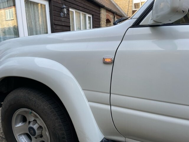

4) Side Turn Markers
