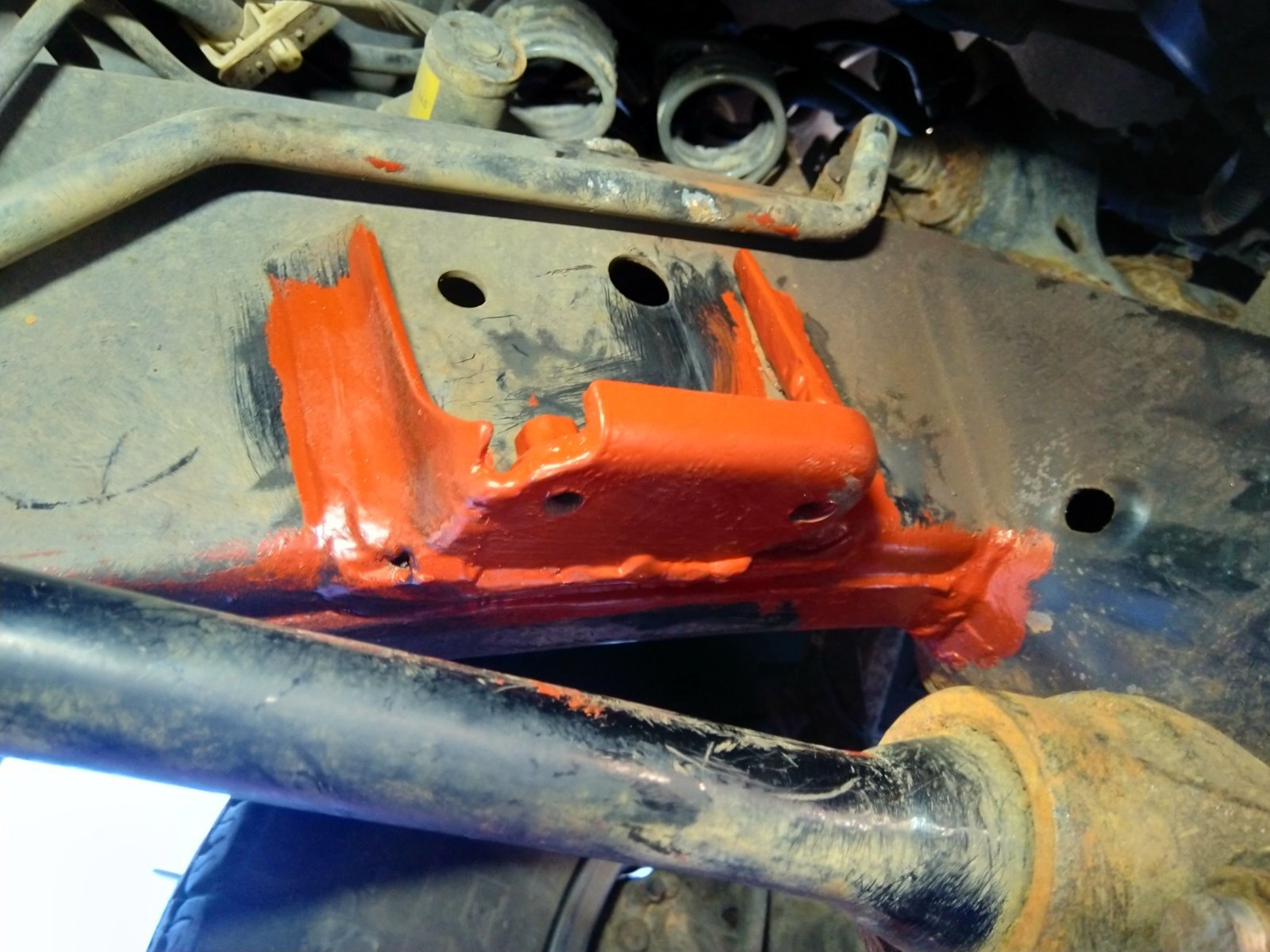

Yes I bought Toyota parts, I know they are expensive, but in many cases I think they just fit better. This started as a job to replace a broken link bar at the end of the anti roll bar and then I discovered the passenger side chassis mount had rusted away and was hanging loose. So now replacing both link bars and all the rubbers and washers along with the chassis mount bushes. Also had to weld on a new bracket to the chassis. Maybe doesn't look pretty but it's functional and strong
