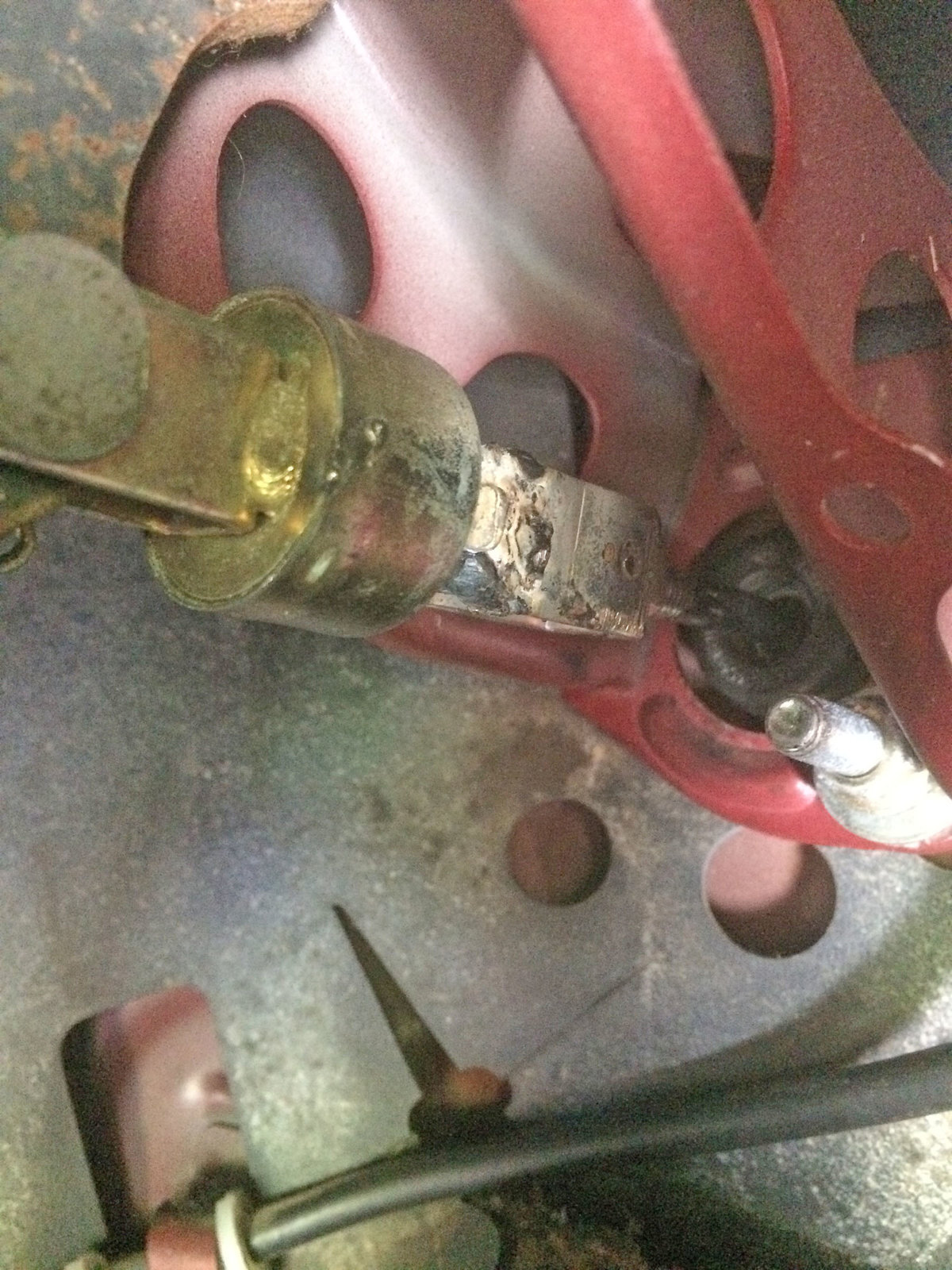

Had to replace my clutch master cylinder and having ordered the wrong one from the UK (an 88-90 instead of a 92) I thought I would see if a local shop had something that I could use. Yep incredible a positive match except, when I fit it the rod that attaches to the clutch pedal is too short. So decided to use a bit of Caribbean bodge and got a guy to weldthe two ends of the adjustable part that fits the pedal. One from the new to one from the old. I now have a proper functioning clutch. Engineering here in Grenada is like being in a Mad Max scene. Still it works.
