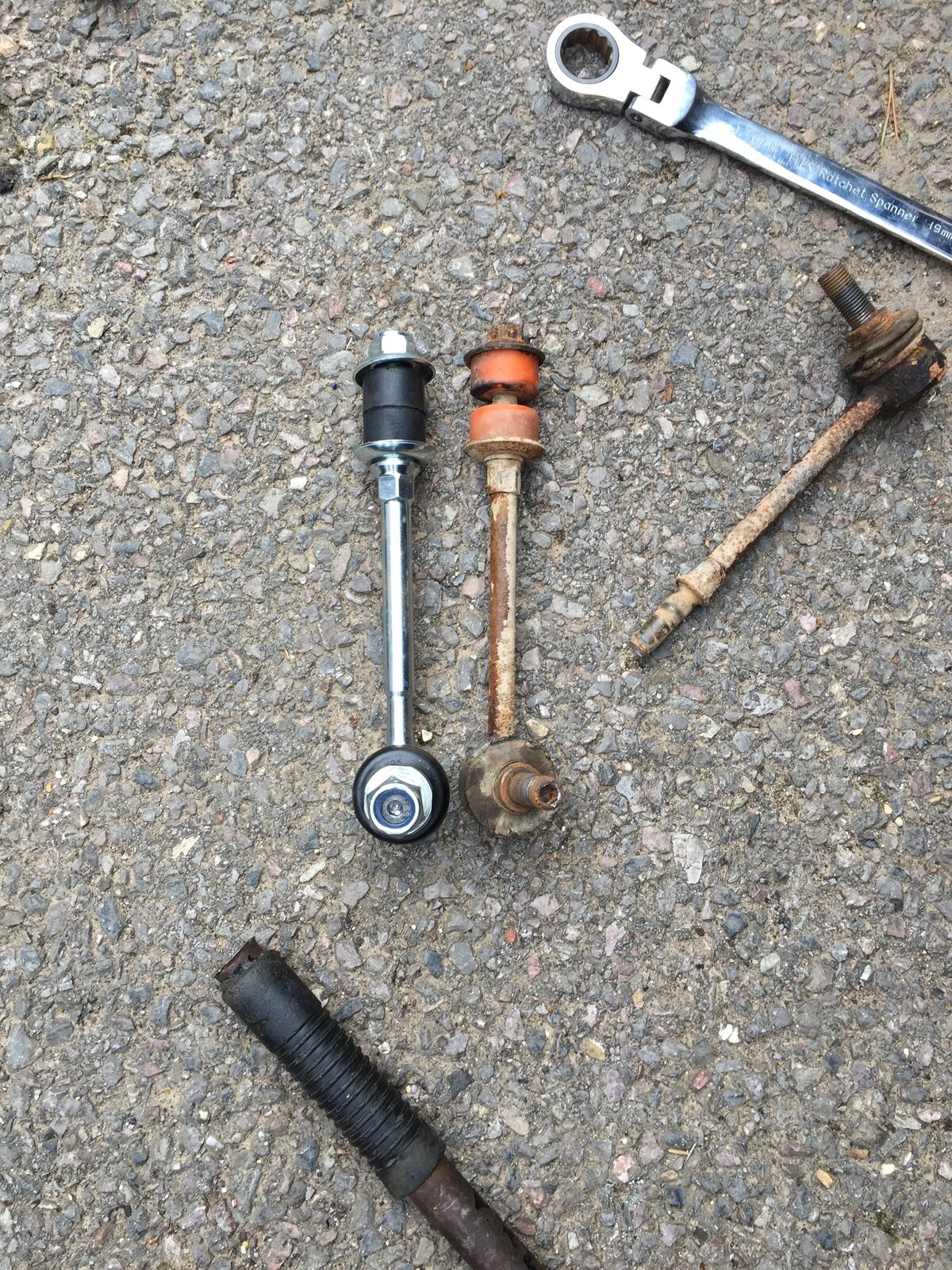

standard Toyota links against Roughtrax ones I fitted last summer

In my photo, the old link has Milner bushes on the top, probably 2 years old, there were ok but had gone very hard and deformed. Thrown them in my spares box just in case.
The Roughtrax links have a thicker shaft (oo-er) than the standard Toyota ones so in theory should be stronger. When I swapped them last summer the Toyota ones had done over 160k miles and only needed the top bushes replacing prior to the bottom joint failing on MOT. The new RT ones have only done 5K miles so it's a bit early to tell if they will last a similar distance.
