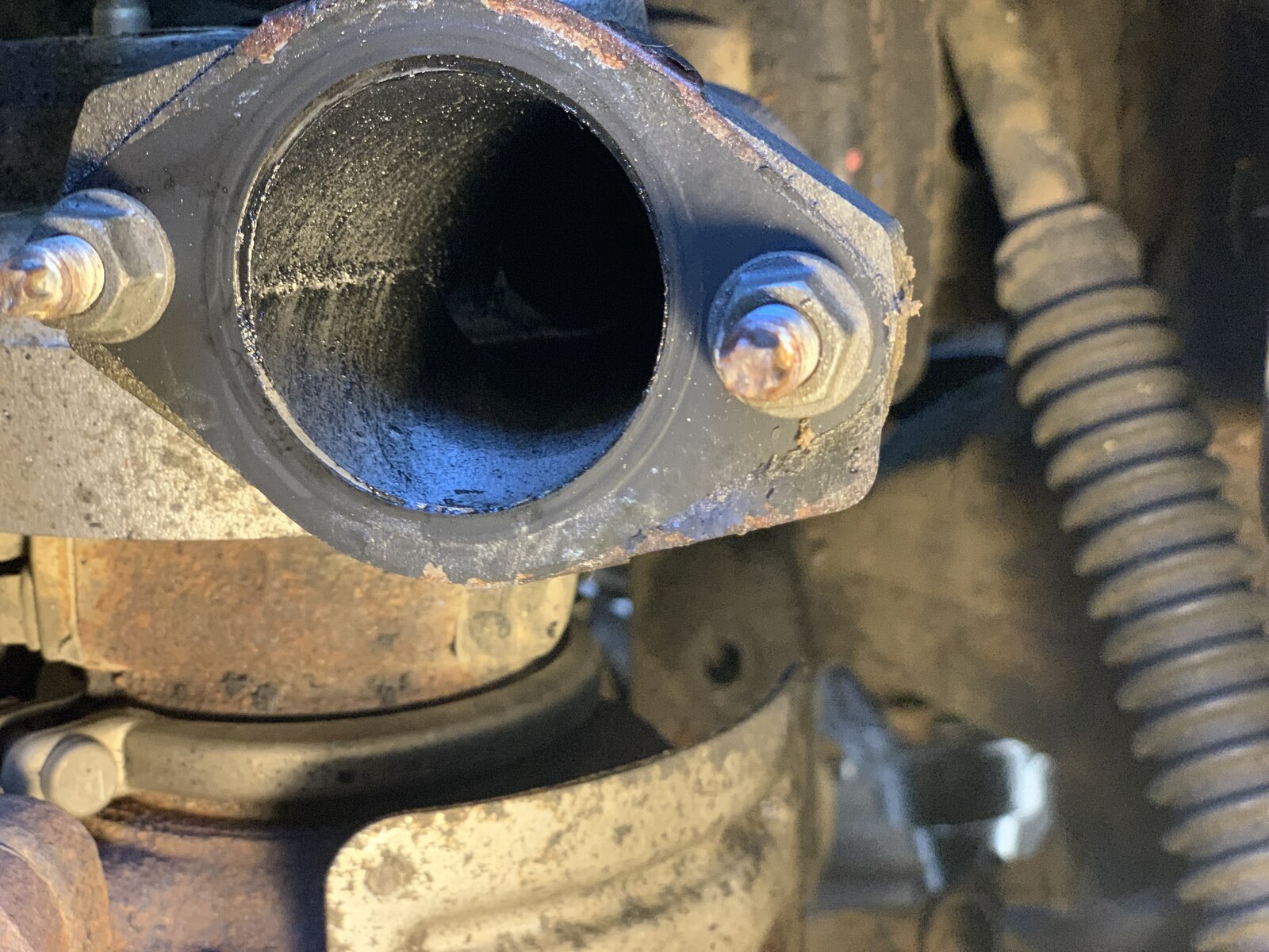

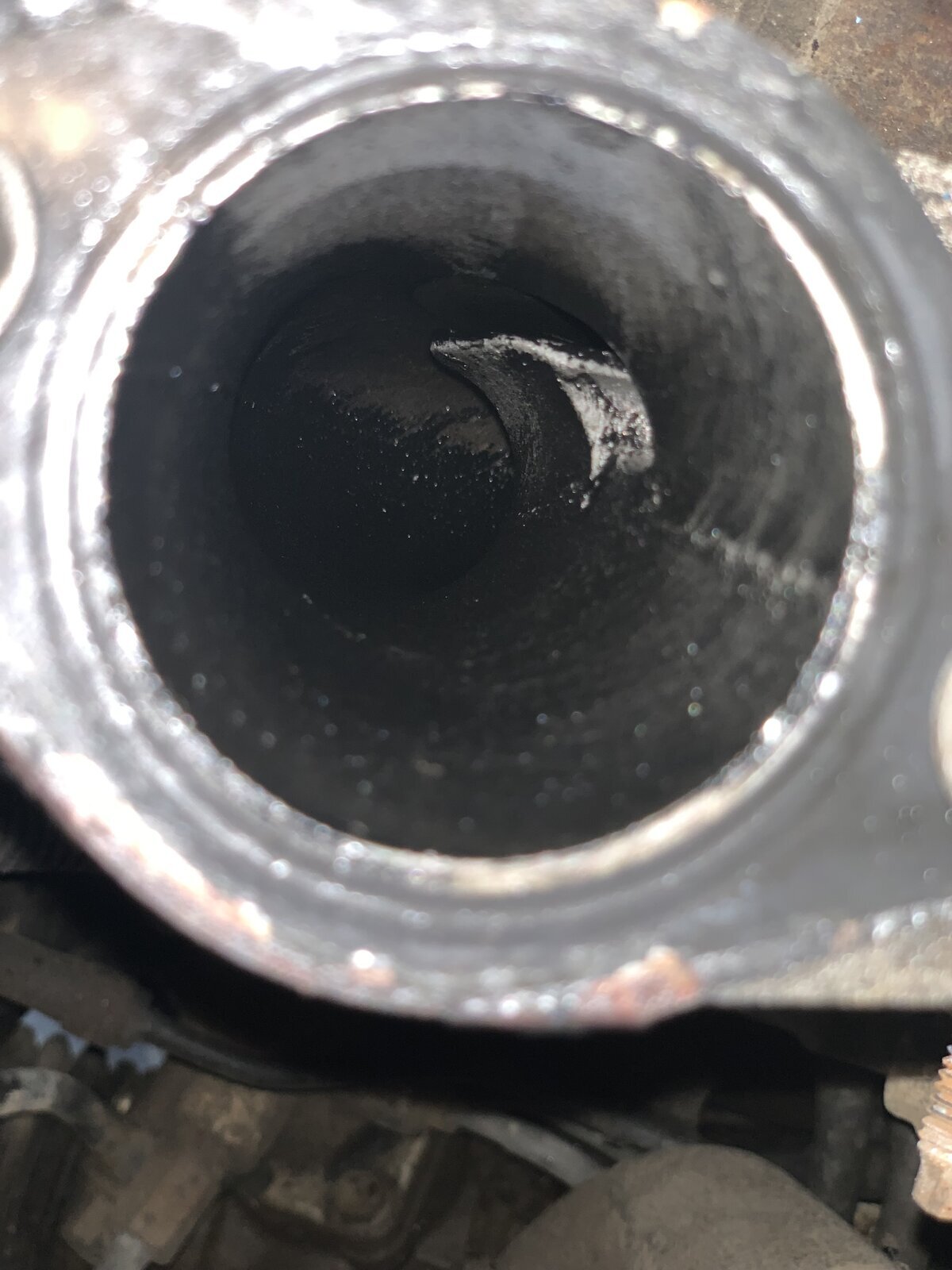

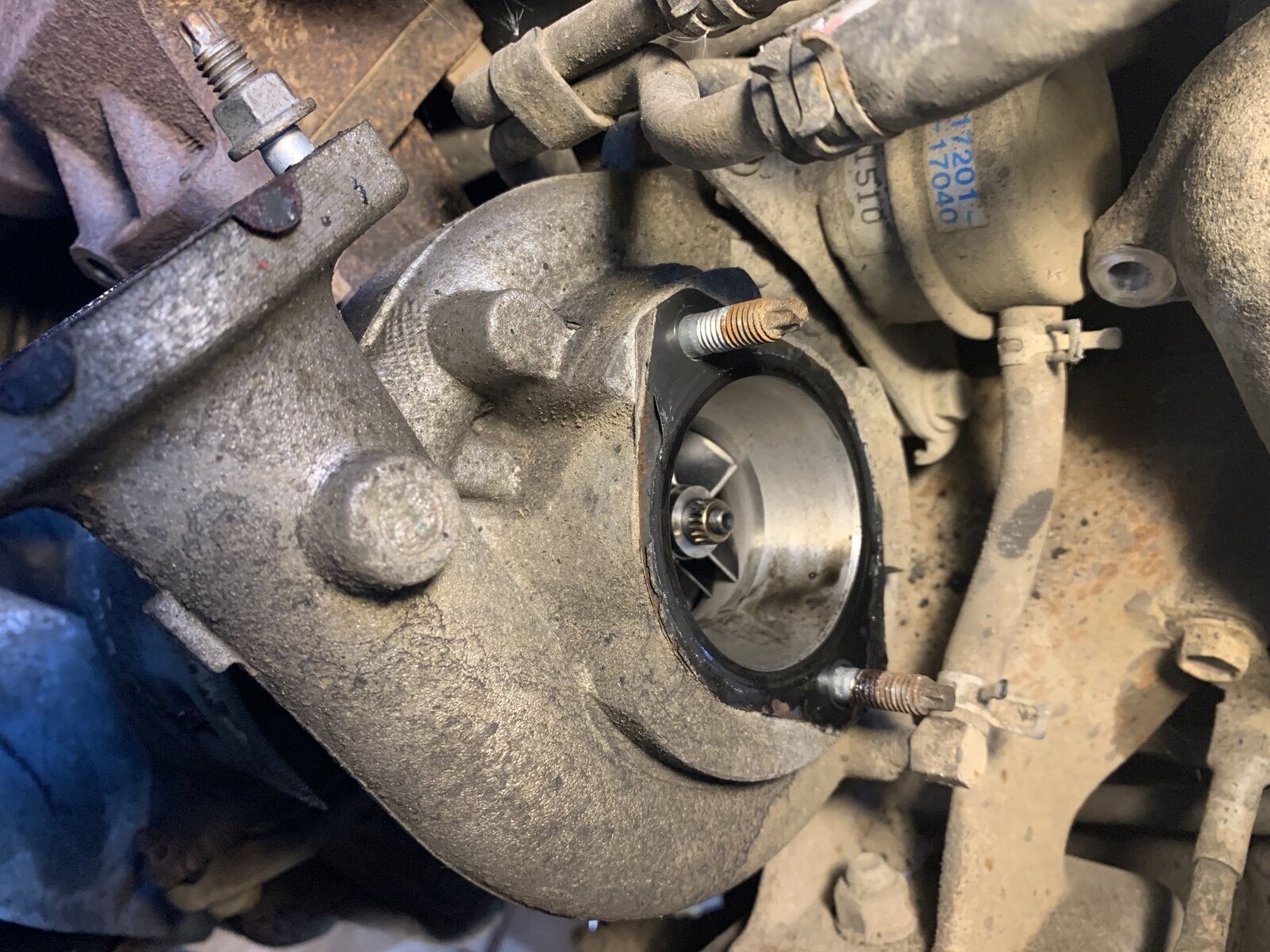

This what it’s looking like ..maybe just seals gone??
You were right im having to remove the exhaust mani …!!
