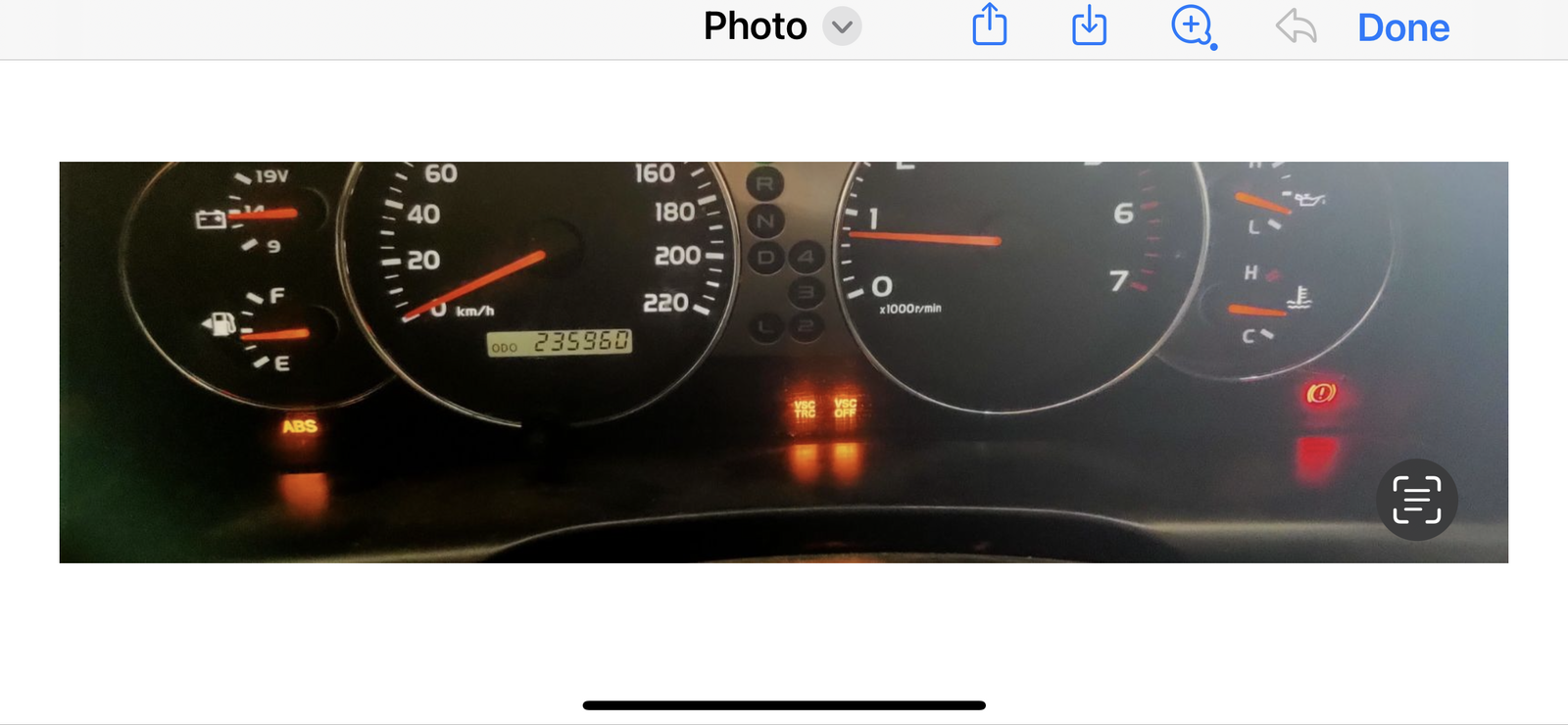

I thought I would treat the old girl and have a new stereo put in her about 12 months ago. When I picked the car up there were a few lights on.
ABS, Stability Control Warning, and a couple of others, the company that put the stereo in has had the car for the last 12 months trying to find the problem.
We now have a new CPU, Transfer case switches all three, the wiring harness has been gone through, the fuse box cleaned, the dash checked, and the list goes on. And several people look at it.
But still, the dash lights remain on. It’s a 2004 Land Cruiser Sahara done about 250000 kays. I have owned it for about 15 years with no issues until we replaced the stereo. Has anyone had this problem before?
Dash lights are ABS, VSC, TRC-VSC OFF
Dash lights are ABS, VSC, TRC-VSC OFF and View attachment 332888
Some of the codes he said he was getting like wheel speed sensors, faulty throttle position sensors, catalysts, system outside parameters all sorts of crazy stuff.
replaced all three transfer case sensors. no change even sealed the fuel filter no change.
all he did was replace the stereo. Toyota had a look at it and couldn't find it either. replaced the ECU, Checked all the earth wiring as well.
We could do with the actual codes and the real detail on what exactly has been done...
