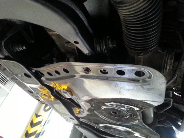

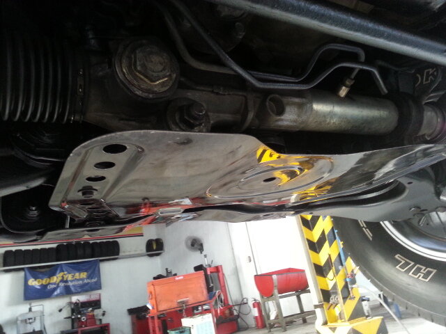

1. It happens during parking when the car is moving really really slow.Something like 1-3 kph. The sound could be heard when I turn the steering wheel(even slightly) to the left or to the right, when going either forward orbackward;
2. The sound goes something like 'kroog kroog kroog kroog' and it goescontinuously as the wheels turn. The sound seems prominent at the back part of the vehicle;
3. I am a newbie with 4wds but after some googling on the net, I also readabout CV joints thinking that it may be the possible culprit. However, I lookedat the CV boots but they all seems good;
4. It does not sound as I steer. It makes the sound asthe car rolls. Do you still think it is the power steering?
5. It does not make the sound when going straight (eitherforwards or backwards);
6. It makes thesound when I steer startingaround 40 degrees either to the left or right, the sound stops when my steeringreaches 180 degrees OR when I accelerate and go 15 kph and faster;
7. The sound occurs even when slightly stepping on the brakesor slightly engaging the hand brakes;
8. The sound occurs even when I have the car on neutral - aslong as the car is running slowly and the wheels turned either left or right;
9. The sound occurs regardless whether I have it set on LL, HLor H;
10. Rear diff is not locked but I feel a slight resistance whenI start to turn it.
