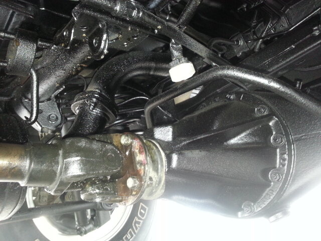

I might get this wrong coz i'm going from memory but somebody is sure to quickly correct me if i am . If you jack a back wheel up , and disengage the handbrake you should be able to turn the back wheel by hand . If the diff is engaged you won't be able to turn it because it is locked to the other 3 wheels which will still be on the ground .
Put the small gear lever in HH and make sure the electric diff switch to the right and below your steering wheel is turned off .

Well sorry mate its after midnight here and i'm off to bed but nevermind we have ruled out locker problems , so maybe tomorrow we will work out its wheel bearings or something else .
