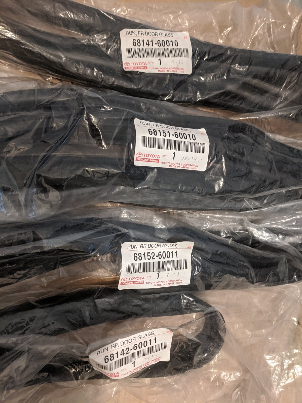

I received:
2 x 68141-60010 RUN, FR DOOR GLASS
1 x 68152-60011 RUN, RR DOOR GLASS
1 x 68142-60011 RUN, RR DOOR GLASS
Cheers
Greg
Found a button so picture attached
There's four different part numbers. Front LH/RH and Rear LH/RH. That's right isn't it? :think:

forget the FR,FR,RR,RR.
go off the part numbers. what you have is correct.
Hi Chaps,
I did not want to open the packing so that I could swap or sell them but having unpacked them I can see that you are correct and they are "handed" correctly
It was the FR & RR on all of them that made me wrongly assume they were all for the right hand
Thank you all so much for your help and good advice
