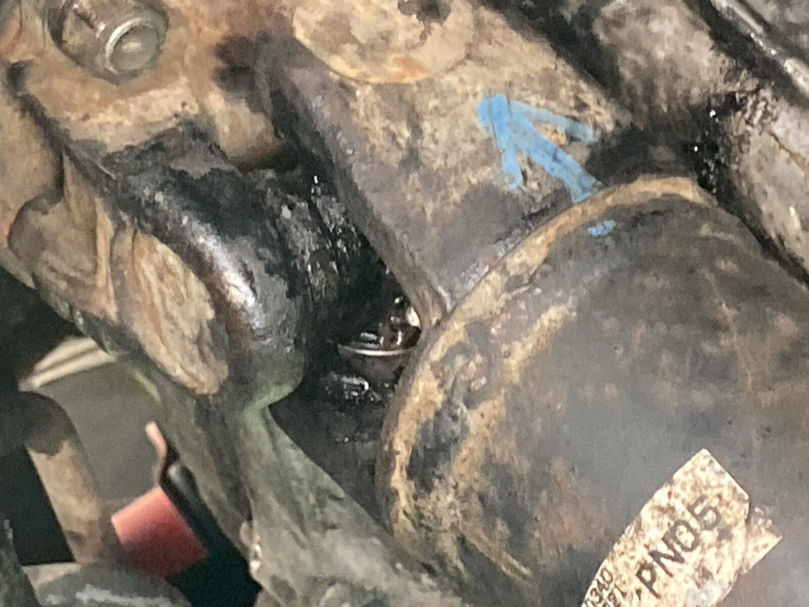

I've noticed a small bit of oil on my driveshafts - pics below - is this normal, or does it suggest a seal is gone/going? - I was looking at them to possibly regrease to reduce difflash As per this video using the Mercedes grease -https://www.youtube.com/watch?v=URl7Y93XWtQ)

That is the slip joint on your propshaft. It's not oil, it's grease and don't worry it's supposed to be there. When your axle moves up and down, the length of the propshaft changes and this sliding joint makes up the difference. It needs to be greased but NOT a lot. There should be a greasing point on the other side. People pump too much grease in there which makes it solid. It's perfectly normal for a bit of that grease to get squeezed out down the splines as you can see in your pictures. The high and low marks you can see are the ends of the travel that happen when the axle moves up and down.
Agree with Chris. On a slightly different note, same thing with the universal joints. Make sure they are greased and showing a small amount of grease showing around the joints after being greased.
I wipe away any excess once greased, saves it being flicked under the truck. Done mine this morning and after a new UJ fitted last week.

That's normal , as others say don't over grease them ...2 to 4 pumps of the grease gun will be more than enough ...

Never heard anyone suggest that it reduces backlash. Backlash in what? The splines do wear usually due to not being greased of course. They get sloppy (rotationally) and there's no fix. Let alone greasing them. People do pump them too full and that leads to diff seals being punished. Cure usually is just to unscrew the grease nipple and let the natural pressure push out any excess grease.
Great tip to reduce pressure due to excess grease.
