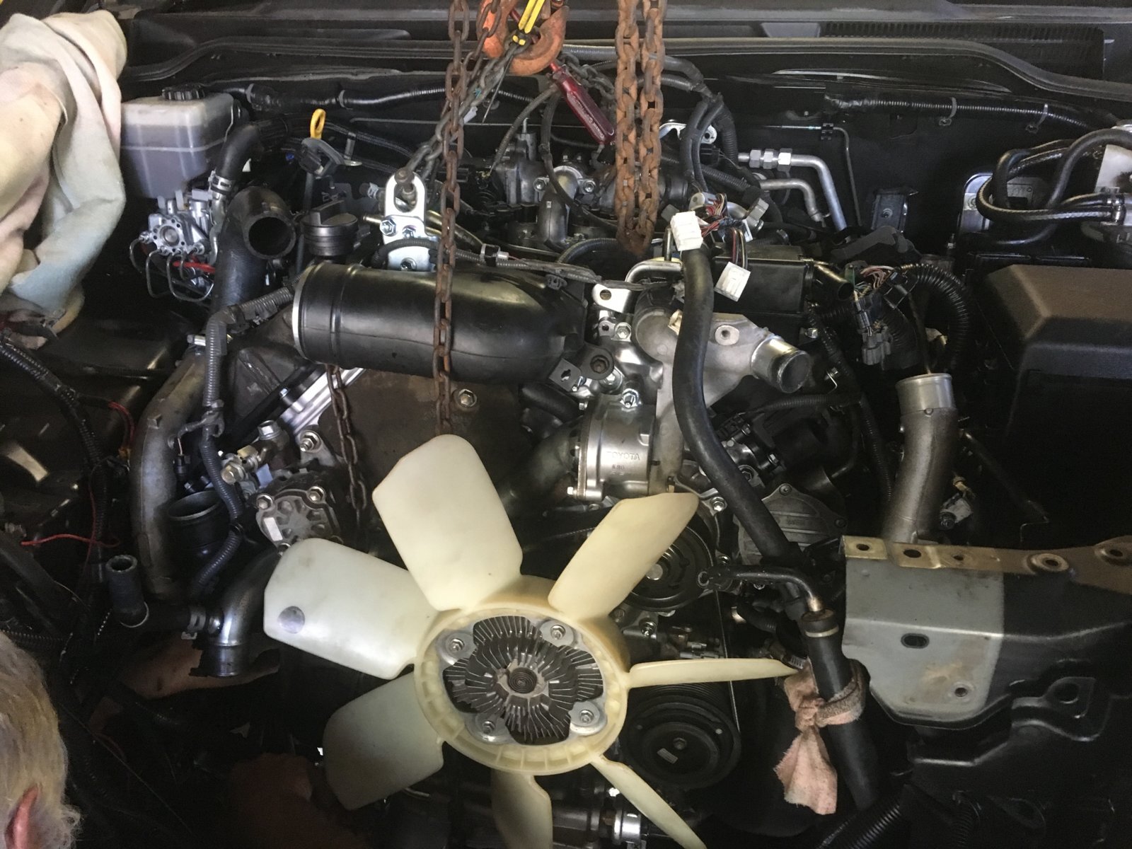

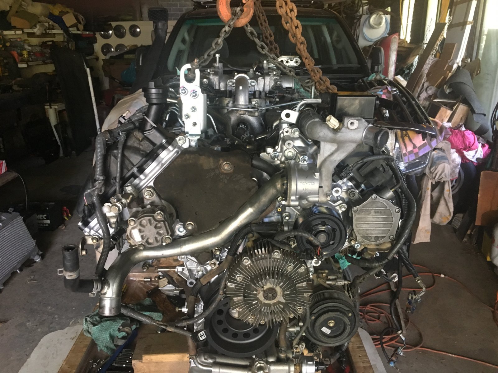

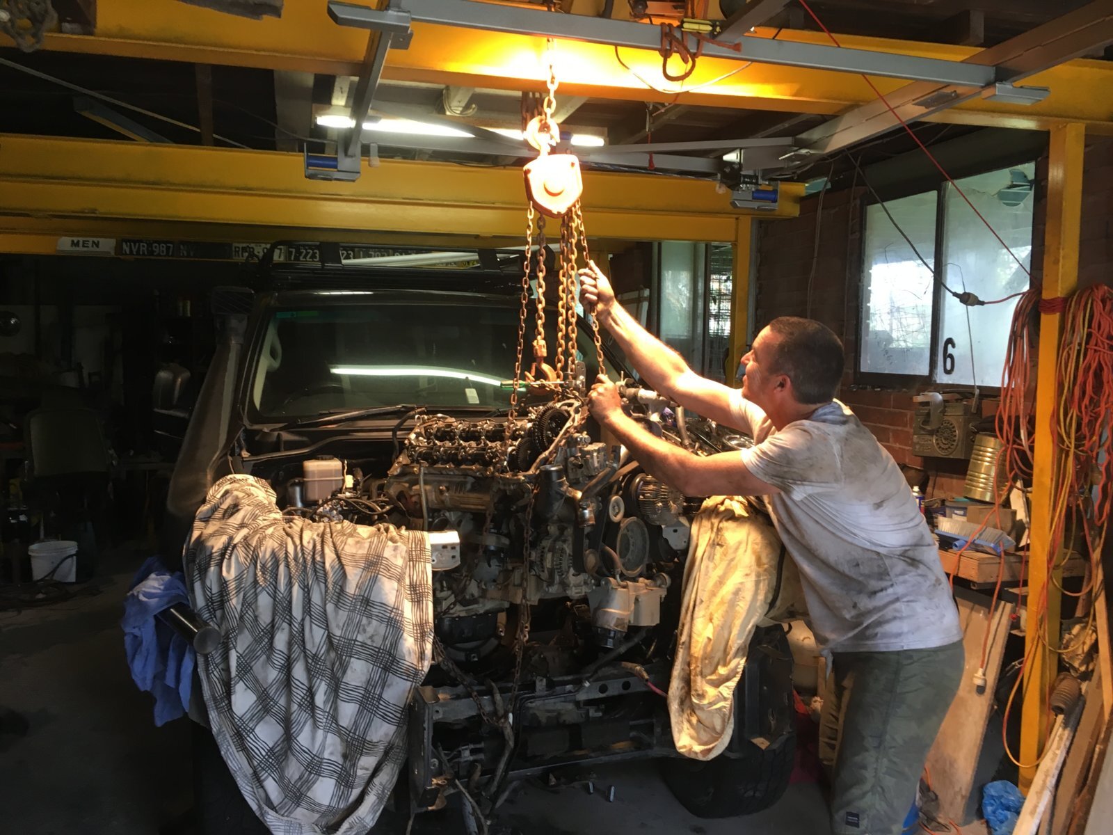

We commenced dismantling the motor as we were told that the crate motor was bare of any electrical component and fuel system component other than the fuel pump. This meant that we had to dismantle the starter motor, the alternator, air filter, catch can, intercooler, air-con assemblies, intake ports, common rails and all sound proofing. When we opened the intake ports we saw the problem in real life. The sludge that was caked on the intake ports was more than 5mm thick oil sludge. Dust was being sucked in ( the wagon had a snorkel on it) through the air filter area into the ports where the dust was being mixed with oil from the sump being breathed topside becoming a paste that destroyed the left hand side of the engine. Why only the left hand side.... This is due to the design of the intake ports and the way in which the engine is made to breath. In order for the harmful dust to get into the right hand side of the engine was by very acute twisting of the air being breathed. The old saying, the easiest path for the air intake.
We finally removed the engine and placed it on blocks. we removed the exhaust manifolds and turbos. Interesting that the right hand turbo was as new but the left hand turbo was completely shot. The vanes were almost ground down to nothing and were paper thin on the leading edges. We sent them away to a specialist who rebuilt both turbos at a cost of some $2,000. It was not worth putting in any of the parts from the old motor that were not new or reconditioned or checked for operation and wear. This was because the engine had to be removed to properly work on it. For instance, the engine has to be removed to work on it or dismantle the starter motor, the turbos, very likely the alternator unless you are a contortionist.
When the new motor arrived we noted that it was identical to the 2008 LC200 that was removed from Dongs wagon and it was identical to the engine in the new 2018 LC200 VX not one bit of difference. Maybe the sensors were a bit more refined and maybe one or two more sensors in the new VX but that was it.
We thoroughly steam cleaned all the wagon and existing parts , catch can and hoses and we transplanted all the needed parts from the old motor to the new. We noted the numbering on all the injectors which were supplied new with the crate engine. We installed the new motor into the wagon and reassembled the front end. It was starting to like its former self.
After completion of engine installation and all body works we recharged the air-con and started the engine. All ok but we had to yet programme the injectors. The engine was blowing a lot of smoke and we could not work out why. We programmed the injectors, still blowing a huge amount of smoke. We sought opinion from others without any conclusion. We thought it may be one or the other of the turbos but both were working ok. We dismissed any problem with the piston rings as we thought that Toyota would not be so stupid as to release a bad engine. Finally, we saw that the oil that was on the inlet pipes was old oil. This could not be from the engine as all new oil was put in. We finally worked out that the irregular breathing of the old worn out motor had pushed old oil into the intercooler which for obvious reasons we did not pressure clean. We did however drain the intercooler not realising that there was still old oil left. This old oil was being sucked into the fuel system intake and through the turbos which was the cause of the smoke. After driving the wagon for some kilometres we finally burned all the excess oil and the car was and still is running beautifully.

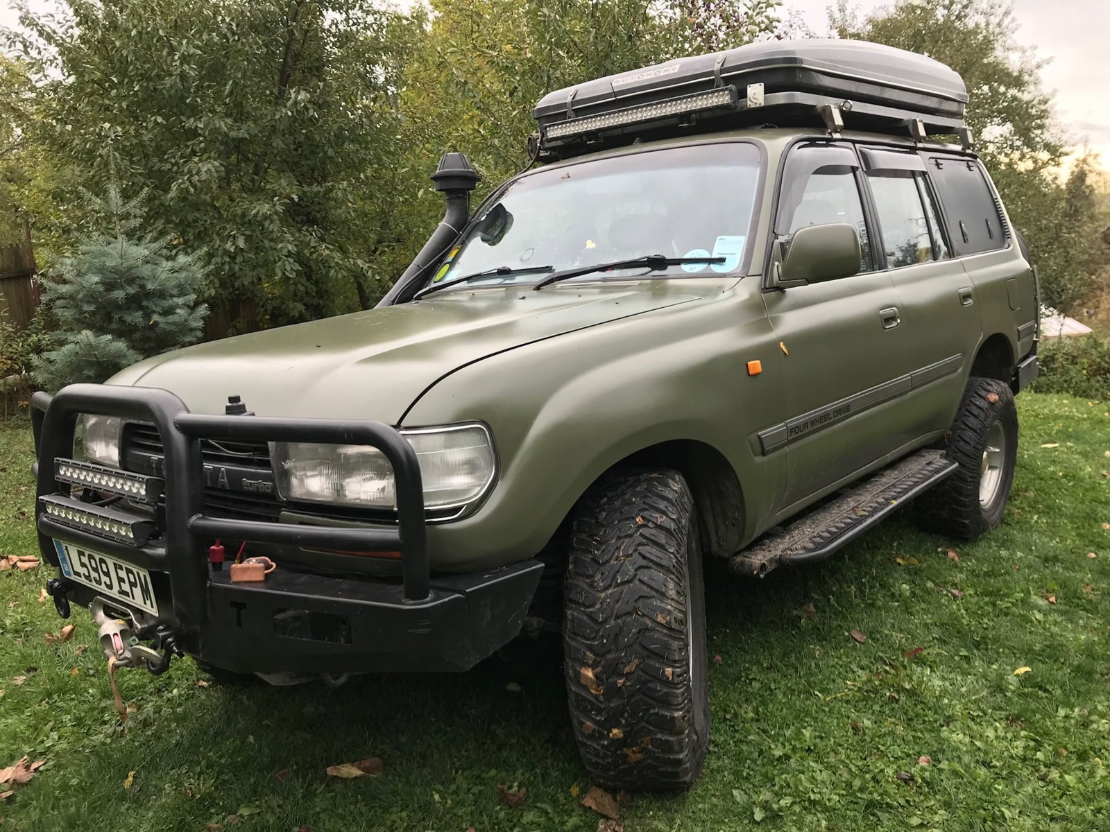

How ive always understood it there are two types of snorkel topper, the one most people go for seems to be the "ram air" type. Probable for looks, and also the probable misguided idea that they have a ram air effect. Its been calculated that the vehicle would have to be travelling in access of what the 80 is capable of to achieve this.
I dont think having the topper facing backwards is a problem as the engine is more than capable of drawing in the air that it needs.
Ive always understood that originally the snorkel was for improved filtration rather than river crossings. They were fitted with a cyclonic topper, which acted as a pre filter. All the toyotas you see in the middle east have these oem.
I have a genuine 80 series snorkel with a 70 series cyclonic topper.
The 80s cyclonic topper is pretty ugly imo..
+1.
‘Ram Air’ effect is used on many high performance bikes but starts to work well into 3 figure speeds. The Ram Air on the zzr1400 is supposed to add around 10bhp at 160mph on an engine that revs to 11000+ rpm. Low revving old diesel engines will gain virtually nothing IMO.
