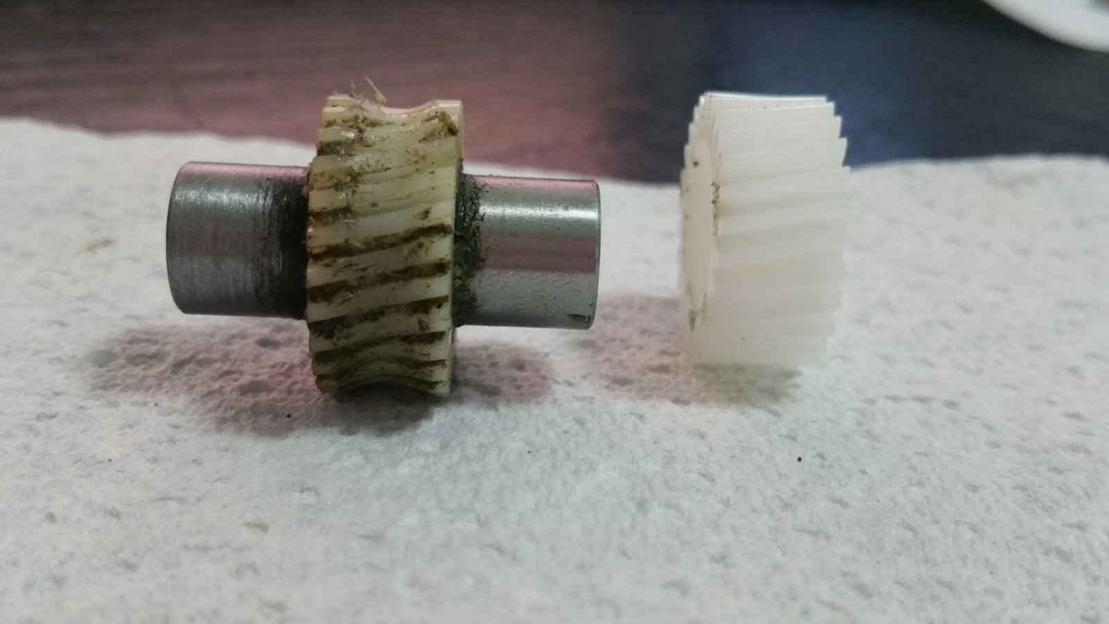

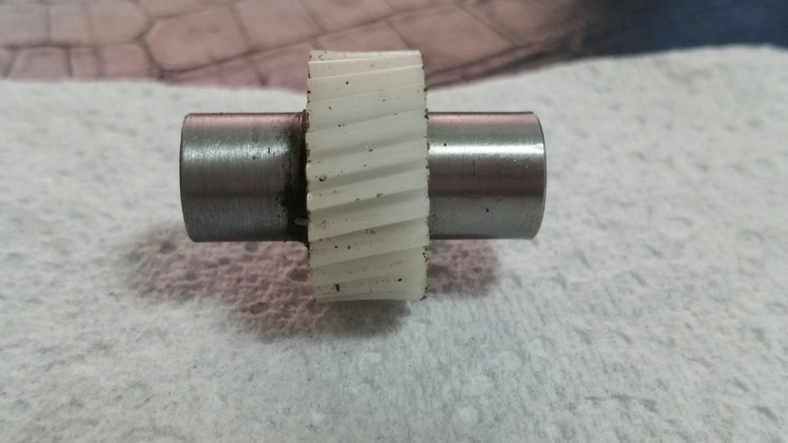

I am in the process of repairing my electric seats to allow them to move forwards and backwards. I researched it online and found Gamiviti make replacement plastic gears and ordered 2 sets (1 gear and 1 end cap per set) However having taken the DS seat out have found there are 2 gears per seat one on the electric motor side and the other on the opposite side, both gears drive a threaded rod (worm screw) and both plastic gears are stripped of their threads, so I will need to buy a further 2 gears (which is a pain, because of the time it takes for them to arrive from the US)

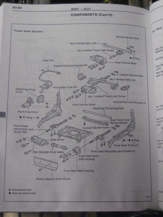

But this isn't my main problem, when I removed the DS seat I found a part missing so a PO has messed with the seats before and not put them back together using all the parts (which is my trick, but annoying when someone else does it first). I have attached a parts drawing showing the part that I am missing on the drawing it is called a Seat Adjuster Drive Cable, but I am not sure it is really a cable. It sits between both plastic gear housings and makes the slave housing work that is not directly attached to the motor allowing both gears to turn at the same time.
Does anyone know where I could source this part, not many models were sold with electric seats in Australia only the Sahara had them. My 80 when living in the UK had electric seats and was called a VX and there seemed to be lots of VX models sold in the UK, here in Australia the most common model is the GXL with manual seats.
