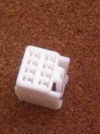

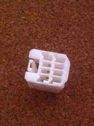

Anyone know where I can get the pins that terminate the cable and fit into the OEM connectors like this one?
Halfords or specialist Auto Electricians?
Tricky one that, Gary. I'd suggest Vehicle Wiring Products. They do the spare pins, but are they the RIGHT pins? Their service is excellent.
Also Car Builder Solutions
http://www.cbsonline.co.uk/
I've a feeling there's a Toyota part number for them but I don't know what it is, might be worth asking on ih8mud?
Yep - toyoDIY only have the harness, terminators and connectors ...
Sent from my iPad using Tapatalk HD
Thanks - found some, I think, at VWP so will get a set in the next day or two to check sizing (only £2 or so, so not a train smash if they're wrong. I'll take a look in the existing switch first to confirm if they're the 2mm pins though :icon-cool:
Toyota do sell 'repair wires' - short wire on the push in pins in a neutral colour.. And they sell the plugs, presumably with the pins... I've got a copy of their 'electrical repair products catalogue' that i downloaded from somewhere (mud?) which may help locate the plug part number, should you need to go that way in the future.
I can email them to anyone who's interested - but as i say its just the plug part numbers and picture cross reference..
Edit: just found repair wire catalogue ... And where i got them from! http://www.ih8mud.com/tech/WireHarnessRepairParts.php
