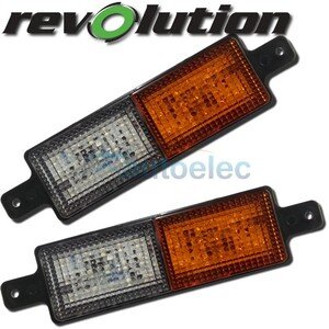

I have now fitted and wired my new ARB drive and indicator combination light to the bar. They are these ones.
They are rated as follows,
WattageFront Position: 1.8W
Front Direction Indicator:3.7W
They have a common earth and a positive for each side. I T'ed off the positive for the indicator and positive for the drive lights.
The indicators work great and when i had only one wired up the drive lights worked too BUT on wiring up the second one when i put the drive light on it blows the 15amp tail light fuse. I replaced the fuse with a 20amp fuse but it blue that too.
What could be wrong? I can only think the wiring but its so simple so cant see where i went wrong.
When I connected it direct to a battery it all works. Admittedly there is no fuse involved but don't think that should matter.
I will have to go over my wiring again as its the only place I can see here being a problem
