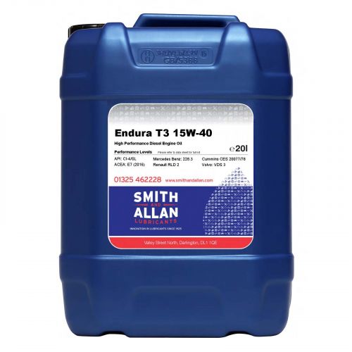

I have used semi synthetic for years but have have a large barrel of mineral 15w 40 in the shed. It is a reasonably modern spec but not for common rails with ad blue and Dpf etc.
Think i would use the 15w 40 . Way i see it is dinosaur oil breaks down quicker than synthetic is all and synthetic has a greater tolerance to temperature both high and low . I would assume all engine oils contain ingredients to prolong seal life .
Semi is just the middle cost effective option .

I'd deffo use the 15-40. If its the stuff for lorries ( which we change at around 40K miles) then 5 k changes in the 80 will save you money you can spend on diesel and go further for less.
15w 40 has perked my interest , if its good enough for CAT and JCB longevity at around £110 for 25 litres ....... its probably what goes in my boat though i've never given it much thought because all the boats in the local fleet get the same generic engine oil from the same supplier .
