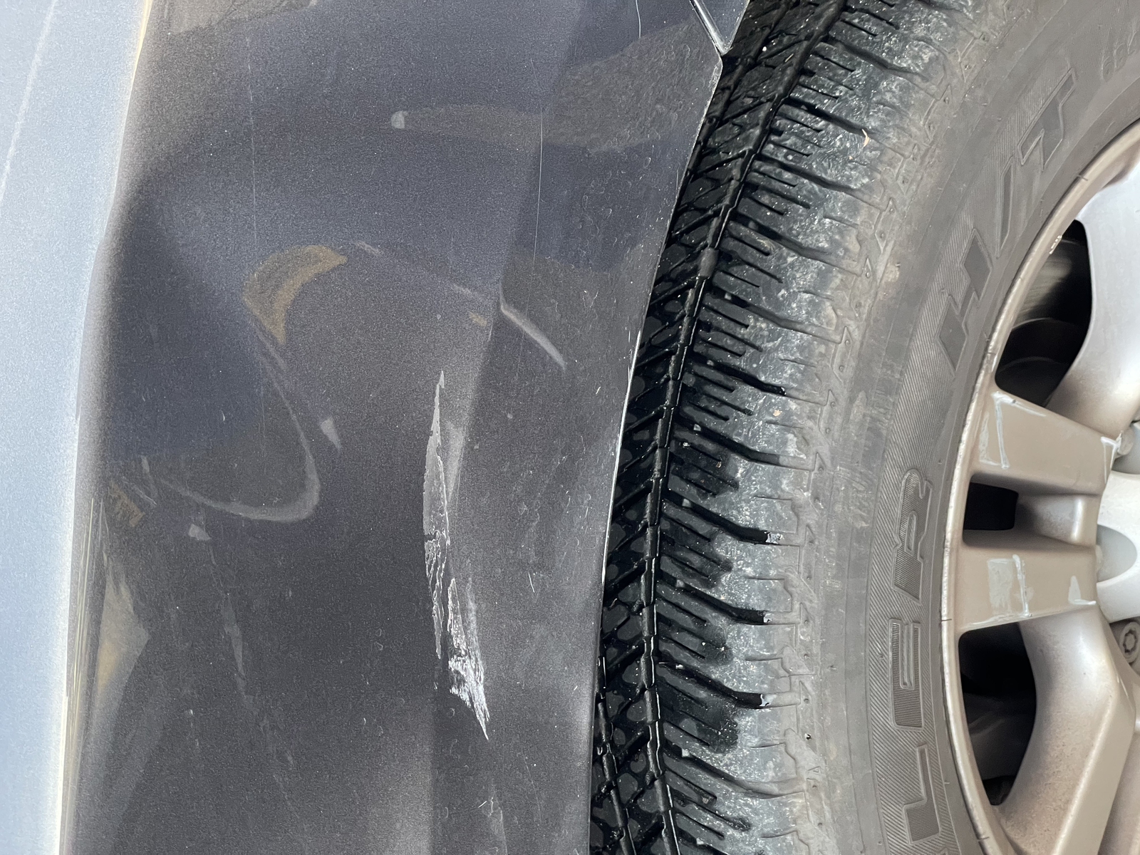

I'm sure they do it on purpose to wind up their customers. The good news is that he didn't charge me anything for some reason, I can only think that because the car is still in warranty time wise but I've gone over the 10,000mile per year limit, and I paid for the part they didn't charge as a good will gesture. I didn't discuss it with him as I was on the phone at the time discussing the details of how my neighbours grandad managed to miss their drive by about 20 feet and put a nice big dent in my offside wing and damage my alloy. The customer service advisor just pressed the key in my hand said thank you, all sorted and gave me a thumbs up, so I won't be too hard on them with criticism.
