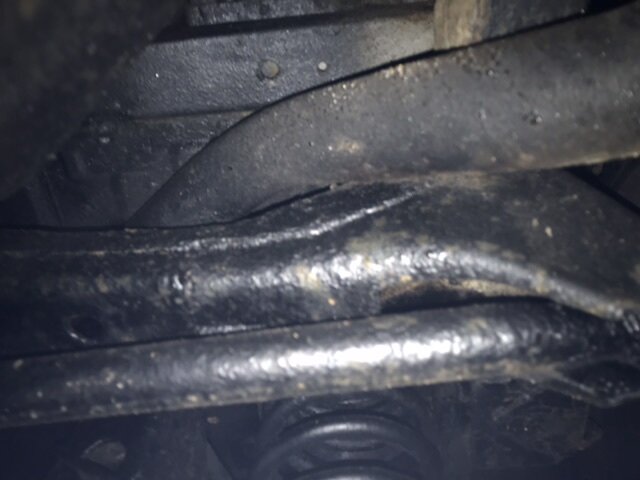

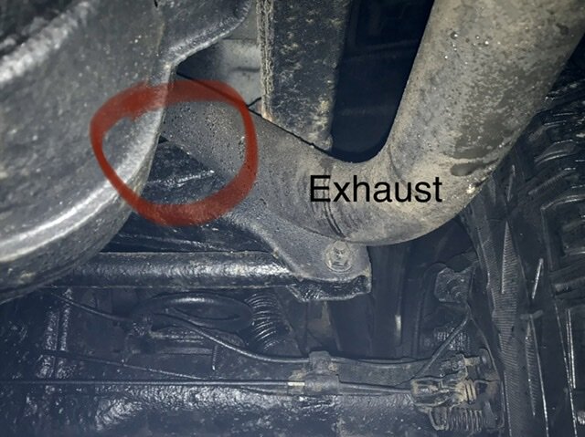

first photo show view from back to front on rear of driver side of car. You can see the exhaust indicated. My suspicion is at the red circled area, exhaust seems to be very close to the cross frame... second photo is the zoom in view of the red circle area.
can anyone compare the gap between the exhaust and cross member to yours, mine is a LWB 1996 Prado. How can I lift that bit of the exhaust up to separate further from the cross frame? New rubber mount?
Just bend the brackets where rubber fixes the exhaust to the truck .
Thanks, how much gap is sufficient? 1.5 inch? Brother in law family still around but haven’t been out all together since picked them up from the airport so want to be sure there is sufficient gap next time they all get in. otherwise a bit embarrassing, an 8 seaters that can’t take 7 people...
V6 or inline 4? (The V6 is a different exhaust layout at least up front).
I have a 3" custom made stainless exhaust and when its knocking there i usually just bend the rear most bracket (which i can see while looking at the rear bumper) up or down an inch using my bottle jack handle for leverage . No two trucks will be identical so its trial and error .
Thanks, Shayne, will give it a go.
it’s an in-line 4 Ad Wagon.
