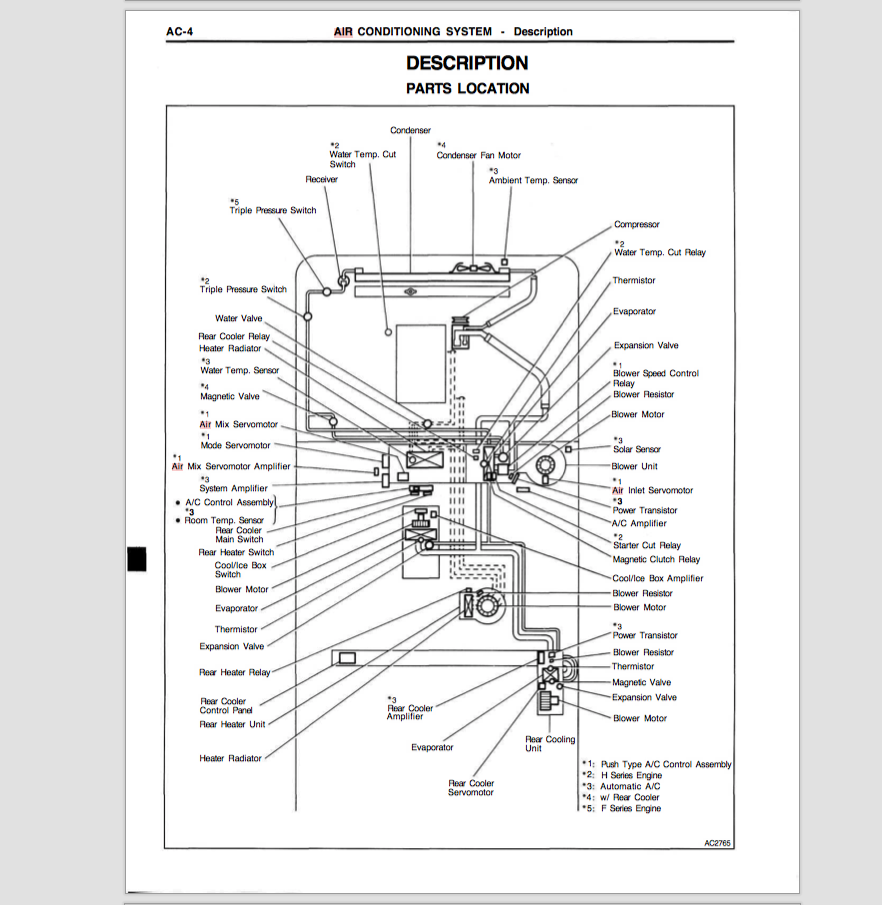

Hi Im having A/C issues with my JDM 80.
My main issue is not having A/C. Compressor is rebuilt. Gave it Freon but it air is still not cold.
Compressor gets power. and engages on/off.
There was some cold air at some point and I'm not an A/C expert so I go off the gauge on the Freon filler can and its in the green range so I'm not pumping anymore in.
The A/C lines going to the rear A/C are rotten from underneath. The rear blower fan is not getting power as well.
Should I be looking into getting the rear A/C deleted? Anyone had to diagnose the 1,2,3 circuit points below? Is this the right place to start to get power if tryin the route to fix it?
Thank you
