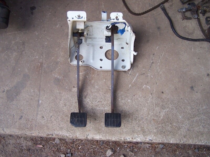

In regards to the brake booster you will need the later model version if your running disc brakes, also the trick is, get the complete peddle box from the later model as the booster will bolt straight up.
If you use a 60 series one you have to turn the booster part upside down to fit.

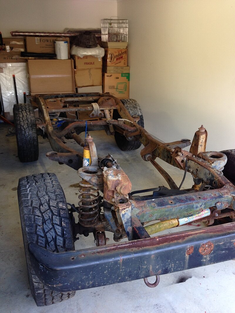

Long term coil suspension is cheaper to maintain, and a smoother ride. Coils don't rust like leafs do and can be swapped out in minutes and not hours like leafs take and coils are one tenth the cost of leafs. The chassis I showed you is a RJ70 1986 to 1991 (Bundera) which has coils all round, wheel base is 92" whereas the 40 is 89" so the 40 series tub will bolt straight on. You can also use 80 series springs on this chassis.
The RJ70 chassis above costs around $900 to buy, the 40 chassis I did with the 80 series suspension parts and 60 series power steering box costs around $5,500 which includes the original 40 series chassis, then like any chassis there's galvanising, wheels bearings, disc rotors & brakes rebuilds, new alloy shocks, bushes, drive shafts, diff rebuilds, knuckle rebuilds, brake lines, etch prime & paint, 3" 316 SS exhaust and alloy wheels & tyres, etc, to get to a rolling finished chassis, costs around another $8,500. So you can see the RJ70 will work out half the price of my last chassis.

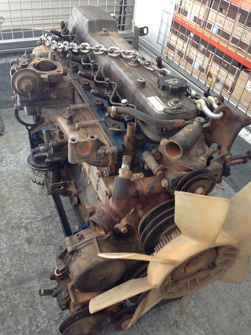

I tend to galvanise just about every part I can on my builds, and the engines gets fully rebuilt, a 12HT as is a 2H are nearly 30 years old and a lot are still running, considering that for the last 20 years they have not been looked after very well. So a rebuilt one should last me at least 20 years. I use fibreglass bodies because the steel in the 40 series is not very good and fibreglass will last me a life time. I use SS bolts everywhere and 316 SS for exhaust systems, and alloy housing shocks.
