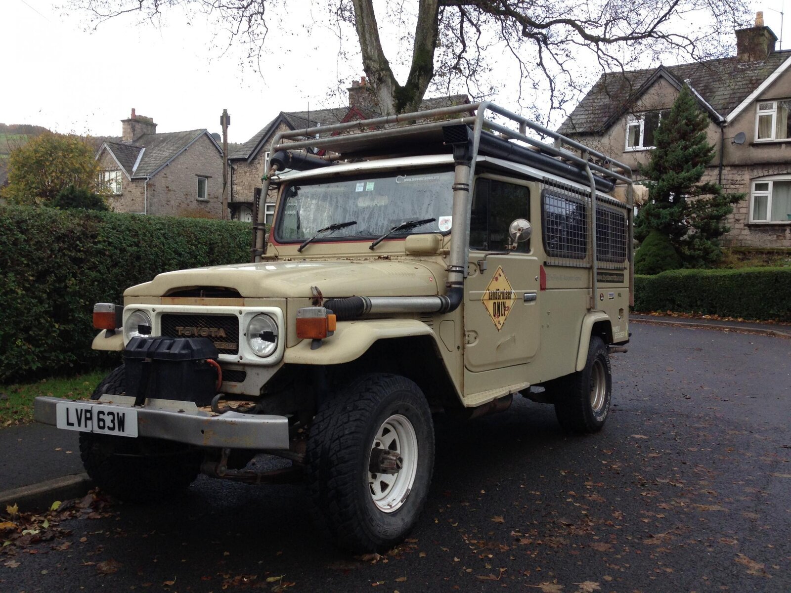

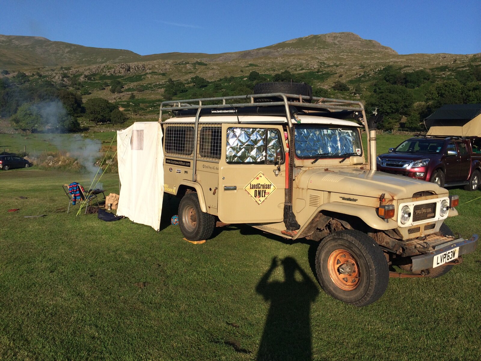

I am a first time poster here. I am interested in an HJ47 troop carrier that's been converted into a camper. I have seen the "pre-restoration" photos of this over the years. I believe the first UK owner was(is?) A member here. Here are some photos pre repaint:
I had a look at the troopy a few days ago whilst down south visiting pals. I thought this might be the one given various obviously rusty ones over the years. I would appreciate opinions from owners here as perhaps I have unrealistic expectations for UK 40 series.

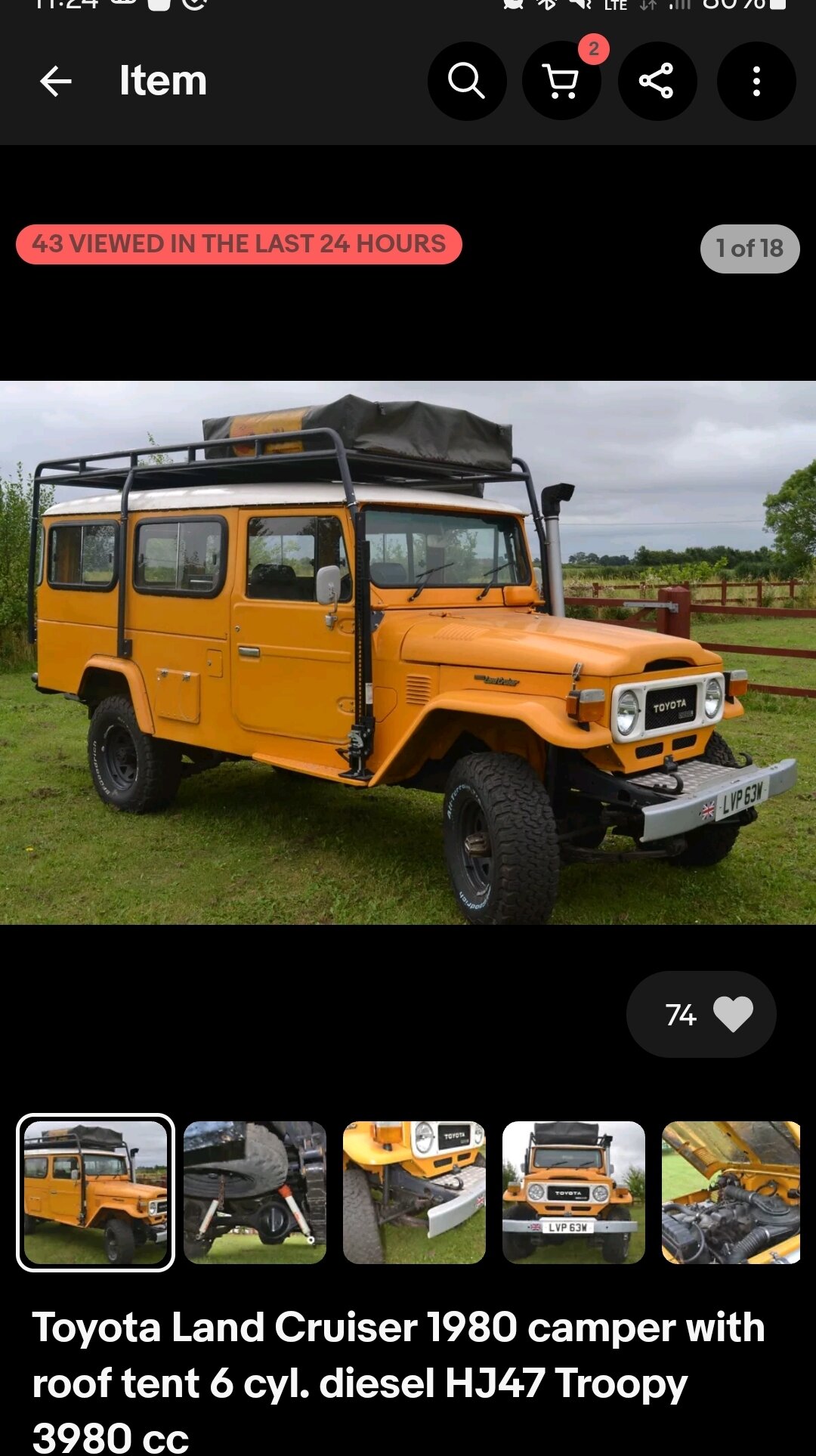

Sorry, forum doesn't allow ebay listing but here's a screenshot.
