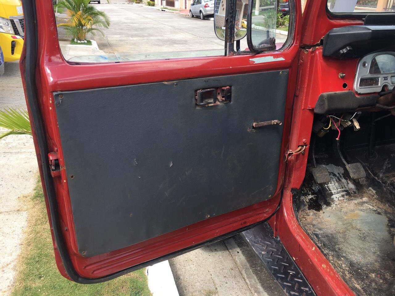

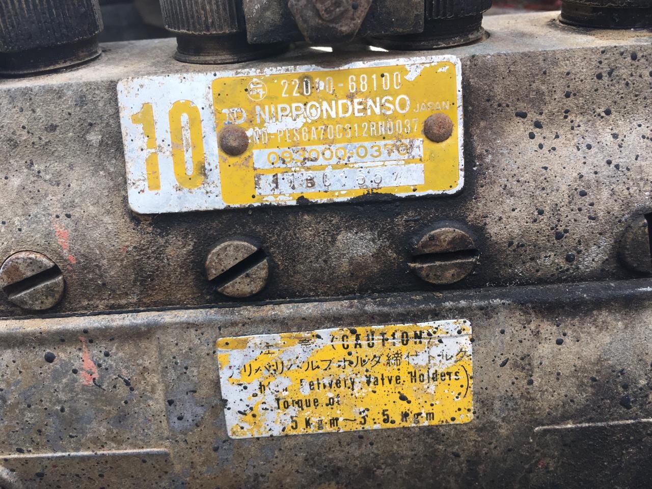

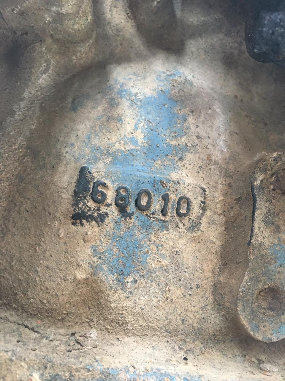

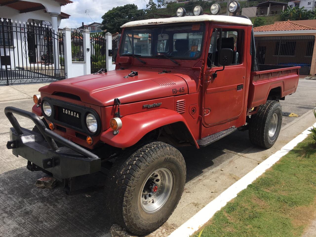

I am currently looking at bringing a 1983 FJ45 from Central America to restore and use personally. I just checked the truck out... runs great, roof needs to be replaced, bed looks like it was swapped for a newer model at one point, expected amount of chassis rust, body in good shape but has been resprayed, title papers color matches respray. But the big concern is not finding a VIN/constructor's plate. I've attached photos of what I could find but it looks to be only the engine serial. I need to get through these issues before okay'ing the purchase. Any insights? I'm assuming it wouldn't be legal to have a VIN plate made to match the title paperwork... or is it just illegal to create a plate that intentionally doesn't match paperwork, etc?

Hi and welcome good looking cruiser you have love the old 45's a big from Tony.
Thanks Tony... looking forward to falling down another classic car rabbit hole :) ... At least this time I'm back where I belong in the JDM world, those British cars broke my spirit a bit, HA!
