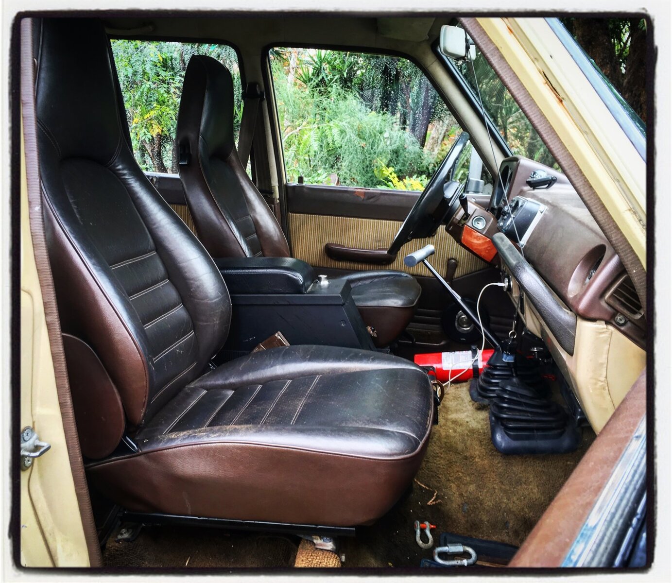

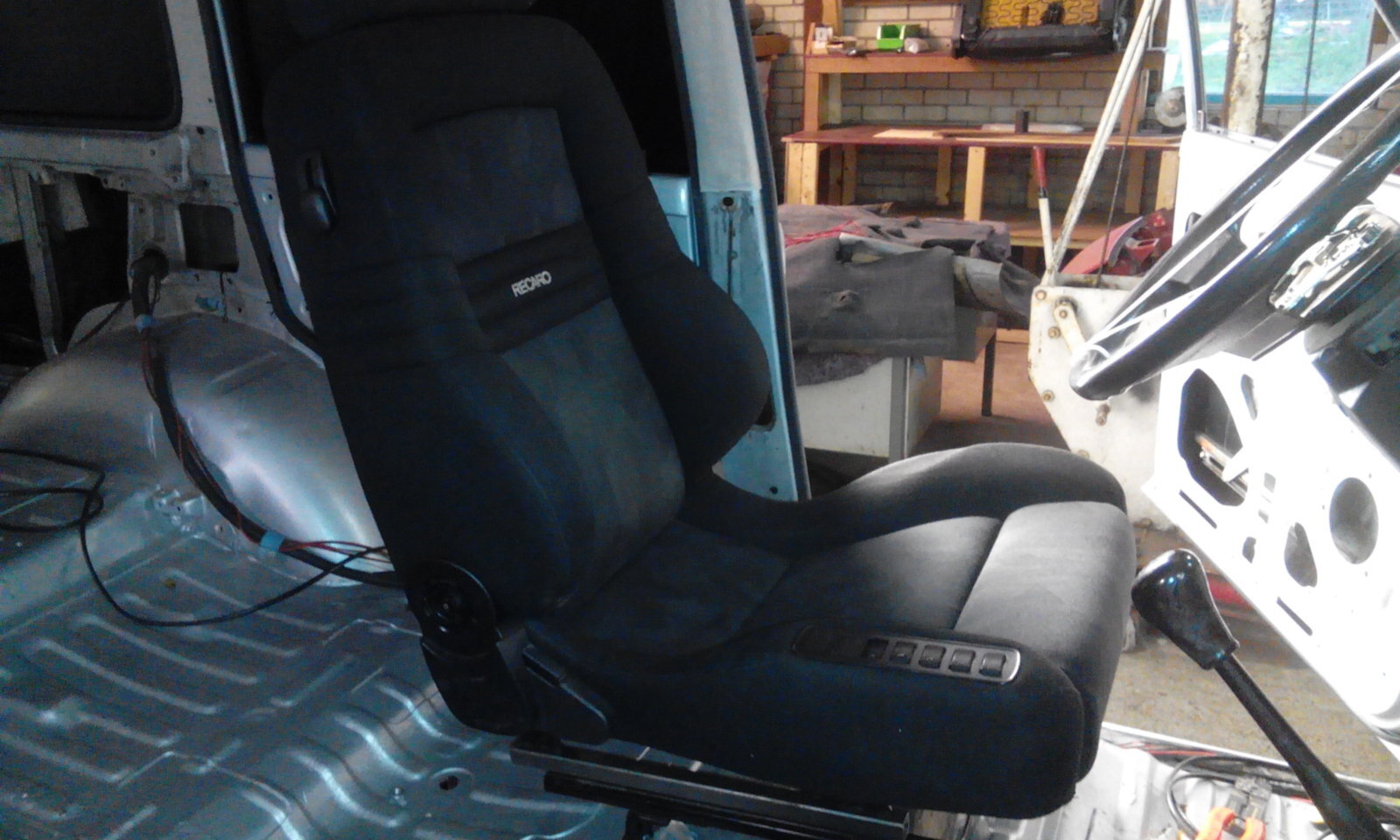

I got a set of Recaro's installed in mine, and it took me a fair bit of time to make a bracket to fit the seats in.
I heard Jeep Cherokee's fit well, but are quit high. BMW X5 or X3 also works, but are something different then an 80's seat, and require a bracket aswell.

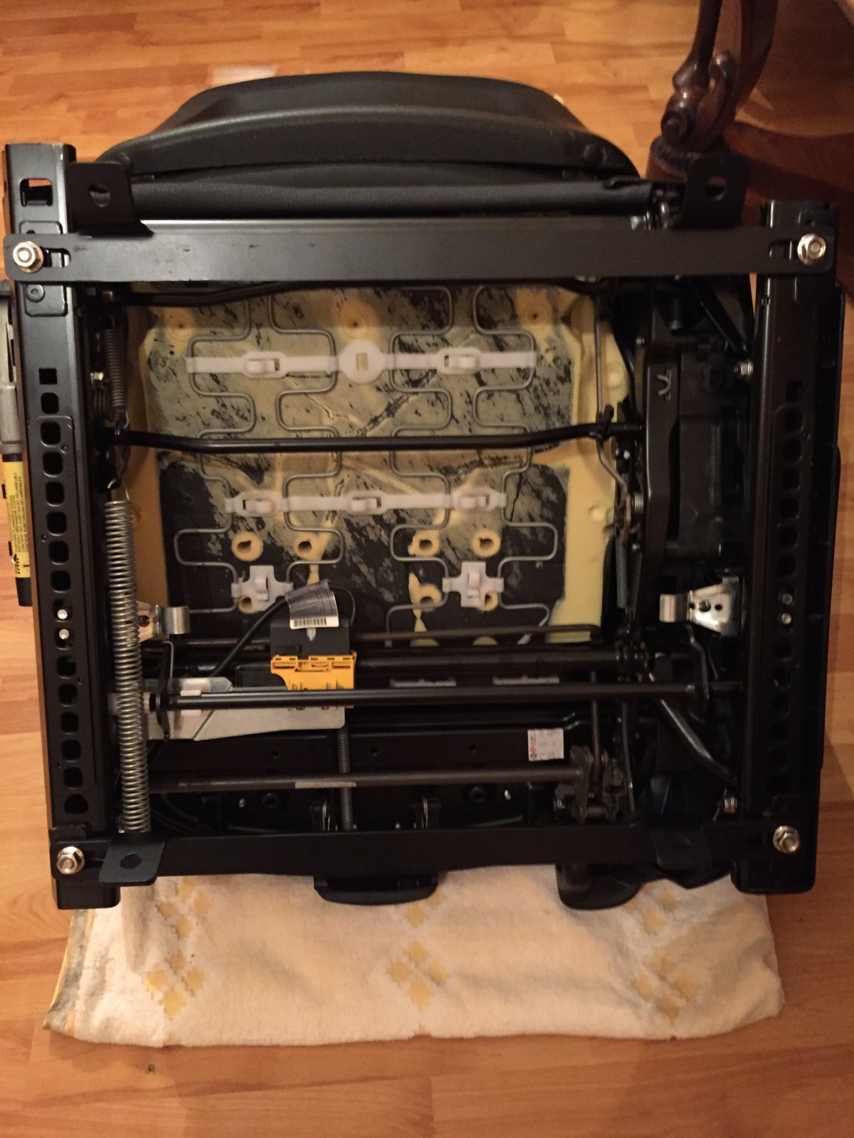

Hey Ben ~I'm a little late getting in the game here, but check out the thread I started about resto vs mods for 60 series "Dubious Interior mods. .."

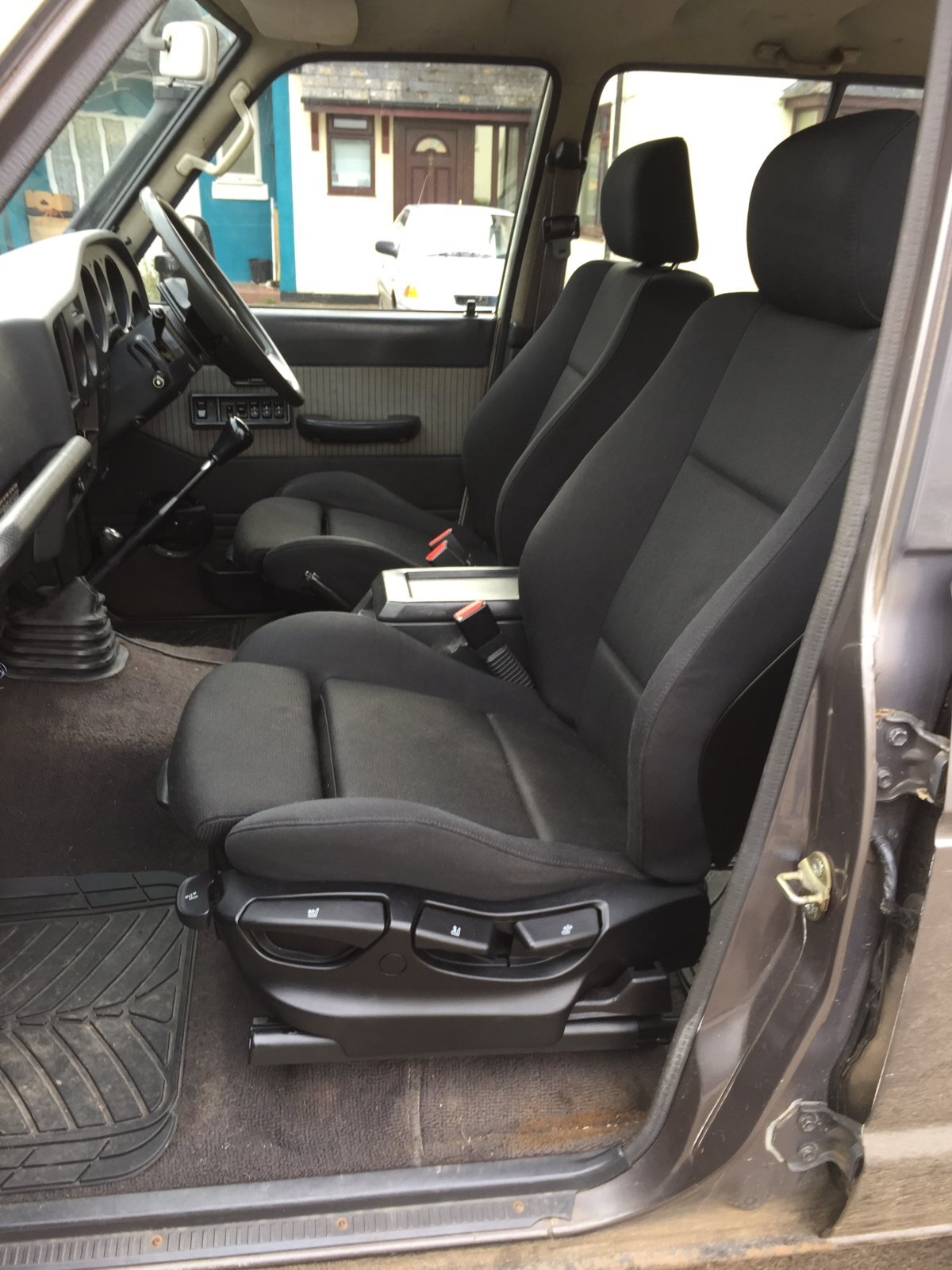

I have purchased a nice interior from a BMW X3 and only want the front seats. These are black cloth and have manual adjustment for everything. Will need to find some black BMW seat belts and make them fit too.
Not sure how they will fit yet but pick them up next weekend.
May use fabric from the back seats to update the door cards, not sure yet

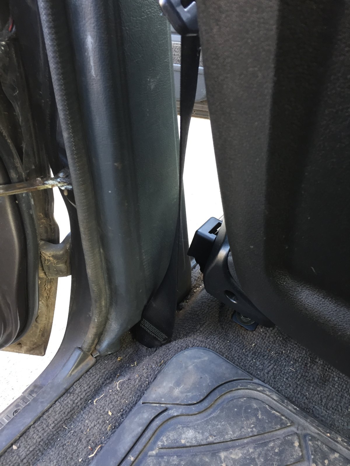

Both seats now installed
Yes Rich, wanted new seat belts so got the X3 matching belts as the seats had the stalk end attached already.
Its not going to be straight forward though. Now need to fabricate a bracket to attach the spool end.
Drivers seat still has old seatbelt for now hence the 2 stalks visible.
Getting there.

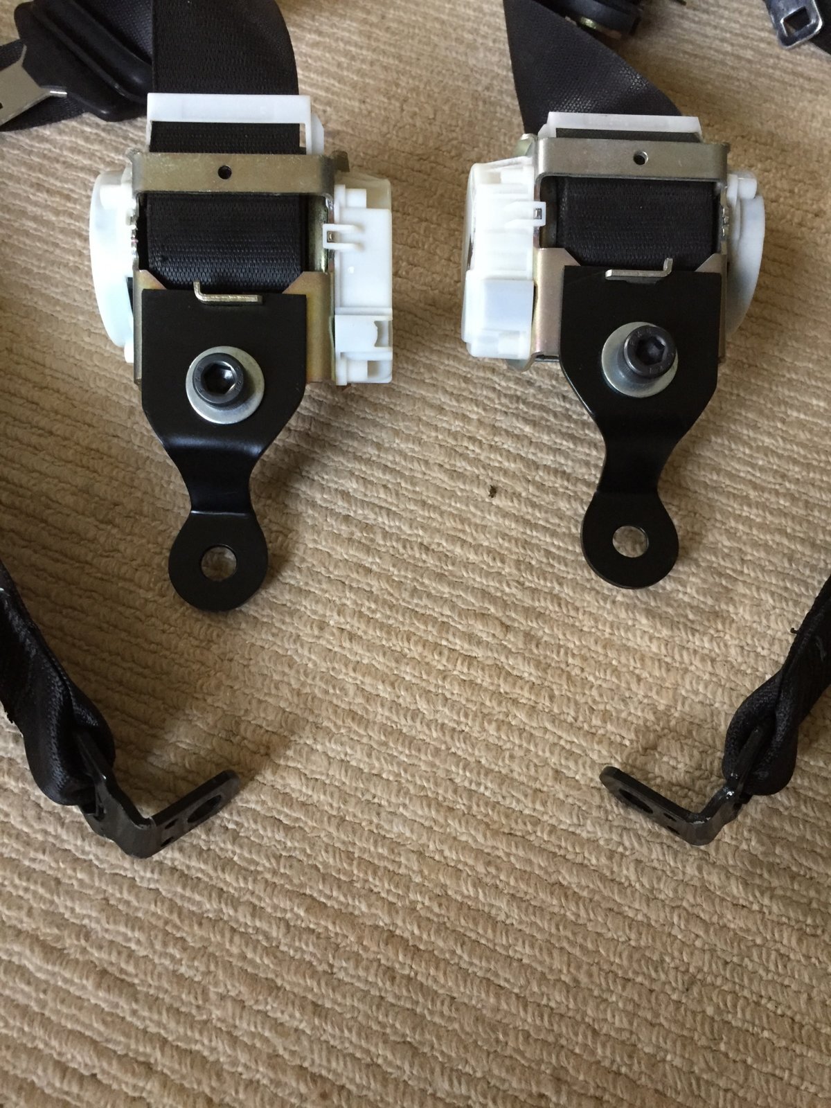

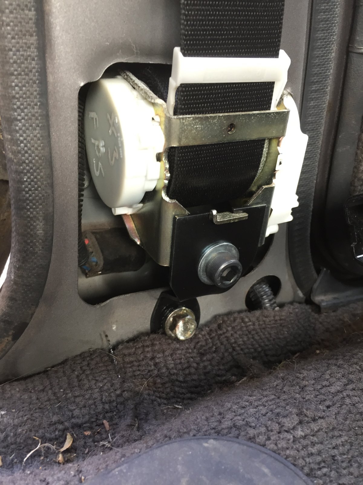

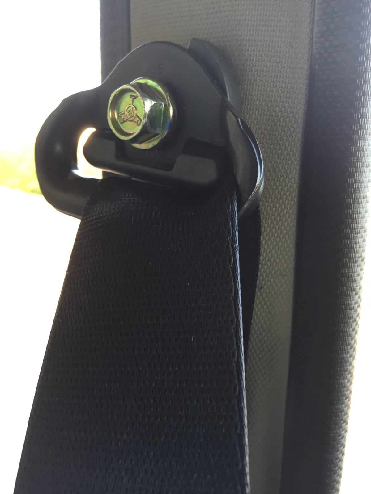

Fitting the bmw x3 seat belts was actuslly very simple and took an hour.

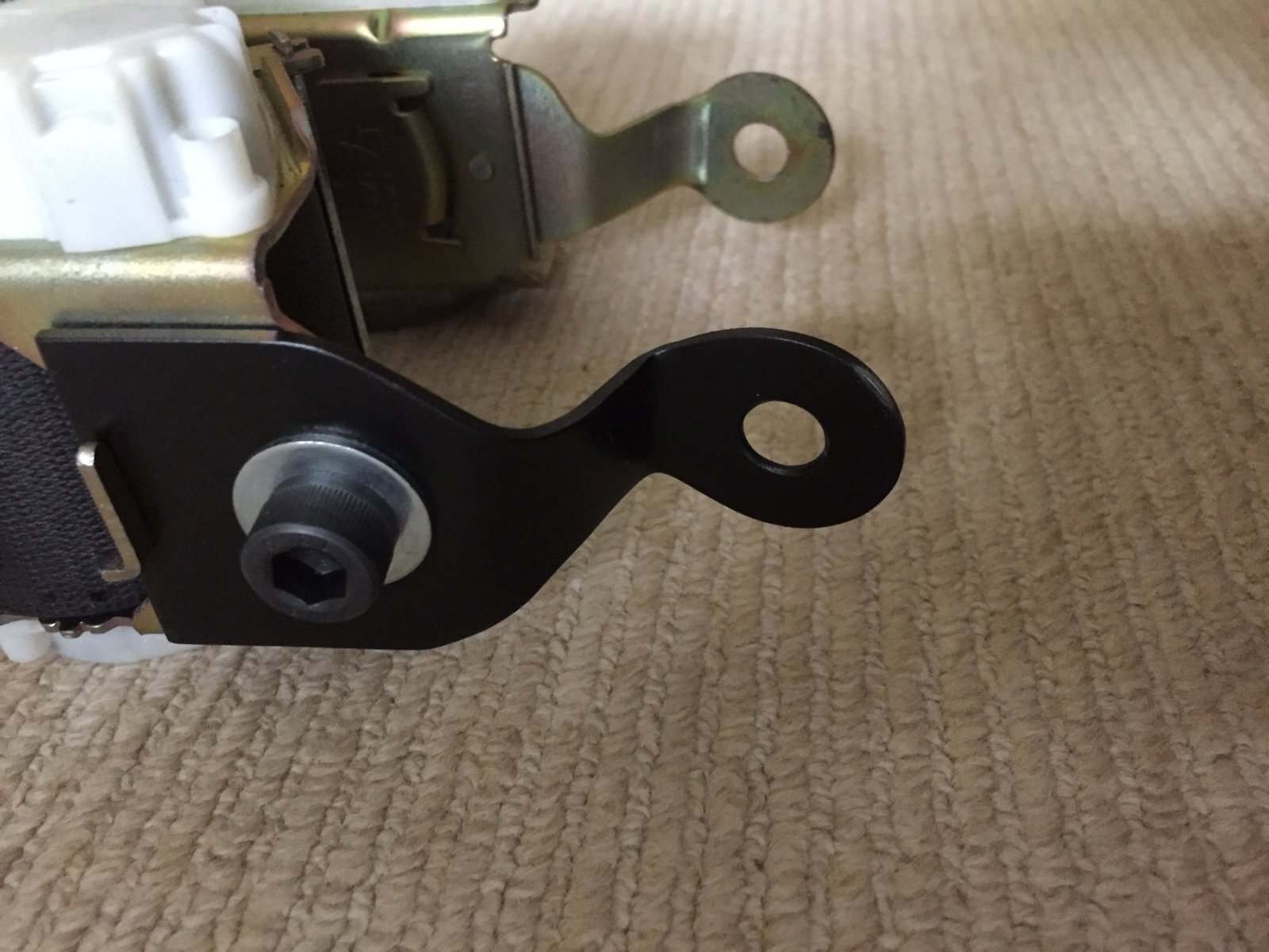

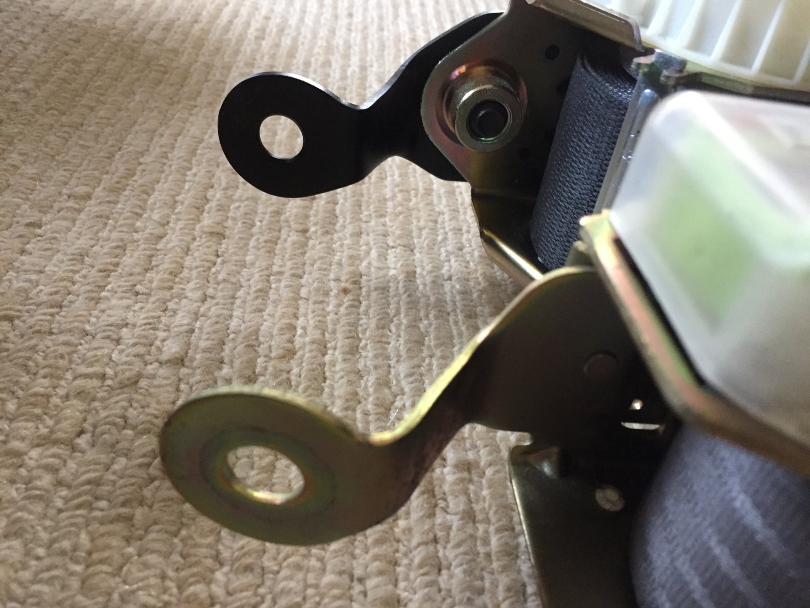

Ok so i cheated a bit. I took the old and new belts to a local fabricators yesterday and after mentioning the magic word ... cash, and that i needed them done by 3pm, they made a couple if adaptor brackets that bolted on to the bmw seatbelts (the black plates) below to mimic the originals.
They also needed to bend the plates at the end of the belt by 90 degrees that attach to the floor
A superb job they did too and the claimed 3 hours lanour was very reasonable
The body fitted perfectly in the existing hole with no modification needed
The bmw bolt had a 14mm pivot then a 10mm thread whereas the original bolt was 12mm threaded all the way. So i ordered a piece of tube which arrived yesterday that was 14mm o/s diamenter and 12mm i/s diameter. Chopped off a 7mm bit that acted as the pivot then it bolted in nicely and moves freely.
I left off the bmw trim piece which looked horrible and prefer it like this.
Great adaption with the parts you have fitted Ben! It's great that the seats are manually controlled and they look fantastic and I bet they're very comfortable. Awesome mate :thumbup:
They are Iwan, had similar in a 525 and 320 so knew what i wanted. Didnt want the electric stuff for weight reasons but even so these weight at least double the originals.
Im sitting a couple of inches higher too
