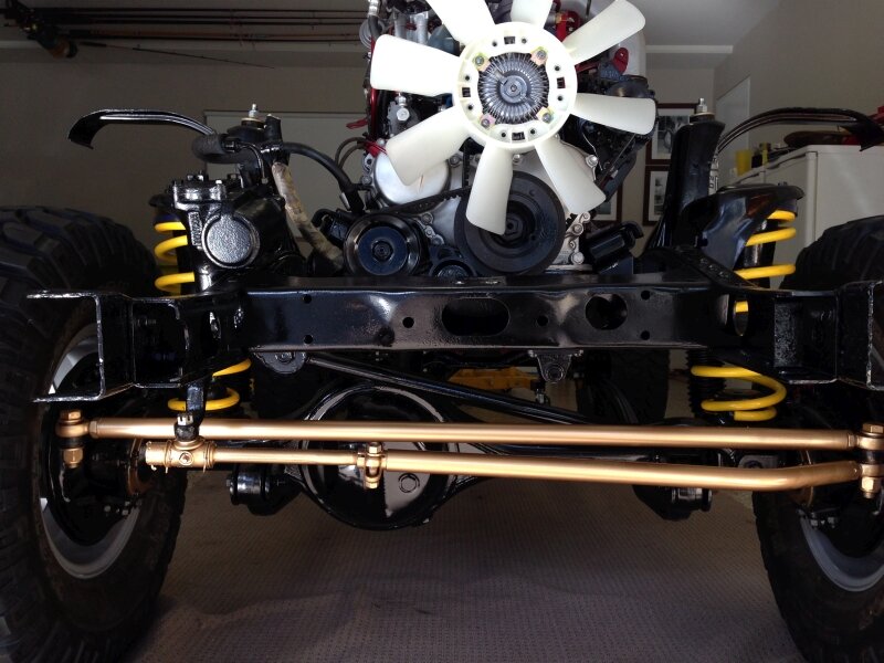

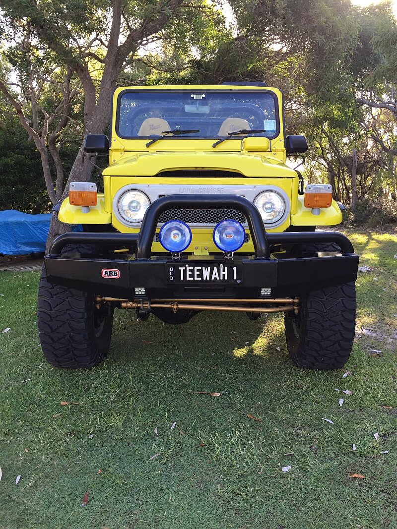

Yes, same setup as a 80 series, here is the front axle, again 40 series axle with 80 series parts?
If you want to go the full hog on a 40, then you install 80 series suspension on a 40 series full floater axles and add disc brakes?
Nah for what I do I prefer leaf springs and I don't think I would be able to get the flex and travel that I have with a 4-link coil set up. And all in all the leaf springs are more durable in my opinion less to go wrong. Coils arent as good in the rocks either they bounce leaf spring stay planted and climb easier.
Nice jeep sticker on your windshield by the way there watrob!
Yeah, my son-in-law put that on, he has a current model 4 door Jeep Sport Wrangler, had to snatch him out as he bogged the jeep to the chassis rails the other weekend on the beach?
I don't go off road other than 100% beach work so I am looking for a smooth soft ride.
Have started the next build, the only difference this time will be an Auto transmission I think?
