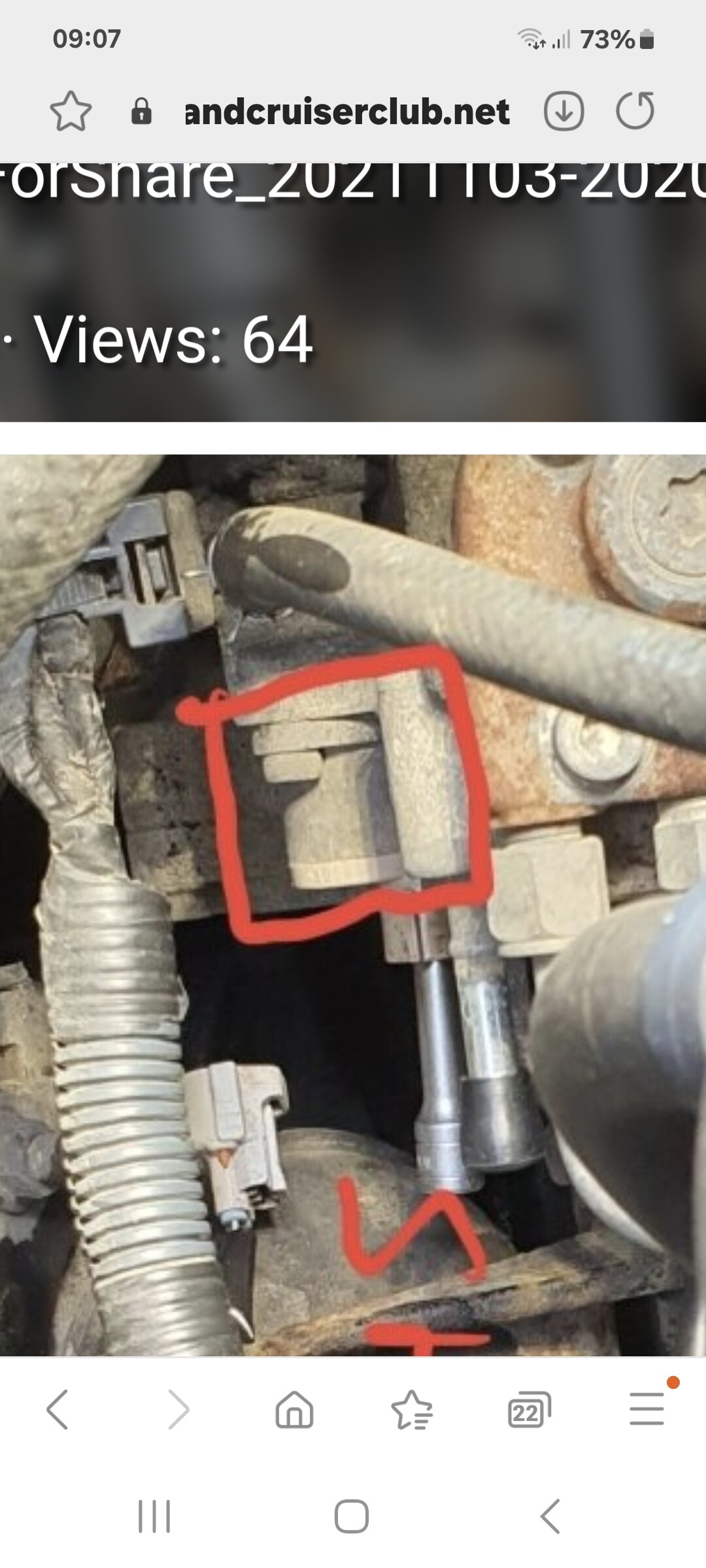

Can you suggest a decent thread so I can identify which SCV I have?
Cheers
Found the thread Karl,mine's the short SCV. While everything's working I'll leave it alone.

Put it on your list to upgrade though, otherwise it will let you down when you least expect it!
It looks an easy accessible DIY job,is it?
How much is an OEM SCV from Mr.T?
After how many years or miles are they packing in?
Cheers
Its straightforward but fiddly and youll swear when you drop the screws.
Fourby4diesel has a video showing you how to do it
Dont know how much they are from T - i bought mine from roughtrax a few years back
I think they can fail anytime - all these trucks are older now!
There was lots of swearing with mine - getting the wiring coupling unclipped was a bugger for me, which should have been so simple. Usual Toyota press tab in and pull both halves apart, but I couldn't seem to get tab pressed in far enough to release while I was hanging down over the wing
Karl must have had a right laugh when I told him I couldn't get it apart after having several goes over as many days. He persuaded me not to use a BFH !
The rear bolt on the scv, you are pretty much going by feel with the Allen key, as your hand will be blocking visual and there is a pump screw close to it (same type), I undid that one, and wondered why the scv wouldnt slide out (after releasing the front one of course). More swearing !
Be scrupulously clean - clean everything above and around the old scv before starting, you dont want any sh*t in the pump removing or replacing the scv.
Even with the small problems I encountered, an easy job.
If you drop any screws they inevitably end up on the sump guard, (oem or aftermarket) where you cant see or get at them. A telescopic wand type magnet is invaluable here to swipe the area from either above or below, bearing in mind it has a natural desire to grab a steel sump guard too (or anything else attracted to) just keep pulling it to slide across the surface and (hopefully) bring the screw with it. A very useful bit of kit for any awkward items to locate with a very strong magnet for size.
