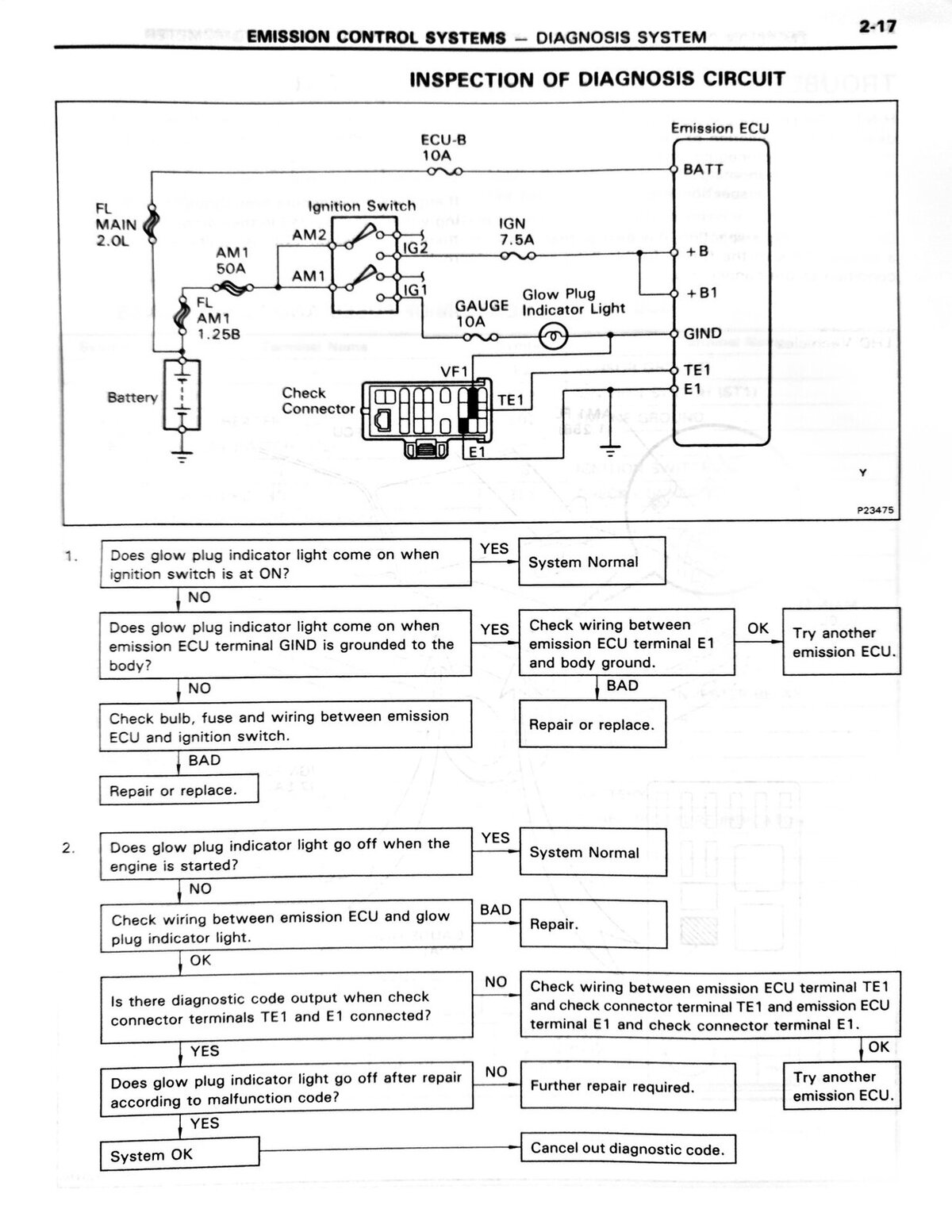

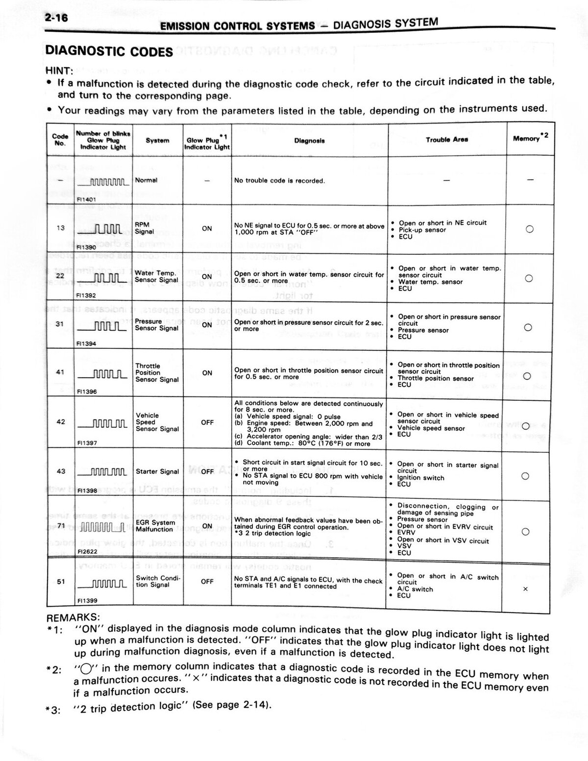

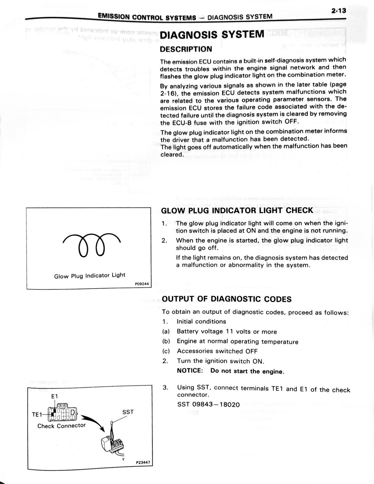

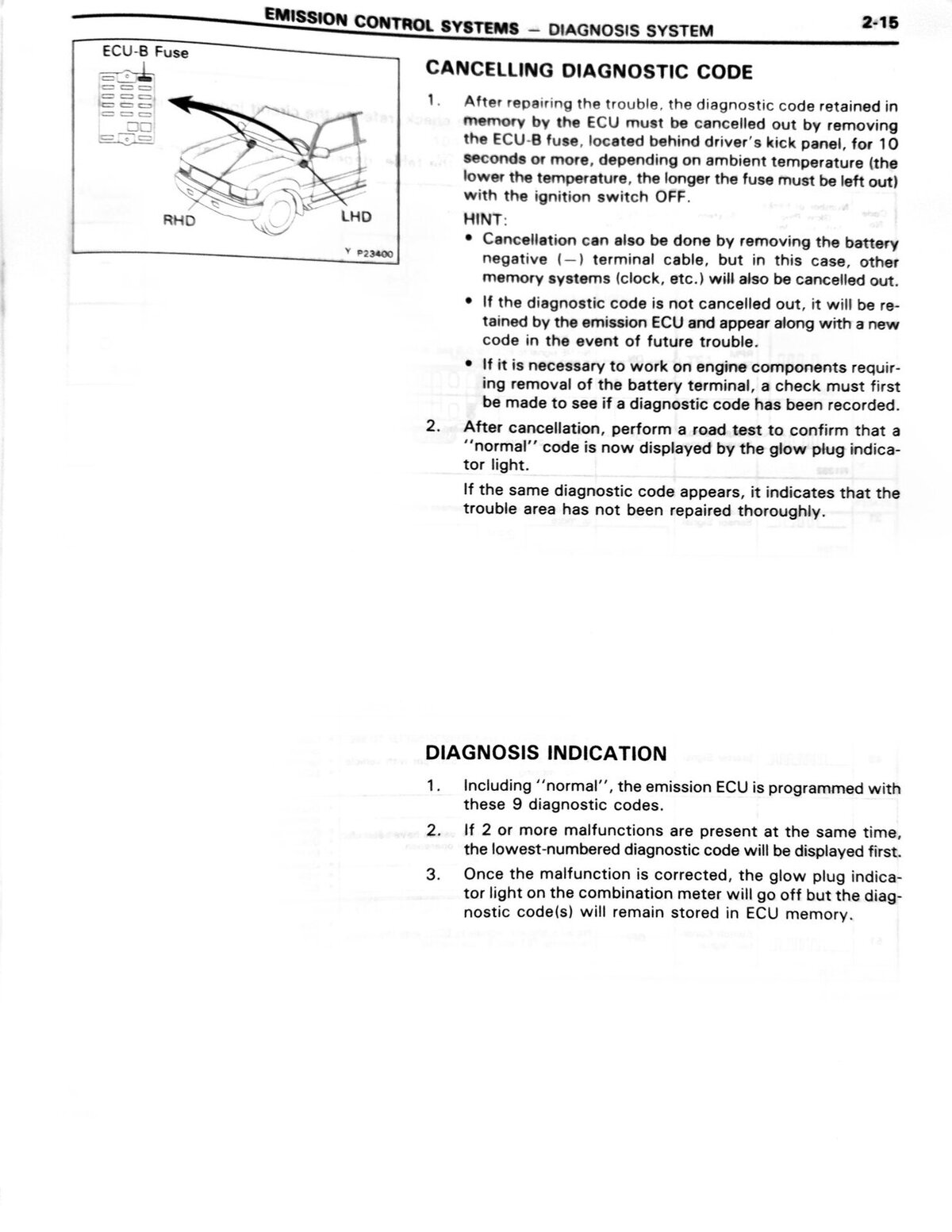

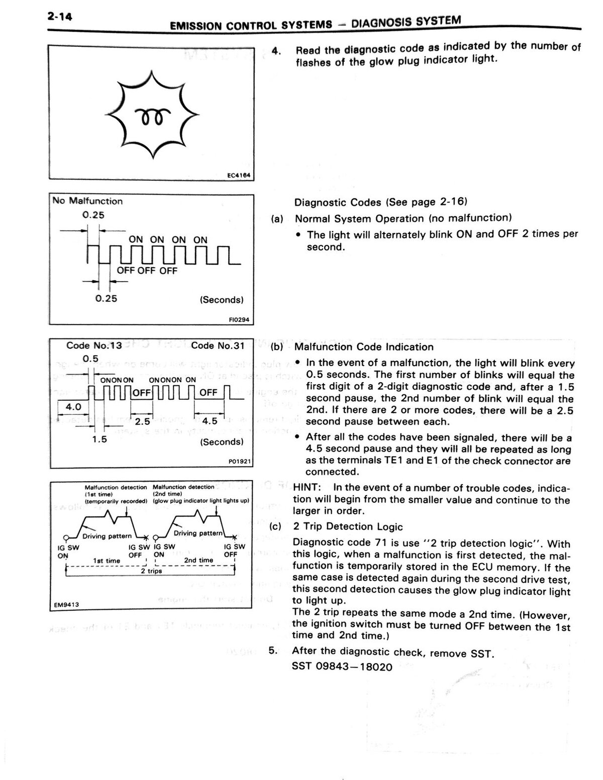

I didn't know the glow light could do flash codes or would indicate a fault....

Putting this down to a hot engine, without the exhaust manifold heat shield fitted, warming up the vacuum sensors / lines immediately above it, to the point they started to read funny. This code indicates an issue with a system that may no longer have any impact on my particular vehicle, so if the light comes on in future without performance impact then it can be investigated at leisure.
