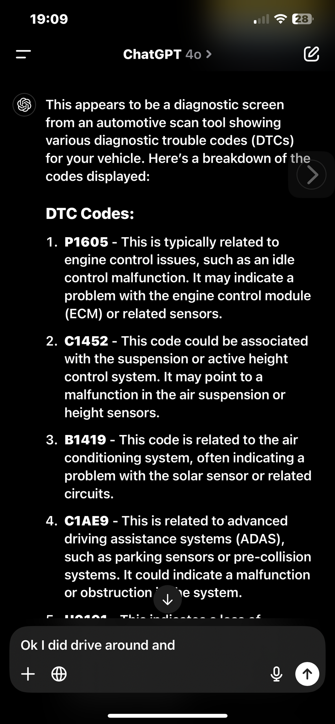

This new system worked so well. It did 33 ECU checks within a minute. I repeated the test few times and it worked every time. I then got some codes. I cleared them and refreshed health check. Exited to see that most of the codes disappeared and didn’t come back.
The one code remaining is from rear AC sensor. It was there for long time. I asked some mechanics to look into it in the past but it was not fixed. A task for the future
I also tested ChatGPT. I uploaded image with codes and it explained all of them. For U0101, it suggested to drive, change through all gears, delete codes and re run the test. It worked
