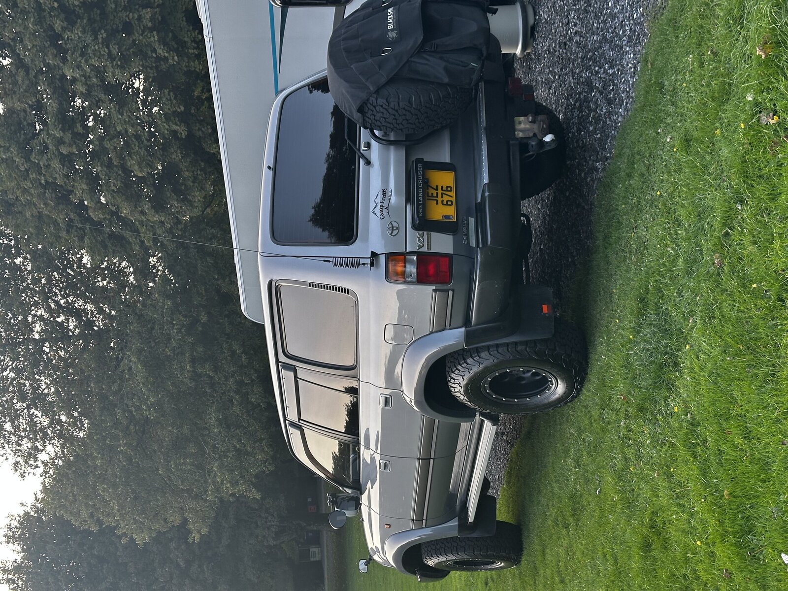

Hi all ,
Ive been sorting out an 80 series over the last few months with great help from old posts on here.
It’s all good now but needs more power to tow my caravan. Ive uprated the trans cooler but am now look at an intercooler, fuel pin and a mechanical injection tune.

Nice 80 Jez, whereabouts in Devon are you?
So did you used to live outside uk?
Intercooler can be bought from Alisport, that's where mine came from.
Pump can be tweaked by Diesel Bob to good effect.
Turbo is the one most people seem to go with G Turbos offerings, from Australia.
Lovely looking 80 you have there!
