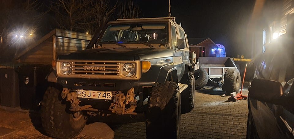

Hi all, thought I might as well introduce myself since I bumped into this forum by random chance last night.
I'm Sam and I'm (as the tittle states), from Iceland.

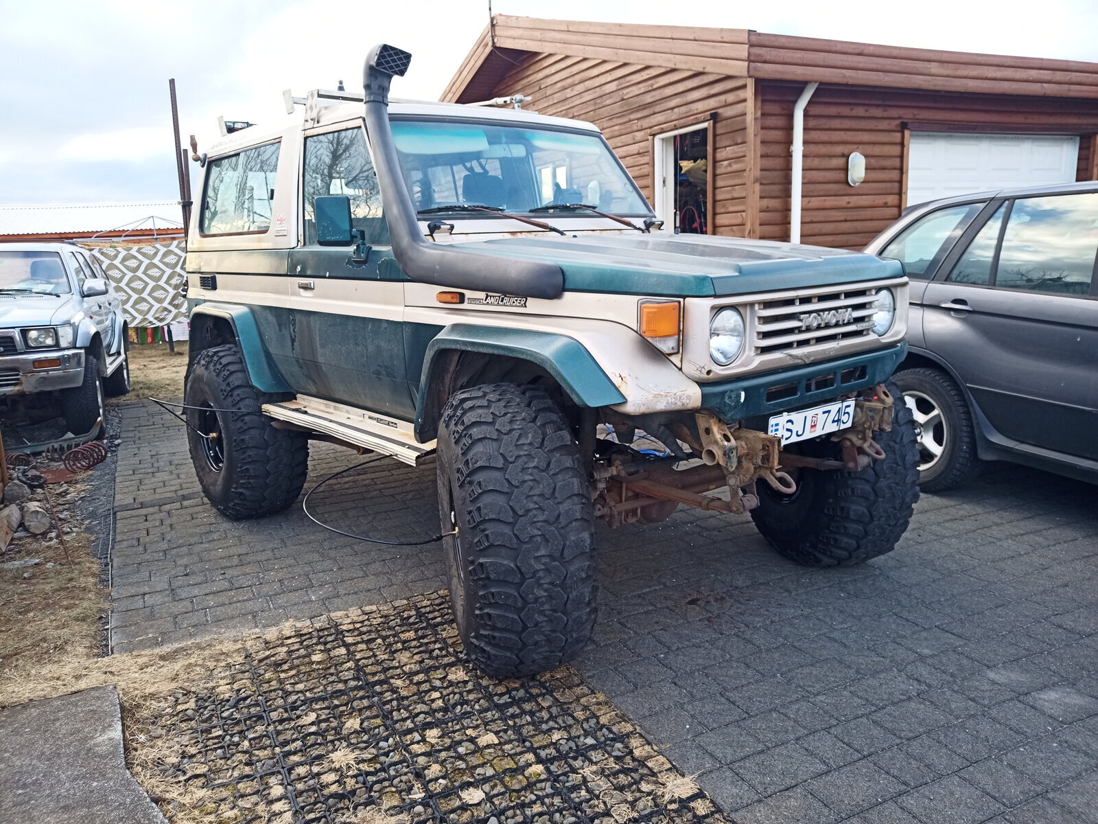

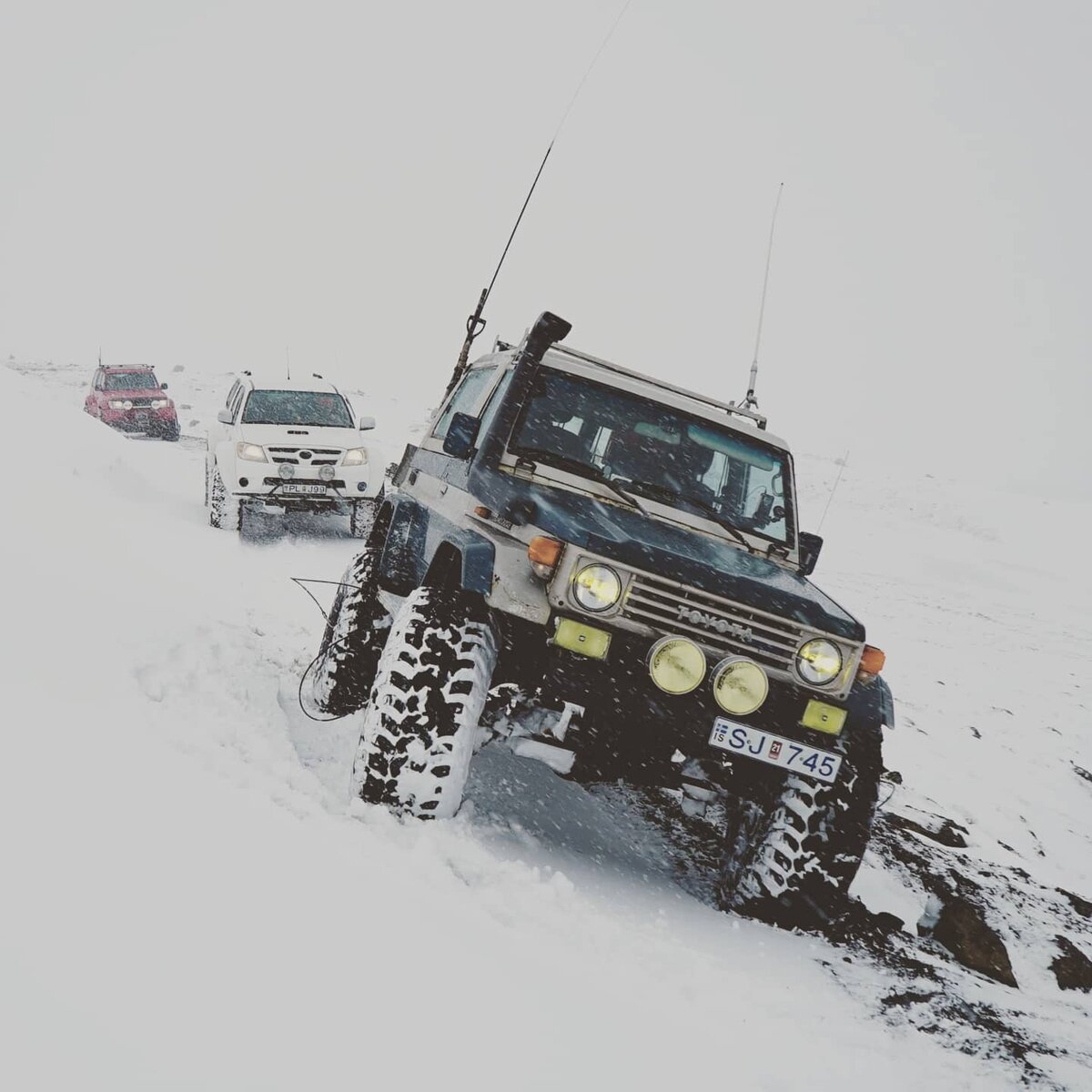

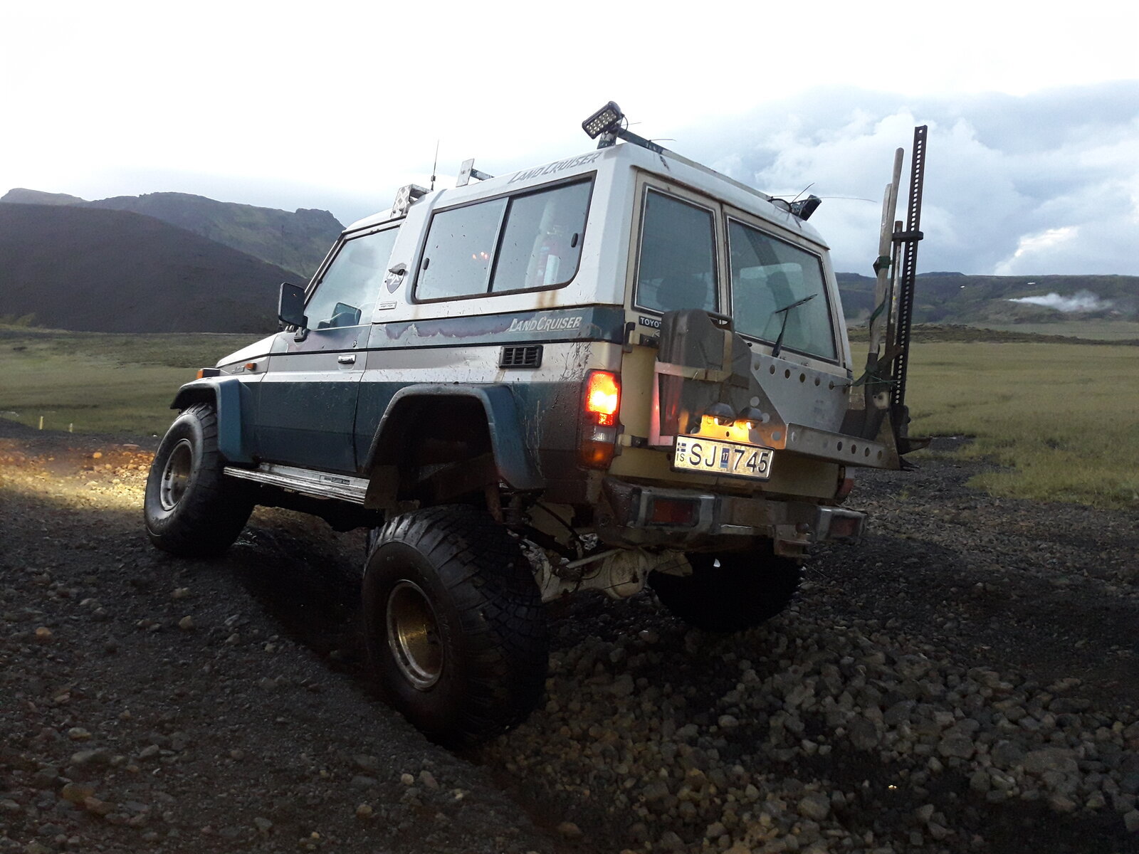

I own a HZJ73, 1990, driven somewhere north of 300,000km.
Minor mods include: 38" tires, LR coils rear, extra radios, IPF lights in front, working lights rear, 1:4.56 differentials, HF radio, VHF Radio. On board air pump.
Future mods: coils in front, 42" tires, crawler gear, replace e-lockers with pneumatic control system (keep the lockers though), automatic tire pressure control. system, search light on top, extra VHF, cabin heater, ARB or custom made front and rear bumpers, winch and probably more ridiculous things.
Edit: Some work I've done on the truck since I bought it 4 years ago:

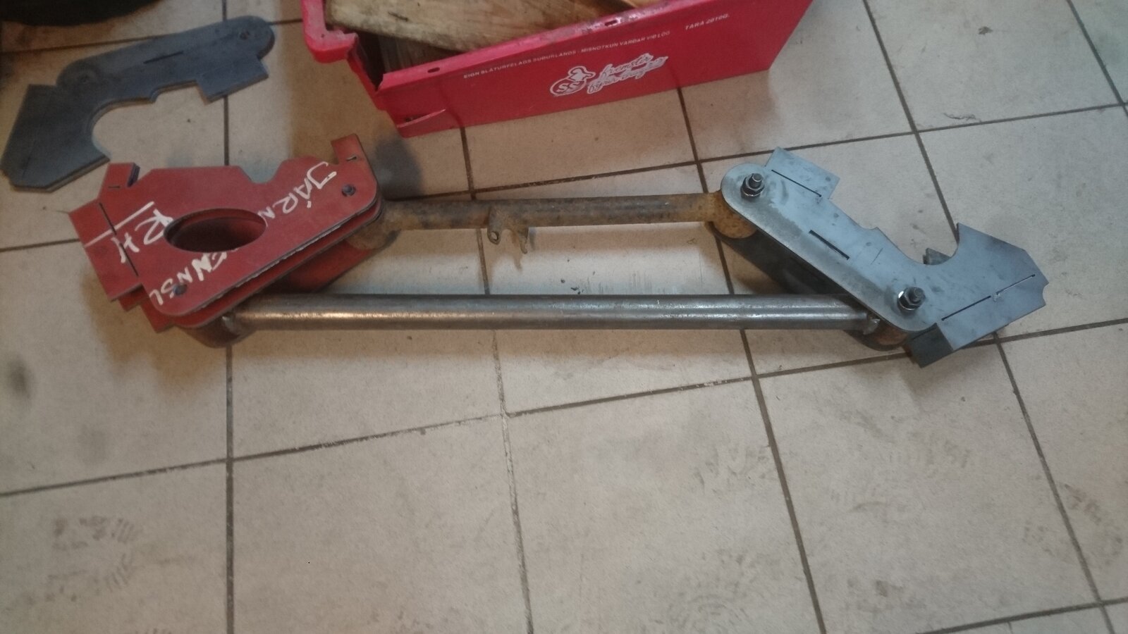

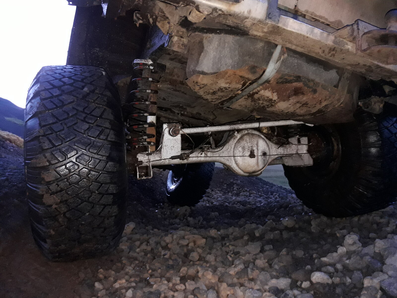

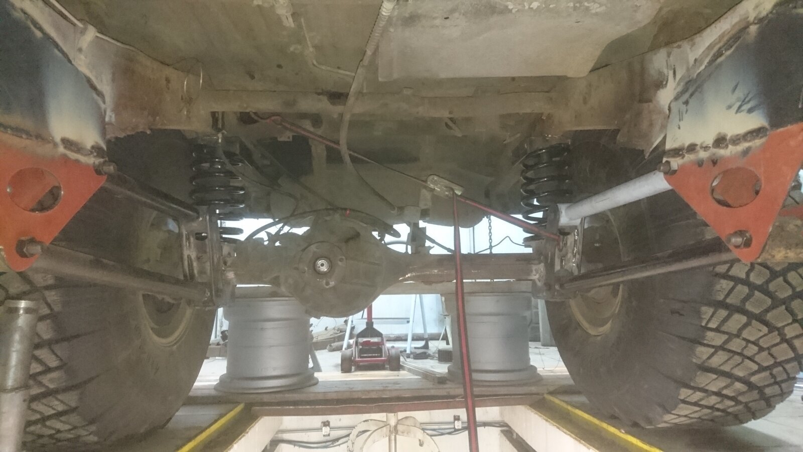

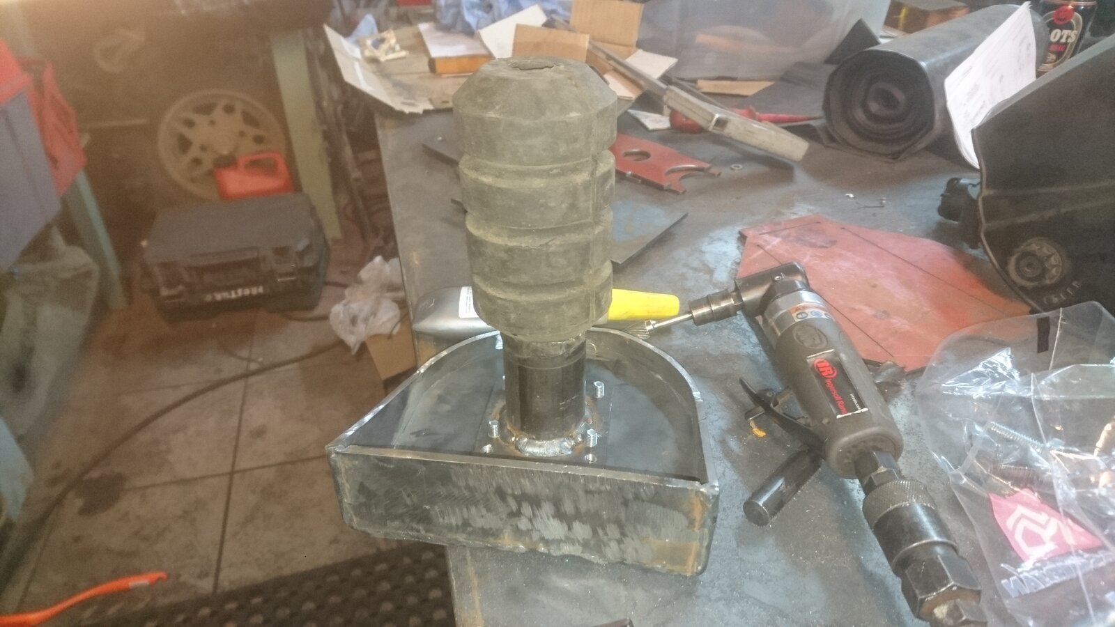

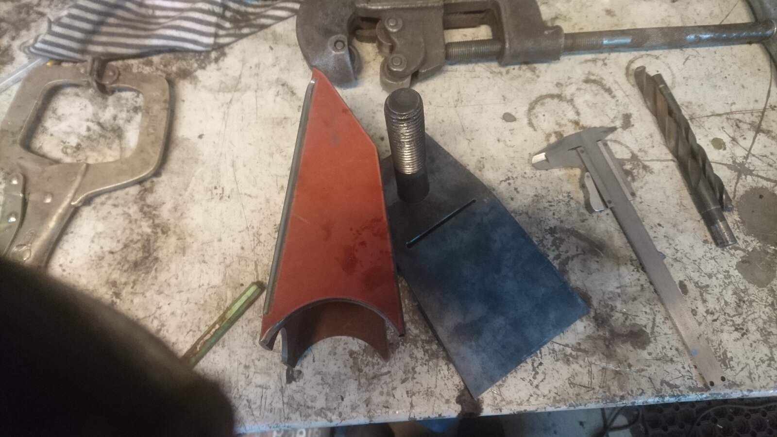

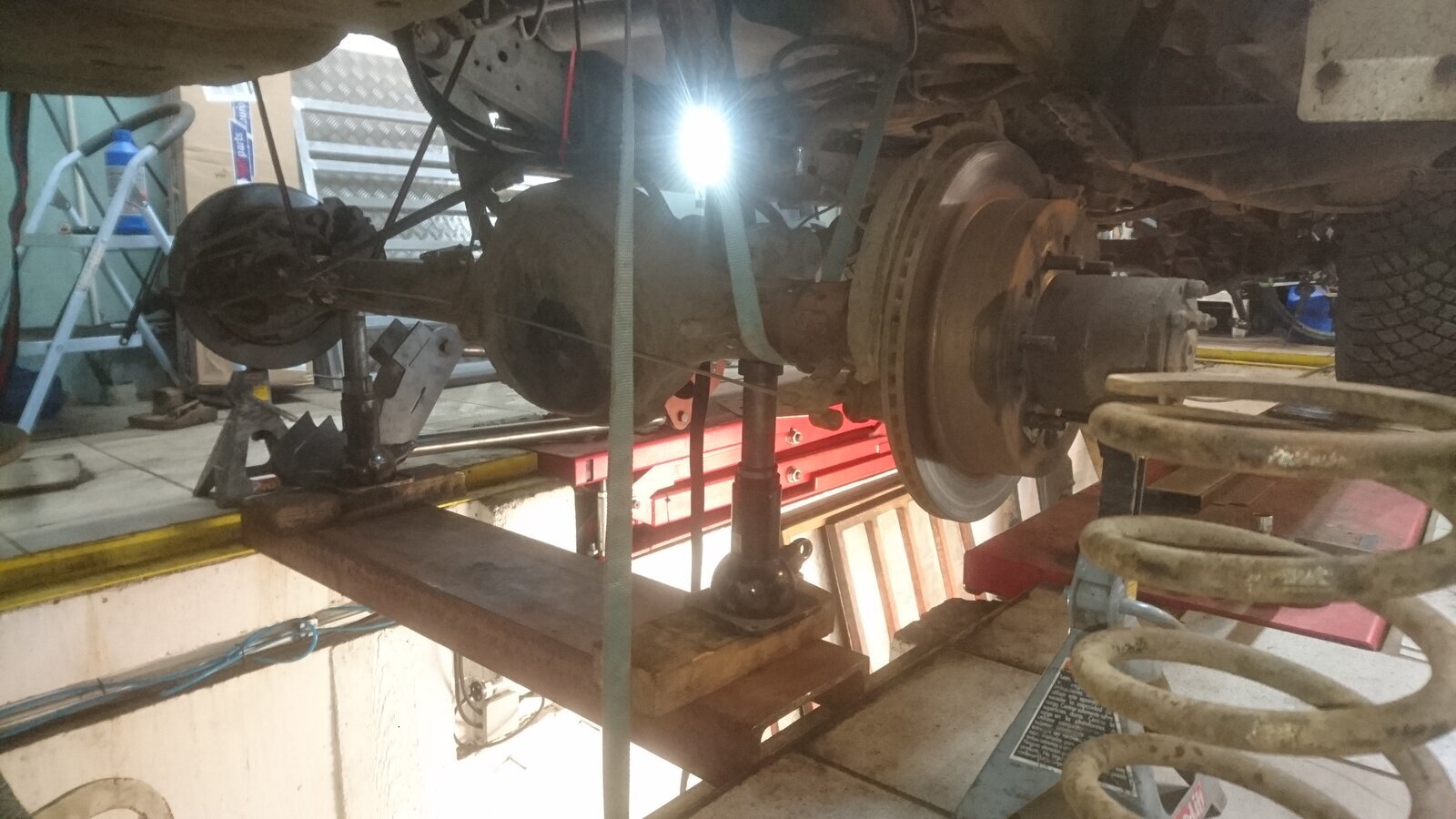

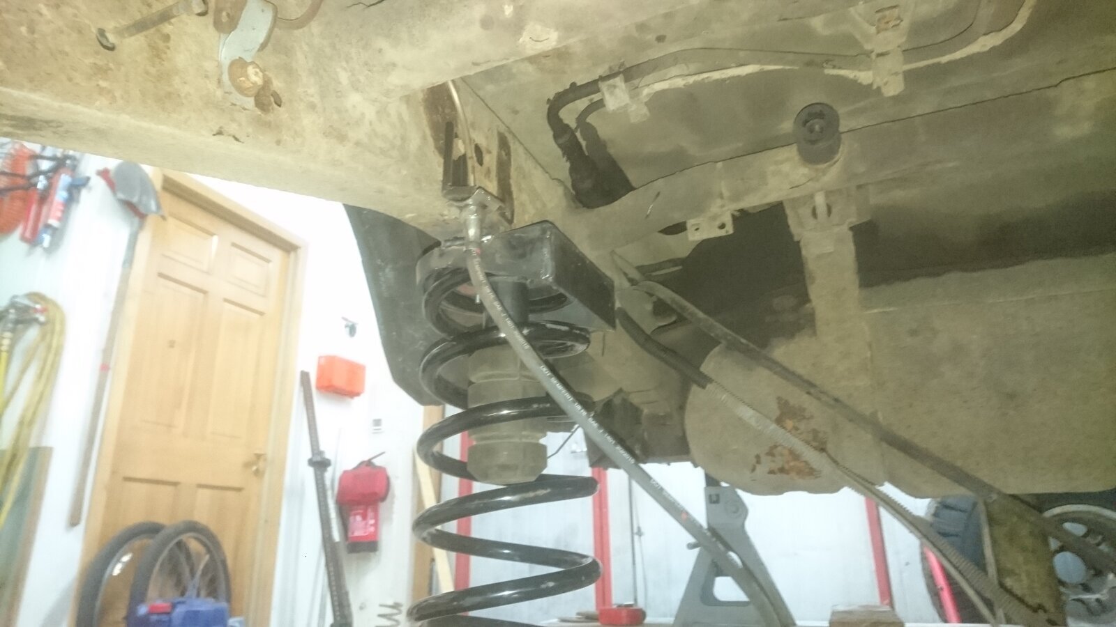

Rebuilt front and rear axles with new differentials (1:4.56 instead of 1:4.1). Land Rover coils in the rear instead of leaf sprung suspension. New "roof rack" for antennas and search light (coming soon). Some extra interior lights (red for night vision and white for normal use). Rebuilt the gearbox last summer. Replaced sills and floor on the left side (right side is TBD next summer) along with repainting those parts.

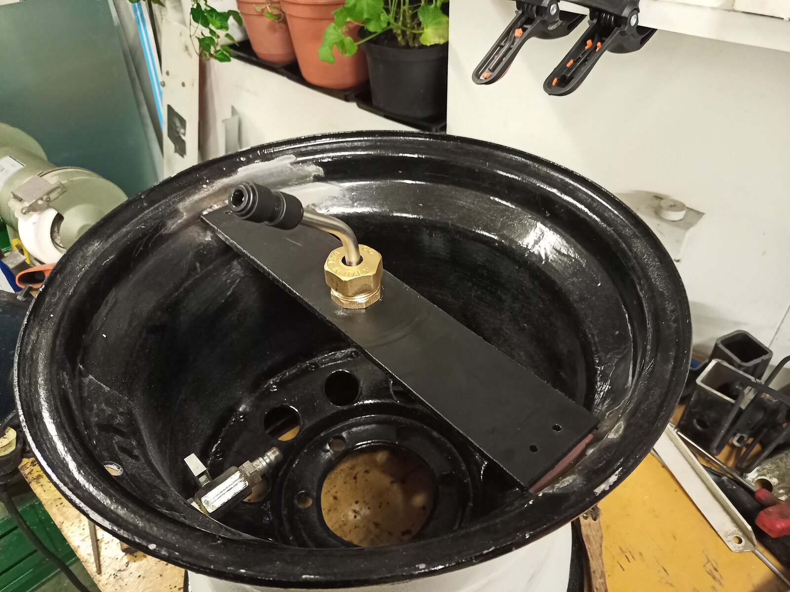

Currently working on: Automatic tire control system with on board York AC compressor for air, and LC90 Prado seats.
