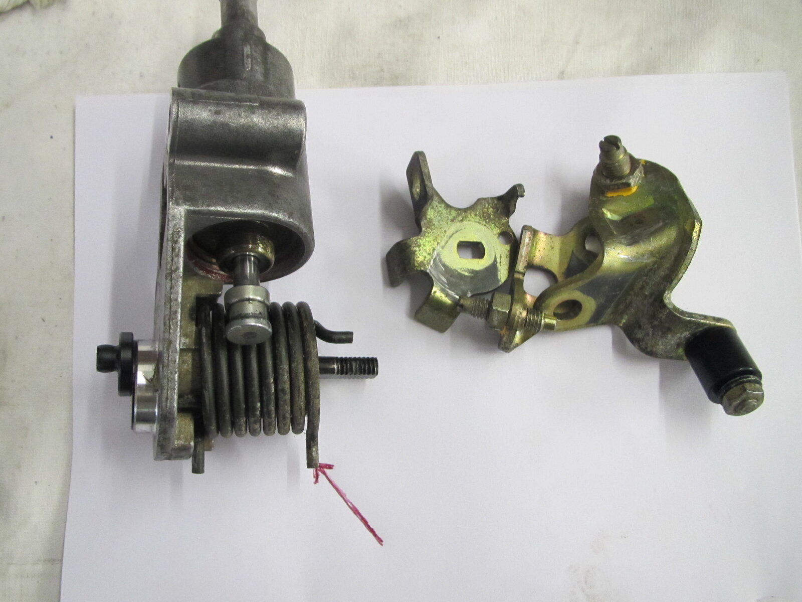

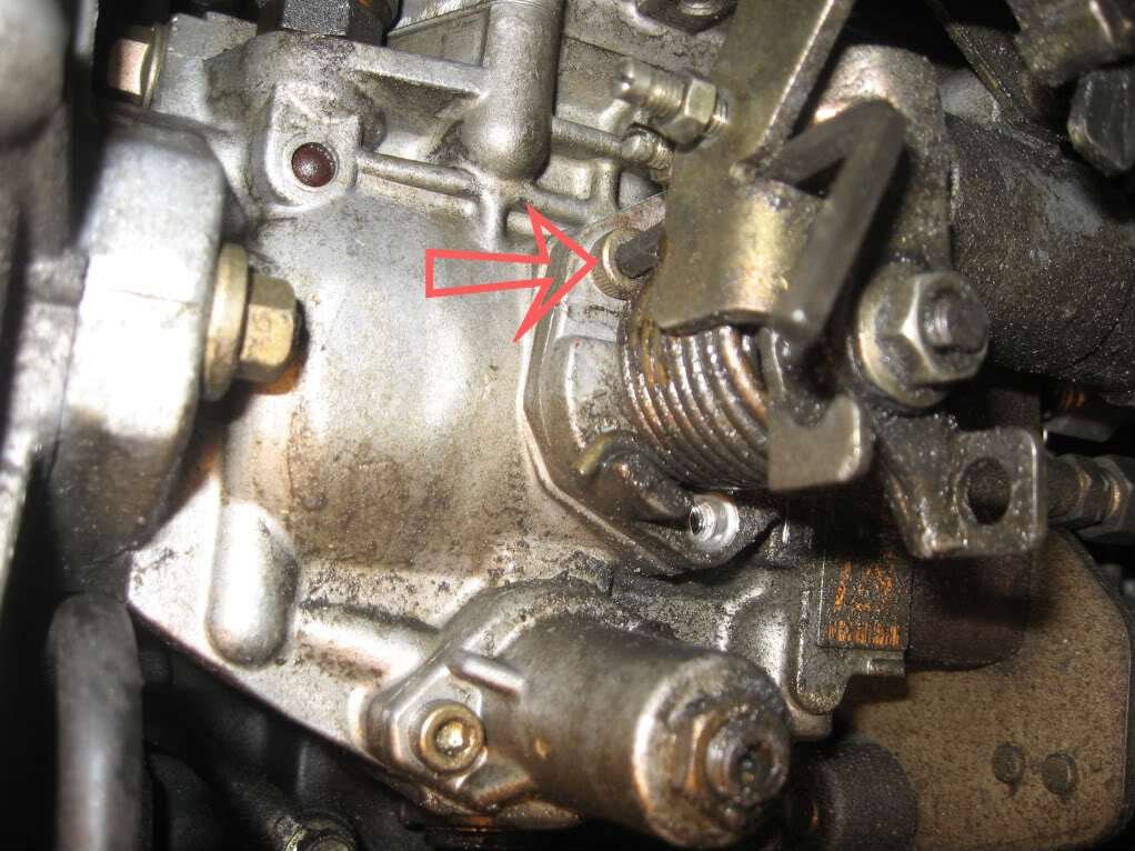

I am reassembling my ACSD but cannot work which part of which lever the outer spring prong locates with. I wonder if someone could kindly take a picture of the outer spring and it's end for me (red arrow). I knew I should have taken a picture. Toydiy and FWSM are no help.
There are 3 levers shown in my picture. I think it goes on the left hand one between those 2 right angled tabs just in case someone is wondering where to look. Some witness marks are there but not 100% convincing.
